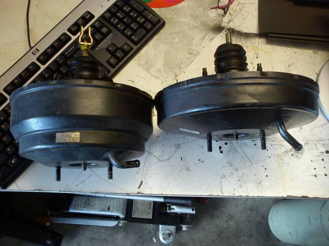

Swapping standard brake booster with bigger abs version. Be interested to feel the difference..

Bennoz wrote:Swapping standard brake booster with bigger abs version. Be interested to feel the difference..
Yes this will be very interesting. I've been considering getting one modified. Let me know how it goes.

Just been for a test drive, much better feel to the pedal, much more responsive for less effort. Will give a full report once I've driven it to & from work for a few days.

Did you have to disconnect any of the brake lines to do it?
How long did it take to swap em over?
I'm wondering if this might be doable trackside during a break at a WP track day.
Re: Bennoz 6A13 Conversion
Shane001 wrote:Did you have to disconnect any of the brake lines to do it?
C*nt of a job.
Wouldn't want to do it trackside.
Had to disconnect both lines from the master to do it & bleed all 4 corners.

interesting the difference in size really.
I would have thought the difference for abs would have come down to the abs actuator pump (*secondary pump)

But you reckon there was an immediate improvement in pedal feel?
Harder pedal with less travel?
Do you feel you need to apply more pedal force for the same breaking force?
Do you have the 1" master cylinder already?
Yeah pedal feel is much better. Same amount of travel, less effort required. Yes, already have the 1" bore MC.
