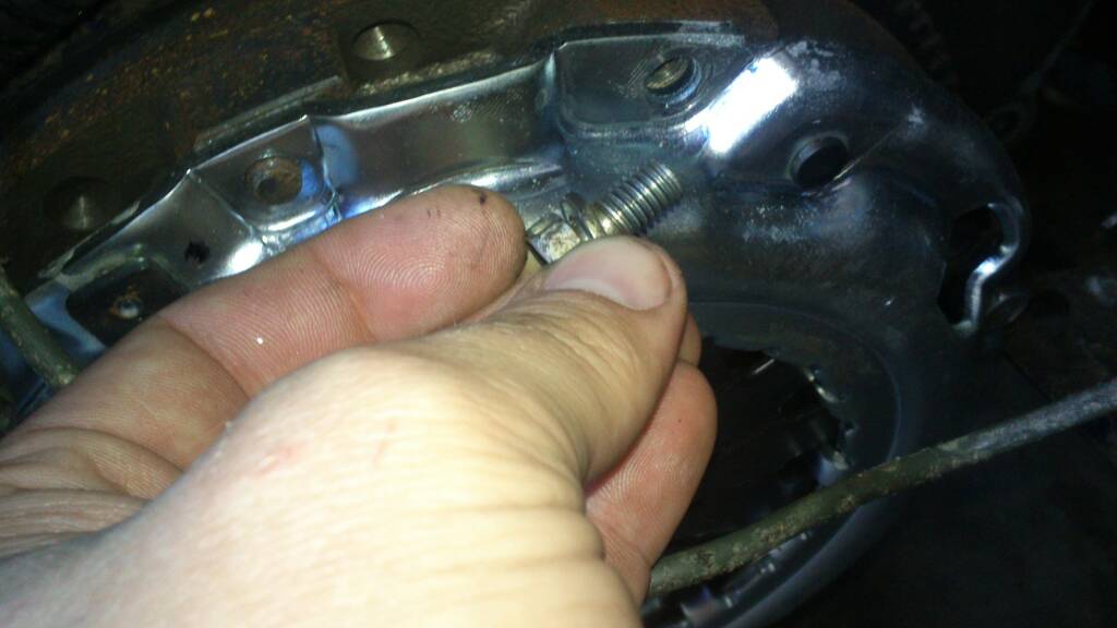

Ok, the reason they snapped is I have the wrong bolts. They are too short..
I need to know the size or a picture or something, because I now have absolutely no idea what are the right bolts, and cannot continue untill i do..If anyone can find this out for , I will happily pay them a decent some of money for their troubles... Seriously... Please.
They look right to me :?
Bennoz wrote:They look right to me :?
Do u remember if they had washers on them like the ones I'm using?
They have to be too short.. When they snap, I can spin them straight back out by hand.
When the clutch is off I'm able to screw the whole nut bolt down. So when the the clutch is on, there's no way it's getting as far
Find out for me lol and name your price
Yep, they identical to every other clutch bolt I've done. They will only go in a few threads to start with when the pressure plate is on, but they pull it in 5-6mm against the spring.

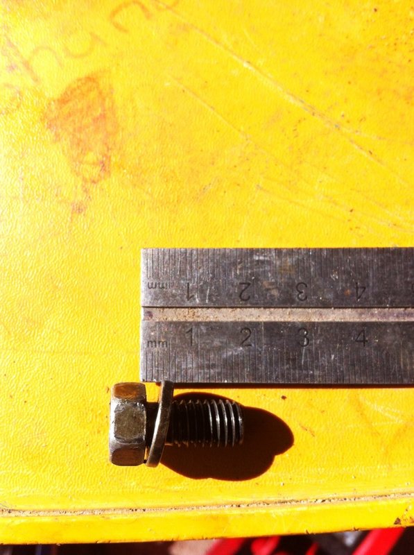

They look like an 8mm x 15mm metric standard to me..
If I get time this arvo, I'll throw the thread gauge on it to confirm.

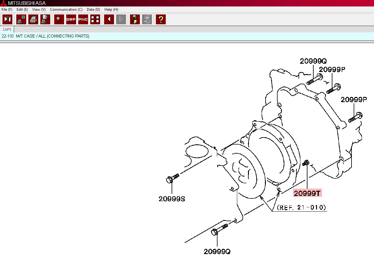

Clutch pressure plate retaining bolt with captive washer - MF241251
BOLT,T/M CONNECTING WASHER ASSEMBLED, M8X16
http://www.camskill.co.uk/m3b0s12p96449 ... ssion_FTOs
My price is $1000 :cheeky:
Well f**k! Now I'm back to- why are the bolts snapping :( ffs. Well ill honestly chuck you both $20 each haha it's the part number I needed soo.

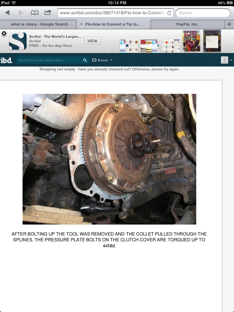

I set the torque wrench to 44nm I don't no what else I can possibly do :lol:

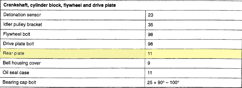

Where did you get your 44Nm specs from?
I have been looking through all my manuals and all I could find was this...
Clutch Pressure Plate Specs.jpg (117.53 KiB) Viewed 1262 times
Man I hope you're right
