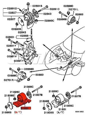

Re: DIY: Changing lower engine mounts
PHIL069 wrote: Vectose....Could you please post up the part numbers for all 4, so I can order them from Amamamamamamamamamaayaaa.....and would the bottom 2 come already in their mounts? Thanks :D
OK, I done some looking...
Up to 1997 FTO Manual + all come in their mounts
MR197540 Front Engine mount for FTO V6
MB949166 or MB691237 Rear Engine mount for FTO V6
MR197614 Upper gearbox mount LH
Can't find RH side Upper engine mount and haven't look @ Amamamamamamamamamaayaaa yet
EDIT: Did grab this pic...
Engine mounts.jpg (34.81 KiB) Viewed 2993 times

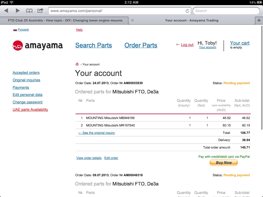

Amayama wants $38 for postage, so $145 total just for the bottom two :? Seem reasonable enough or can we do better?
vanadinite
Posts: 809
Post by vanadinite »
I can get em local for 126 but with postage to you bits probably end up the same. Only quicker

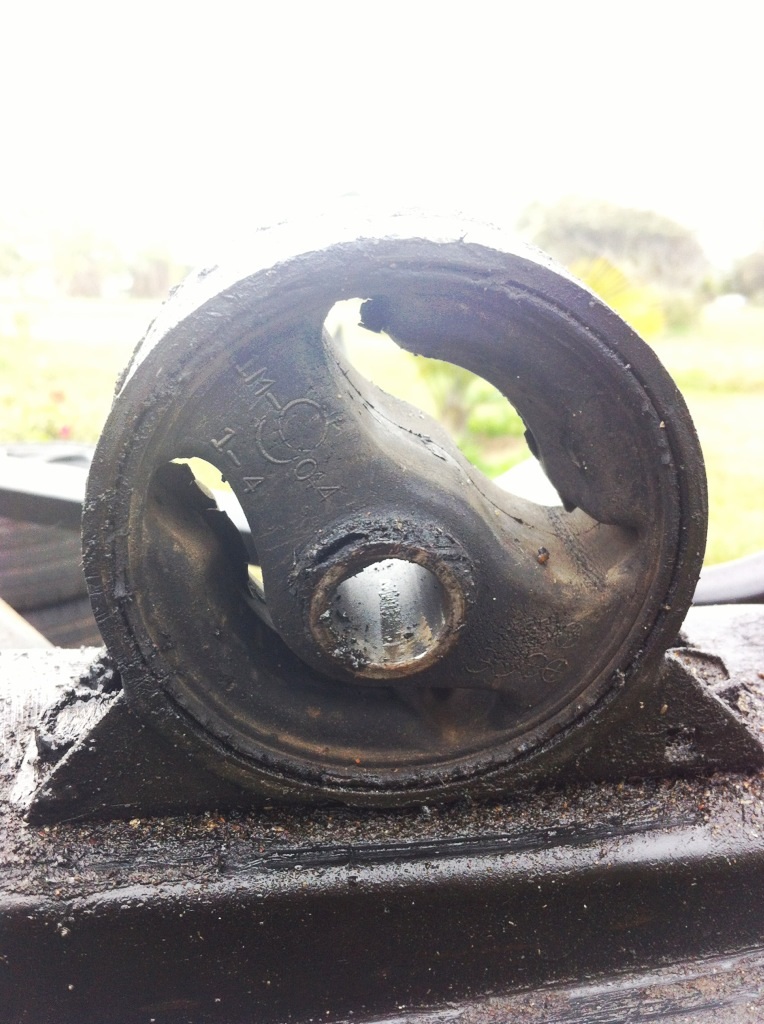

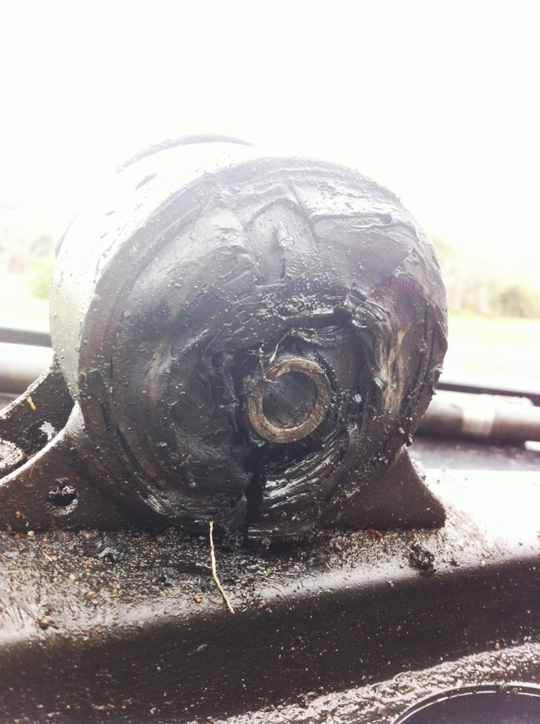

Removed mine today.. Why is the back one so much more ruined then the front :/
Coz you drive like a cock? :-P
Bennoz wrote:Coz you drive like a cock? :-P
Then y aren't both of them fucked :lol:
