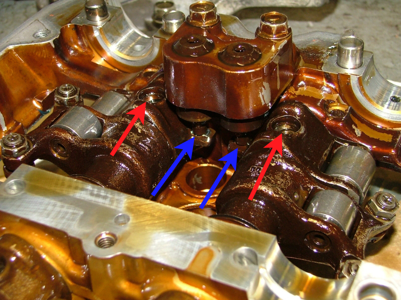

Trying to do a bit of home work......
Red arrows = ???, will engage MIVEC lobes when you hit MIVEC?
Blue arrows = Rocker arm spring (hydraulic tappets), hold the MIVEC lobes in place when not in use?
Which would mean place rocker arm springs into vice and squeeze out crap? But this could cause them to stay compressed?

:idea: I think I got it............Adjusting the tappets back to specs we have moved the MIVEC lobe, when the valve was compressed, further into the hydraulic tappet, compressing it further than what it has been used to. The hydraulic tappet is so grimed up it is now stuck in the compressed position and not returning and/or the oil gallery feeding the tappet is not allowing enough oil through to extend it back, causing the MIVEC lobe to slap against the hydraulic tappet causing the new noise.
@ Vectose, I think we need to strip the top of your engine again and strip down/check out more components.

Hey Bennoz in communicating with Camskill yesterday and sending them your pic, they added your pic with my arrows to there part listing.......
http://www.camskill.co.uk/products.php?show=48874
P.S. Those tappet screws are close to half the price, Camskill's site says they will price match.
I have found out that the other tappets are part of the rocker arms.
