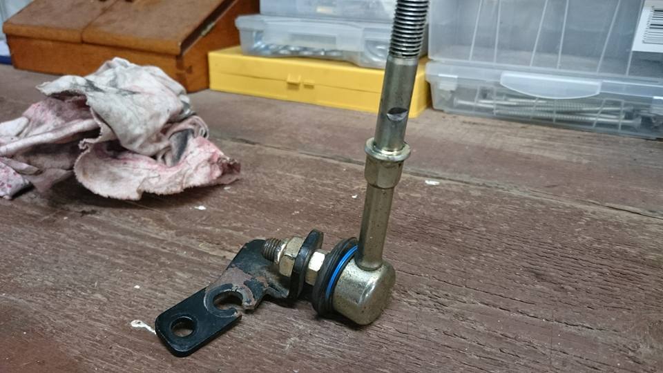

So my GR Whiteline rear swaybar / Lancer droplink / aftermarket lower control arm experiment hasn't ended well..
Re: Bennoz 6A13 Conversion
A bit of angle iron will fix that.
Why don't you just go back to the standard arms?
Obviously the brackets are cheap pieces of sh*t that break & it's only a matter of time before the arms f**king snap. I've tried convincing jaan to let me swap the standard ones back in and throw the knock offs in the bin, but he likes them cos day is blu

Just make a new bracket? My rear sway bar will probably have the same problem as we have the same set up except different sway bars (ultra racing). Quality these days are really lacking.
FTODreams wrote:Just make a new bracket? My rear sway bar will probably have the same problem as we have the same set up except different sway bars (ultra racing). Quality these days are really lacking.
It's not the sway bar, it's the aftermarket control arms or trailing arms(can't remember which is which) standard arms have the bracket built in.
Also I think that is his second or third bracket. I went through a couple (stronger each time)
First one I've broken. Won't break now. 5mm angle iron.
Oh. Must of been Matt that broke me aswell.
I still don't trust the arms

Yeah it's the trailing arm I think? Yeah I know that it's just the force that the sway bar exerts on the bracket is what wrecks it, was what I was trying to say. I don't exactly trust it either and half expect it to be made of something sh*t not billet 6061 or whatever it was. I chose them cause I couldn't be arsed with sourcing the bushes that go into the original trailing arm. Think the cost of them both equated to more than the new arms so just went for it.
Seems the president was one step ahead of me. Maybe weld in two bits of iron on each side of it so it's more like a triangle and that way doesn't bend. Although not sure if that would even Bend as most of the forces going to that bracket are just going up and marginally down.
