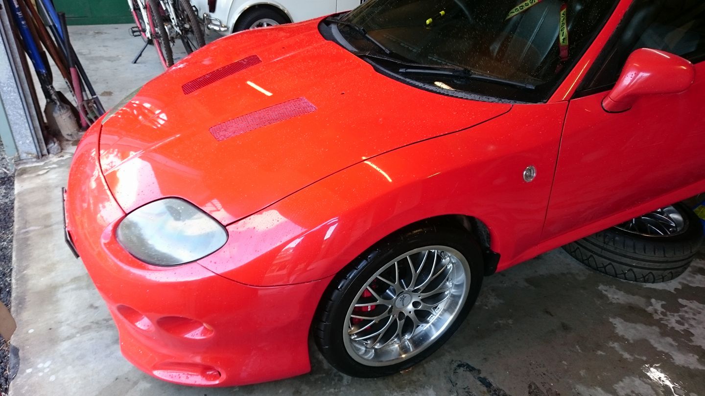

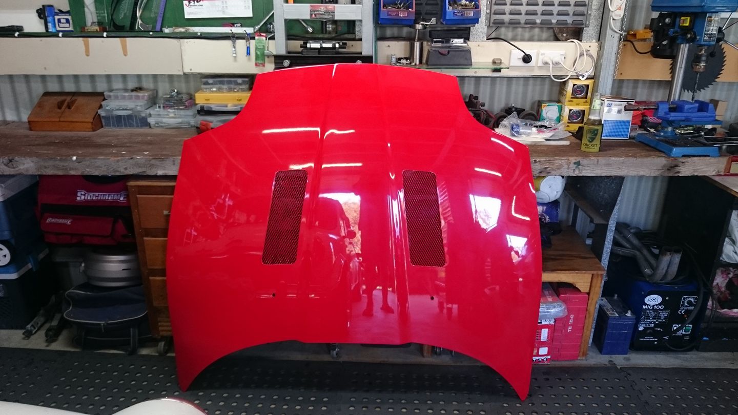

Finally painted & fitted that bonnet I made :cheers: Whole car is getting a respray next.

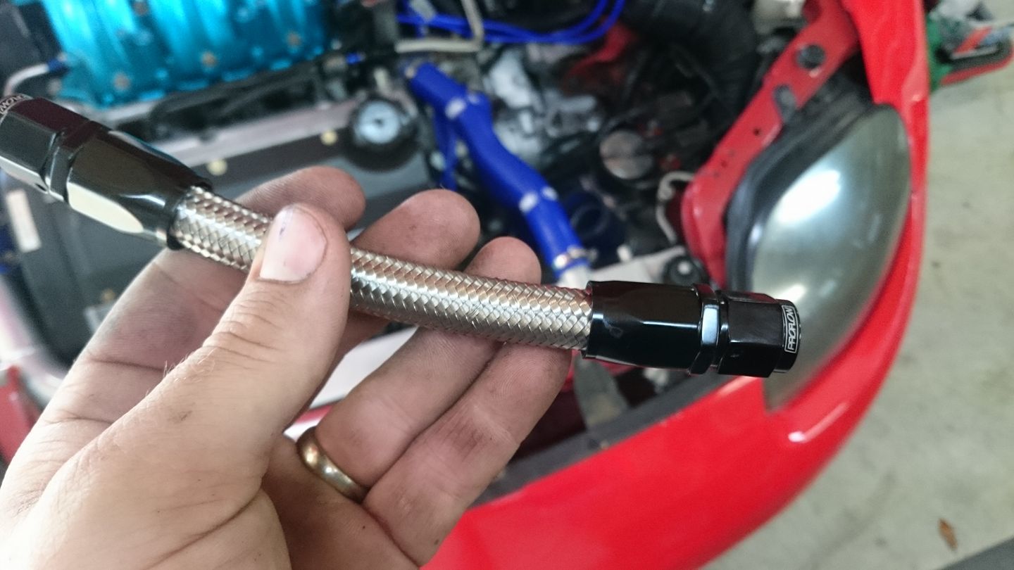

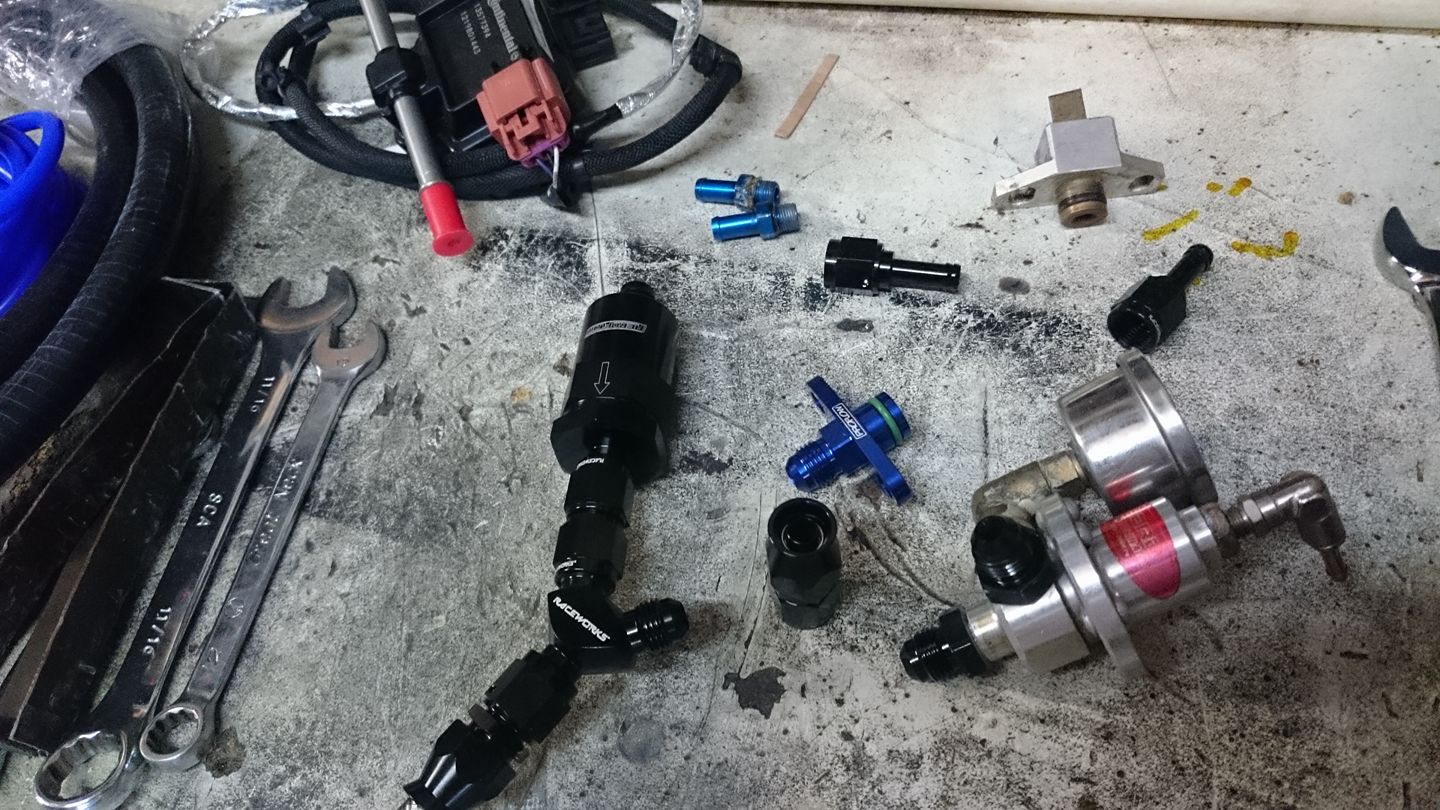

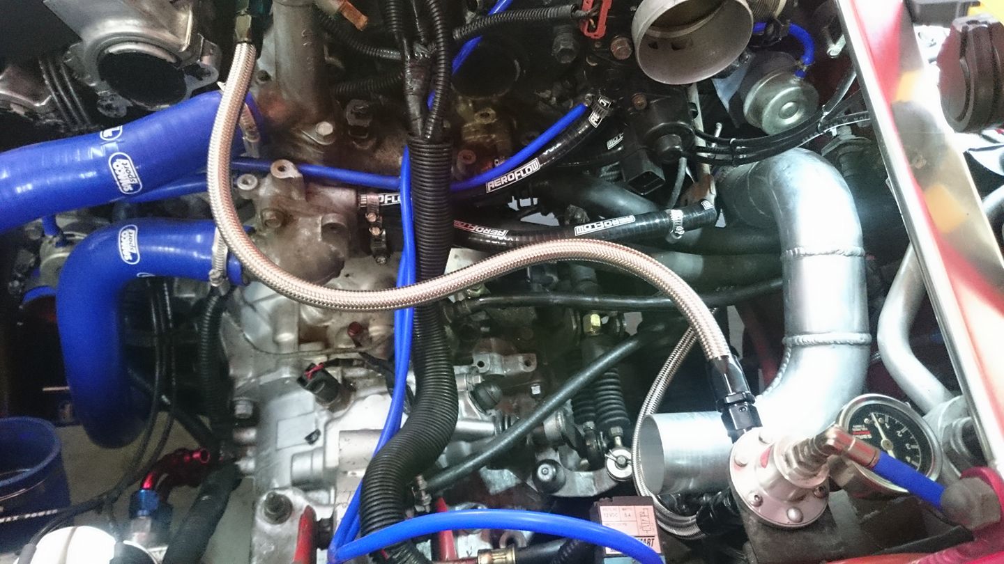

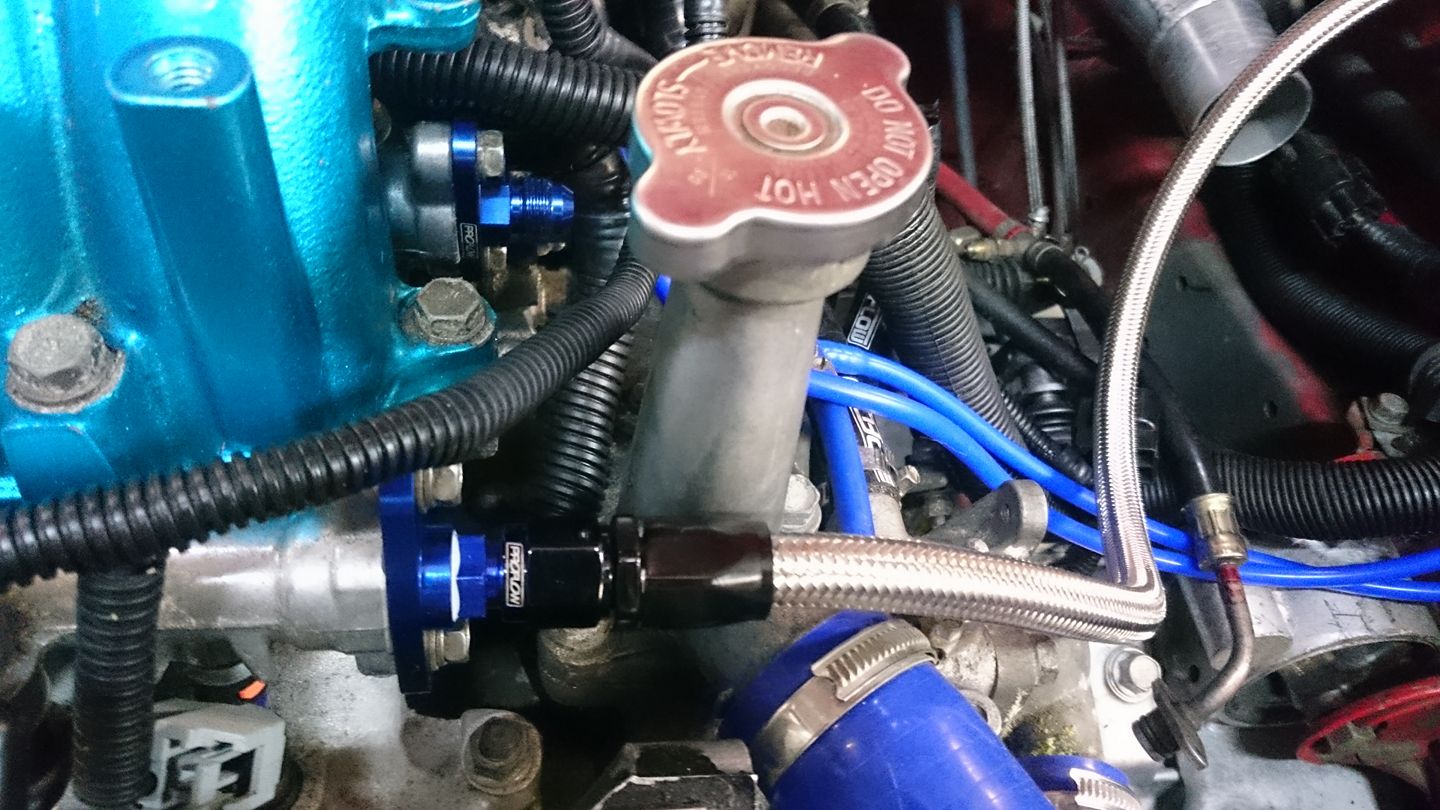

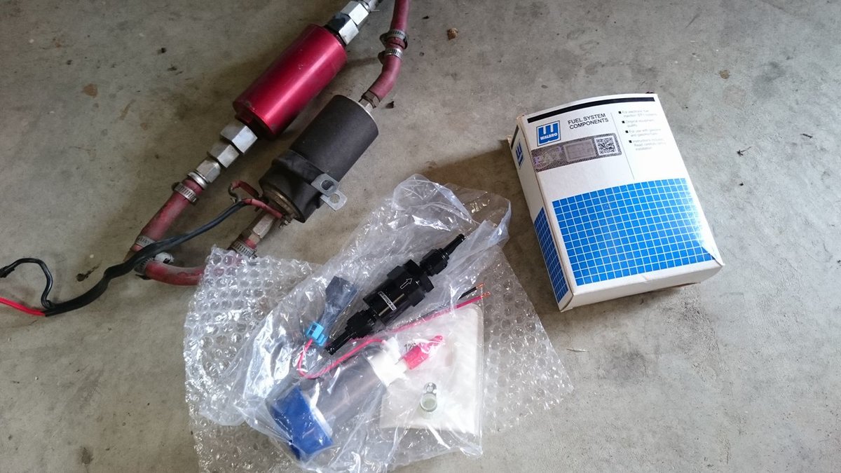

Rebuilt the fuel system once again. Removed dodgy dual fuel pump setup & replaced with big single Walbro (457L/hr E85 compatible.)
Removed all rubber fuel & water piping, replaced with new rubber & braided rubber on fuel lines. Replaced most of the vac & crank case pressure lines as well. New inline 6AN fuel filter as well.

She still looks dam sweet :twisted: .
The bonnet came out looking great as well.

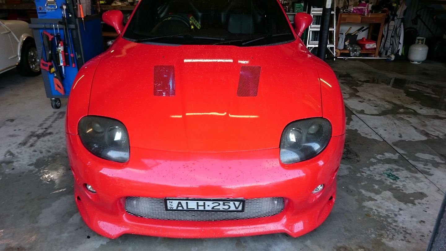

Hi :hb:
PXL_20210823_055311969 (Custom).jpg (351.25 KiB) Viewed 14866 times
