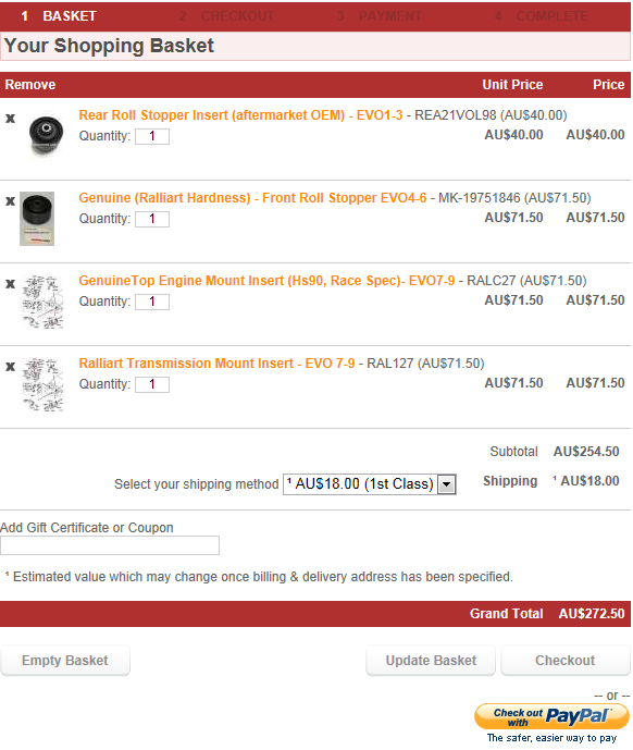

Just had a look at Meek for prices...
Meek Quote.jpg (253.58 KiB) Viewed 3240 times
Please confirm I have the right products...

I would be happy for a group buy on these if we have interest or someone closer to Seven Hills NSW could organise it ;)
Re: DIY: Changing lower engine mounts
Only problem is the rear mount is the factory hardness while all the others are harder.
Yes, that is correct.
I just spoke with meek and the rear lower mount is Hardness HS60 (not HS50 as descibed) the other 3 mounts are HS90. Will this cause a problem?
If we go genuine, all mounts will be HS50 (softer)
They are willing to do a group buy discount too, for 10 or more. I would have to email them so they can work out a quote.
If we want genuine they can do a quote for them too.
Won't you chew through the softer one super fast?
