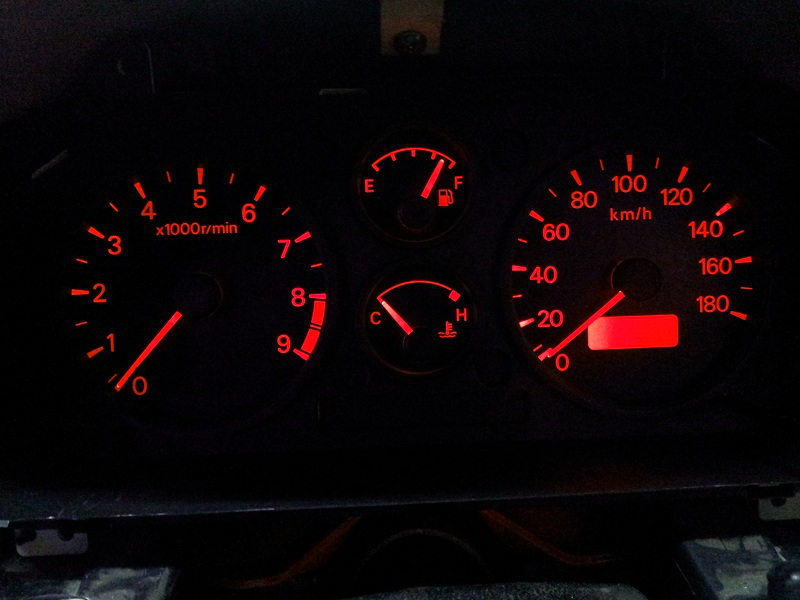

I have changed mine to red and it looks pretty good. I tried T5's at first but they weren't bright enough and had major spotting problems, swapped them out for T10's and this is the result.
Cluster LEDs.jpg (274.45 KiB) Viewed 1696 times
