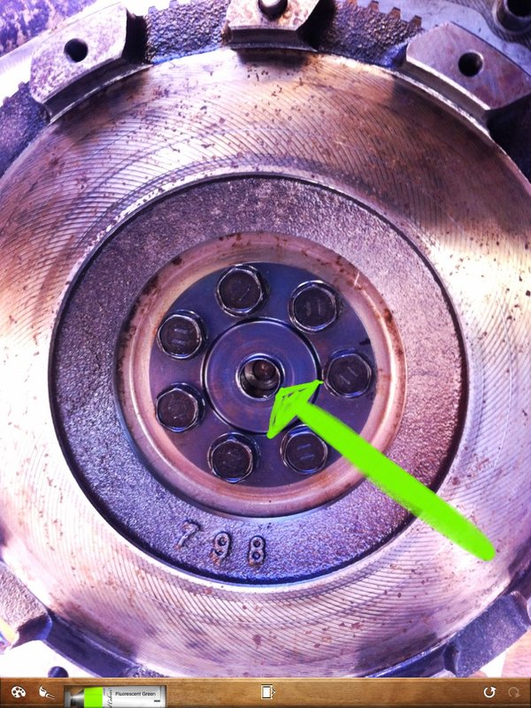

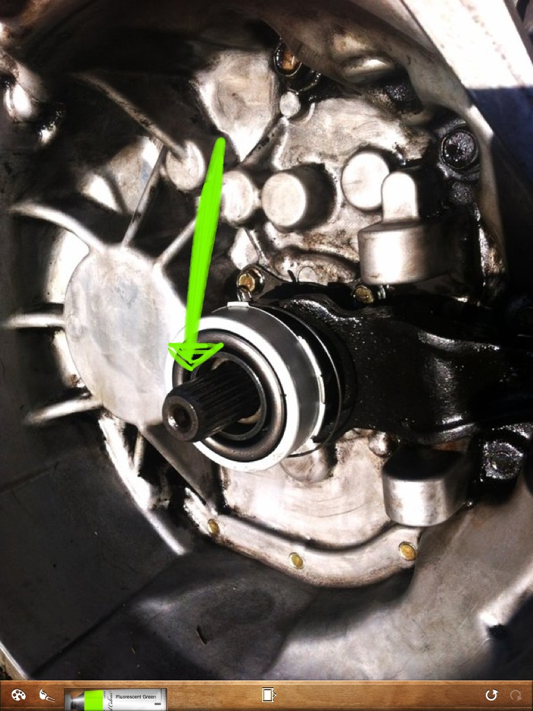

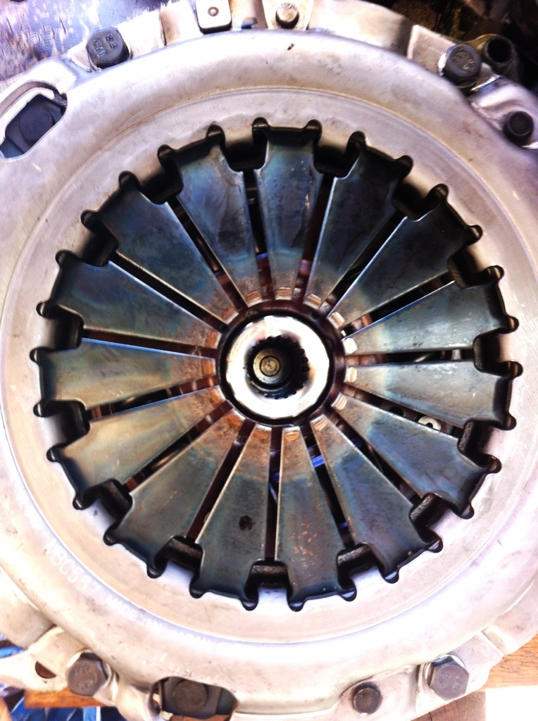

Does this look correct :lol: ? It looks to me as though there's no way the shaft in the box will go through that plate with the raised inner ring.?
If the shaft is going into the spline does that mean I have aligned the clutch? Because it is, but not all the way.
Is there anywhere I can download the manual from ?
Or if some one could just explain what it is I'm doing.. As in, align the clutch with what? The pilot bearing (i think?) behind the flywheel. Does the shaft in the gear box only go thru the clutch ? Is there another way I could align it using the box and then removing it and tightening then re fitting ?

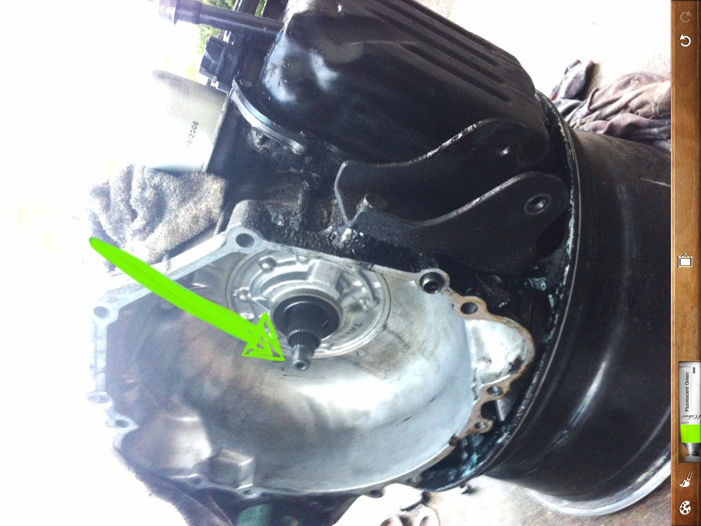

This is the size of the shaft on the auto box..
And this is the manual one...
So how is that ^^^^ going to into this vvvv :lol:
you idiot, u forgot to swap the shafts !!?! :lol:
