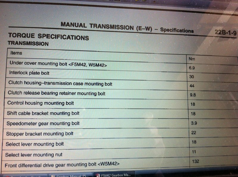

22B-1-9

Which manual is that? It's not listed in either of the manuals I have downloaded.destinationtoby wrote:22B-1-9
What does it call the item your referencing as 44Nm?

'Clutch housing-transmission case mounting bolt' is not the 'clutch cover bolt'
The 'Clutch housing-transmission case mounting bolt' is the bolt that mounts the gearbox to the f**king engine

So the clutch cover bolts, do only need to to tighten to 22nm?????

Look at the diagram on page 22B-3-2. There is only one bolt referenced in the manual at 44Nm. Which one is it
