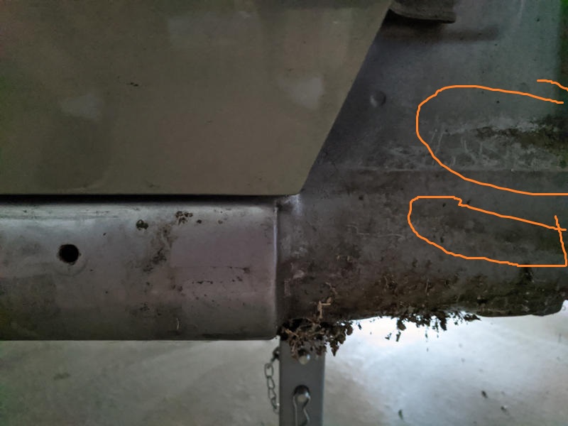

That driver's door looks a little omnious.
Does look like you have some creases along the front of the sill. I would pull the passenger side guard and check if it is similar.

getonit wrote: Wed Nov 30, 2022 6:54 pm That driver's door looks a little omnious.
Hmm. Do you mean around the middle right of the photo there? Nothing's jumped out at me, but I'll have to check again. Tried adjusting the door a bit today but do really need another person lol.
Re: BJK's 6A13TT FTO
Welp, keen eye Jim. Though I wish it was just dirt... not sure if related but also just a smidge of variation on the inner fender section.
Is this gonna be a big deal? I ran a tape measure across a few different places and nothing seems fundamentally out of whack (from a layman's perspective). I dunno if this is just a flow on from one of its other shunts, or the hammered guard seam, or being jacked up, or whatever else.

Yeah that driver's guard seam has shifted a little.
If everything is measuring up within a few mm it is fine. All the front suspension square?
Lawso's passenger side was out about 10mm. Took ages to find it but ended up being the control arm.
