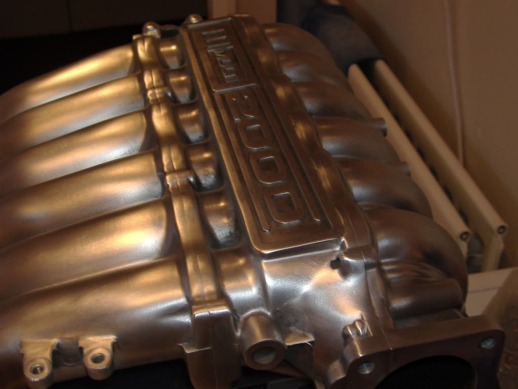

im from the UK ftooc, and have polished my own manifold see pic below, before you start be prepared for a lot of hard work as it can be a pig of a job made easier if you buy this
EBAY LINKY which is what i used.

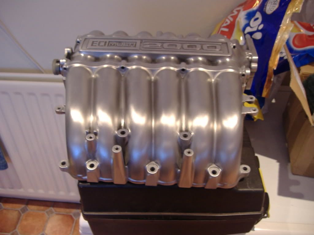

start with 800grit wet and dry and work your way throug to 1200grit (remember the more effort you put in at this stage the better the results will be. i used grinding stone to remove cast marks on edges and stuff. once your happy that the surface is nice and smooth its now time to use above kit from ebay either with drill of better with bench grinder as it makes it a lot easier i would suggest splitting your manifold into its 3 parts to make things easier and allows you the opportunity to give it a good cleaning and remove all the oil and gunk inside :D the kit above comes with full instructions start with coarse polishing soap and wheel and work through them till you use the final polishing soap and soft wheel liberally polish with belgom ally (polish) or similar and i got the below results i replaced all the OE bolts with Purple Alu ones as it looks loads better
this was just after finishing sanding process
This was after using polishing mops and alu polish

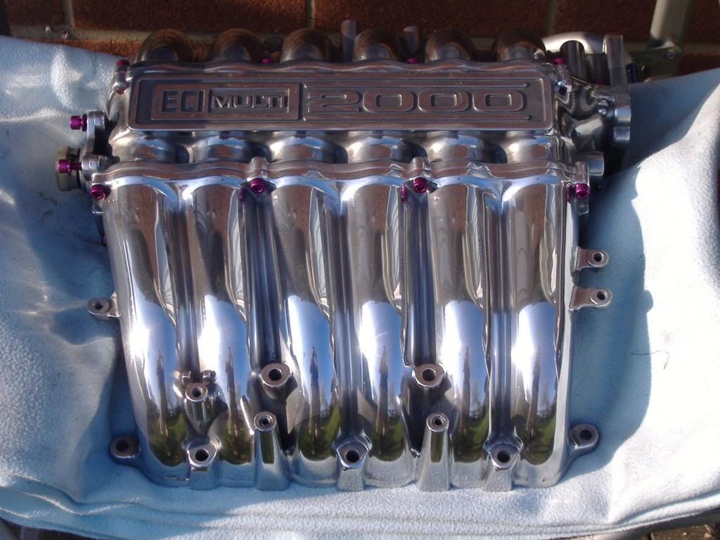

You did a Very good job!, although you did it harder way, I polish car parts for a living,
if you have a decent sized bench grinder you will be able to pull 240grit sand marks and cast marks from the manifold, I normally sand the whole manifold down with Velcro Disk (Approx 120grit) , sand it back with a 240grit orbital sanding pad, horse hair mop with Grey Rouge, Light hand sand with 400grit, Semi Finish Mop with Orange rouge and final Finishing mop with Green Rouge(Chrome Gold)
This is the end result
if anyone wants to know some tips, PM me and ill answer them,
