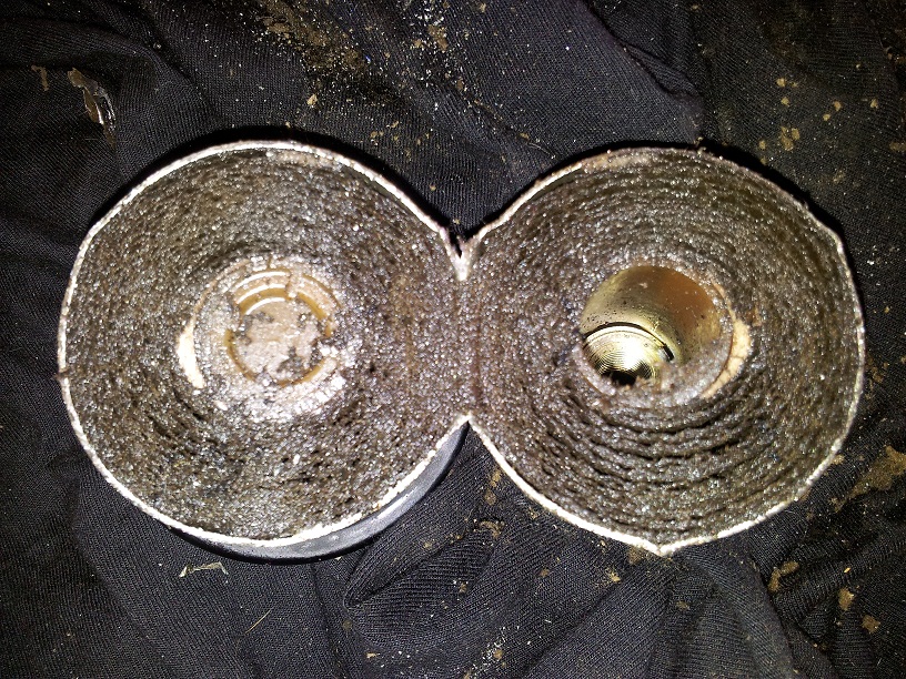

HOLY sh*t GHOLDY!!!!!!!!!!!
i wonder what mine looks like back home... could be the answer to a lot of problems

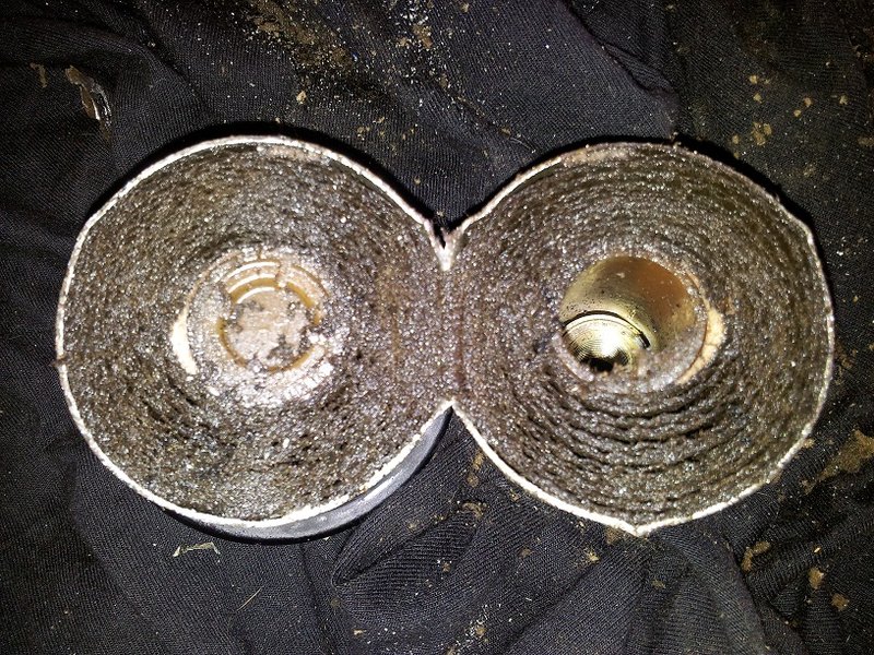

Re: Fuel Filter Wall of Shame
Here's my bad boy;
Not as bad as some here but still pretty dirty.

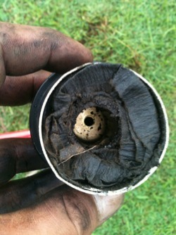

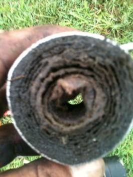

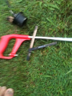

Out of the blue car. The 2nd photo the paper all fell out so I shoved it back in
Oh and I snapped my saw blade doing it lol

^^^ thats filth :)

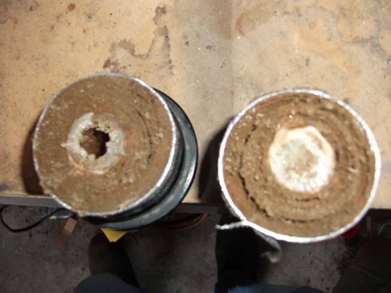

Vipfto changed mine for me the other day. First fuel filter change, my baby is growing up oh so fast.
DSCF0546 (800x600).jpg (310.64 KiB) Viewed 730 times
Did you sh*t in a coke can and cut it in half?
