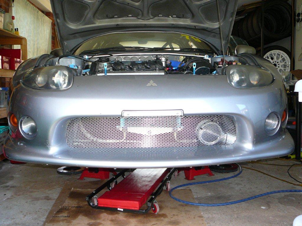

Air intake pics updated on the previous page.
Front bar is now back on and the car's on the trailer ready to take to Eastern Creek tomorrow for testing. Who's coming out for a look

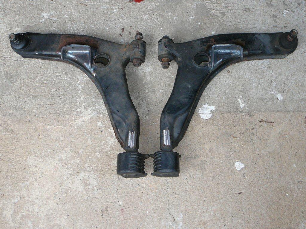

If all goes well tomorrow I'm hoping to install the upgraded front and rear anti-roll bars on the weekend along with the Megan Racing control arms and a few new poly bushes, plus some modified front control arms;

Re: Making Progress...
That looks like a great intake setup.
Could you go into a bit of detail about what you have done / what you have used, specifically what have you used for the box, what kind of filter are you using inside, how have you attached the TB piping to the box and filter, what diameter piping have you used for the TB to the pod and how have you sealed the ducting from the front of the car to the box?
I am after a new intake setup and this looks like a really good way to go.

Re: Bathurst 2012 Prep
Hi Dras, yeah I'm planning to do a few write ups after Bathurst, but if you're planning to do this yourself best to come have a look, there's only so much you can put in writing.
But to answer a couple of questions;
The ducting is the 100mm rangehood ducting from Bunnings - approx $30.
The 'air box' is from a Hyundai Sonata - around $30 from pick and payless.
The pod inside the airbox is a K&N.
Most of the mounting is by way of cable ties
I went out and bought a Sonata air box from pick and pay less yesterday. It is nice and big and I can see why you went with this box. I do have a few questions if you have a sec.
Are you using a K&N filter to suit the Sonata (E2875) or a generic filter?
Are you using the mount on the lid (filtered side) as is or did you enlarge it?
How did you seal the unused holes?
