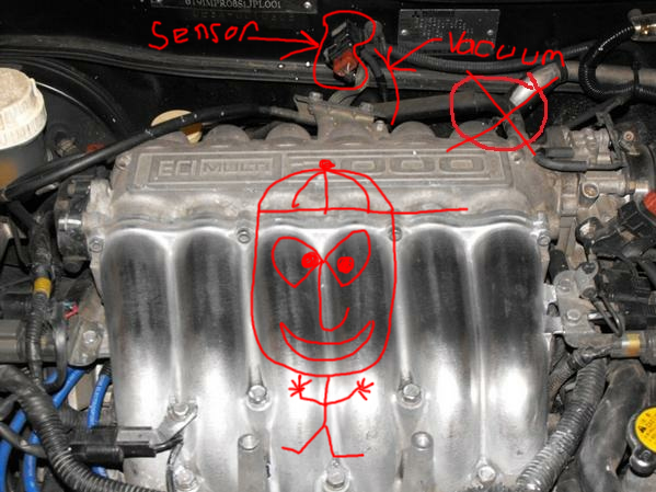

Started it today, same low revs but it stayed on, idled at about 1100 though. Theres no battery light problem now so hmm
Hey silver is this the vacuum line you're talking about?
I'll have a look at cleaning the stepper motor, because hey it cant hurt.
Also could this just be the ECU re learning? Since the mechanic would have most likely disconnected the battery?

No, that's not the vacuum line Silver was talking about.
There's a smaller vacuum line going from the sensor that's in the centre of that photo with the brown clip on the firewall to the back of the manifold (further down).
Re: Very low idle on startup, sometimes dies
This one.........
- Vacuum.jpg (194.3 KiB) Viewed 489 times
Phil I already told you not to put pictures of me on here.PHIL069 wrote:This one.........
