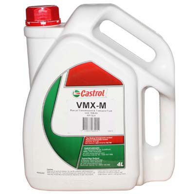

Borrowed 3 Litres of this from work today, now I can do an oil change too
Thank you work
- CASTROL VMX-M 75W-85
Wide ranging high performance multigrade manual transmission fluid specifically formulated to meet and overcome the problems of cold shift performance as well as meeting the factory fill and service requirements of Mtisubishi manual transmissions and transaxles. For manual transmissions where GL-4 SAE 75W, 75W-80 or 75W-85 are recommended. - Castrol.jpg (50.78 KiB) Viewed 1099 times

I hate how they come in 4 litre bottles thou
Re: Differences in gear boxes
2.2 litres for gearboxBennoz wrote:
I hate how they come in 4 litre bottles thouStupid 2.2 litre capacity gearboxes
0.3 litres to flush out some crap from gearbox
1.5 litres to spill on the driveway while trying to pour it into gearbox
4.0 litres
