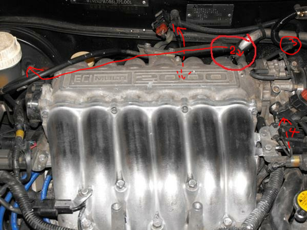

I believe there is 4 vacuum hoses to the intake/throttle body. The broken lines in the pic shows it is behind/under the part.

Re: Idling at 4k revs?
PHIL069 wrote:I believe there is 4 vacuum hoses to the intake/throttle body. The broken lines in the pic shows it is behind/under the part.
Someone buy this man a drink for me. Where hose number 2 leads back into the lefthand side of the engine bay, wasn't connected properly, that was the problem.
Running properly now, had to change the idle down from just over 1k but down to where it should be, so I think were in the clear ;)
That picture actually helped heaps, cheers

Thats the hose I was talking about last night :roll: :lol:
PHIL069 wrote::cheers:
Haha, I was looking at everything connected to the intake manifold while neglecting to look at where all those lead to haha.
So in essence i was correct THEY WERE all connected to the intake manifold :lol: :lol:
