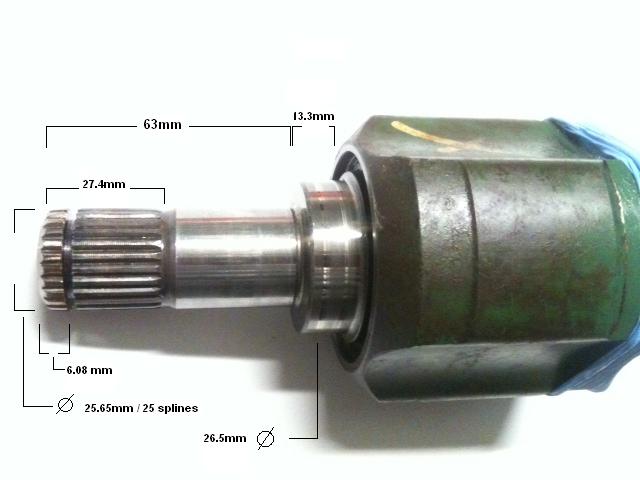

and here we go.. this is the one that does not fit or fails to go in for the last 5-10mm. hopefully someone has a shorter one available for this poor but proud FTO owner in the Netherlands
- innercv.JPG (29.78 KiB) Viewed 1124 times

OK, have had no luck with the ones I have - they are all 63mm like yours (all 7 of them). So, on to the next option. Have had a look in ASA (Mitsubishi's Parts database) and get the following list of inner Drivers side knuckles:
Now, I have reverse engineered the option codes and A90 seems to relate to LSD (A90 ,FR LSD), so I think the parts number you need is MR232224. Can someone please sanity check this for me and make sure im not missing something. I think the only option is going to be to order a new one and if we get it wrong, I cant send it back.

I think MR232223 is the standard drive shaft knuckle for tips maybe (As that is the most common, that's the one Camskill would sell).That would make MR232222 the manual drive shaft. Note that MR232224 is the only part number that is option code specific. As the LSD is an option, it must be a number that matches an option code. And A90 corresponds to LSD, so I think that must be the one. I cant see any other way of looking at it, but maybe someone else will.
Interestingly,there are only 3 part numbers listed for all FTO's. Given we know manual, 4sp tip, 5sp tip and LSD are different, which one of these is actually the same. two of these must actually be the same part, otherwise there wouldbe 4 part numbers, not 3.
Re: one inner FTO GPX cv joint will not fit
I can cross check when I get back from holidays.
What's so difficult about cutting it down to size? Would be an hours work on a lathe to cut it down & cut a new circlip groove.. Case of beer job!
