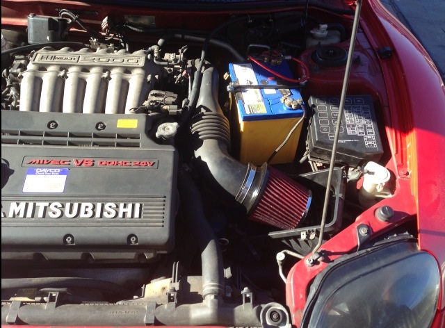

Thanks for all that info warrior, I wish I could've seen your bike! I was talking about Drag racing. There were some gorgeous ones last night. I'm a very competitive person but I realize that I probably won't win racing against Evo's, Skylines, Silvia's and Supra's. if I do race I think it would just be to have a bit of fun and get a feel for my at that I haven't been able to do.
Buuuuut I did just install my first mod (on my own too! Quite proud of myself) which is a pod filter. I used my phone to record before and after for the sound. It's quite a big difference actually sound wise, I can feel a bit of power difference too. This was just a cheap $40 filter I bought from super cheap. I am going to be ordering a K&M Typhoon cold air intake later on.
My friend who works at Supercheap suggested I put extractors on so I might to a bit
Of research into those to see what exactly they do and what not (I'm not extremely mechanically minded). He also said that if I install them, it looks like they will be hidden so if Mr Policeman wants to have a look under the bonnet, he won't be able to see them. Would this be the case? Have any of you guys done this?
And I would love to represent the FTO's at the drags. It's a shame they're not a popular car as I think they look much better than the cars listed above but I would want to see a few other FTO's on the night. Some of you boys must join me!

id be more worried about that pod rather then extractors. you no its illegal open like that right?

Also I'm sorry to say but a pod filter doesn't give you any more power. A larger intake pipe and throttle body will, but the filter doesn't do anything except sound cool.
And yeah, sadly they're illegal when less than 75% covered.

as said, pods MIGHT give 2-5hp on a car where its a restriction, but on most cars, they hinder performance.
Extractors arent illegal either, so you have no worries there. When you do them, make sure you change over the cat to a hi flow as well to get maximum gains. Siddz did this recently and you can definitely tell is has a fair bit more power/torque over what he had - probably the best bang for buck mod you can do on an fto.
Apart form that i wouldnt waste any more money on the NA 6a12, its just not worth it - the engines have already been taken to their limit almost, with little left to squeeze out of them.
If you want to go fast get a stock turbo car imo or swap out a 6a13tt etc

Ah. Maybe I was a little bit excited and thought I felt a difference. Now im all embarrassed Daniel!
In regards to the cover - I know it is illegal to have no cover on it, but I played around with it to try and get it back on - ain't happening. Solutions? Cut the box to help it fit back on maybe?
I don't have to drive anywhere until Sunday. I still have the stock air filter so I can just pop that back on until I find a solution - thanks for the tip though.
