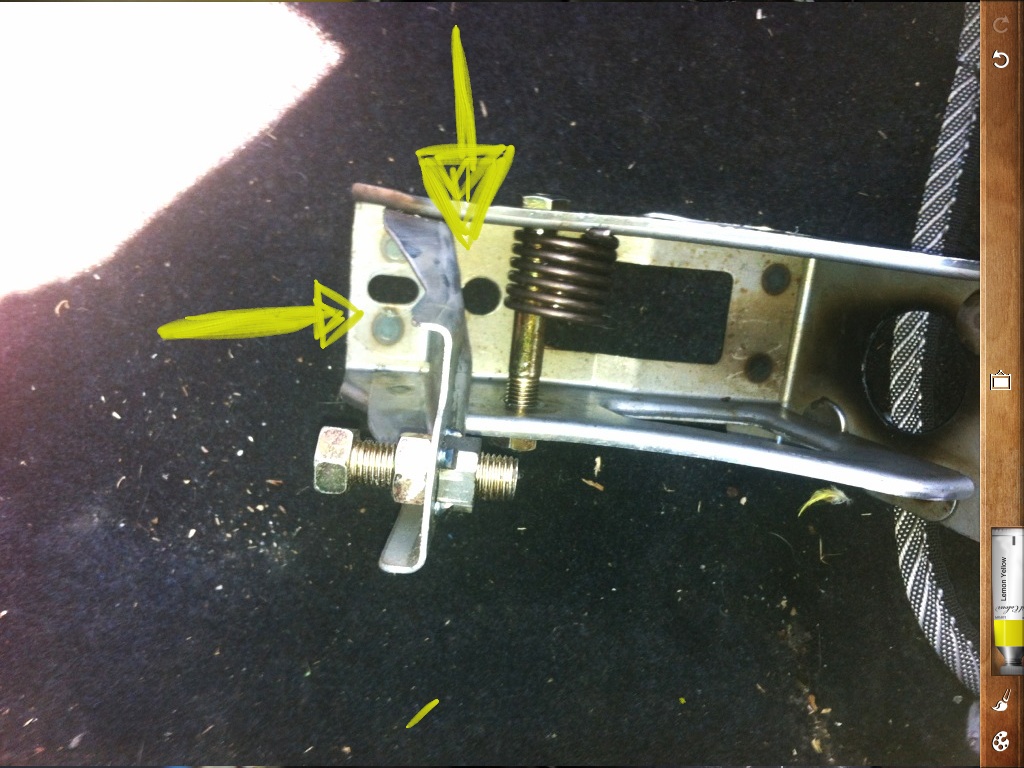

Re: Installing clutch pedal
Could someone check to see what hole the top stud goes through on their pedal bracket please?
- vipfto
- Posts: 4154
There is a stud where it goes through then put nut over too tighten
FTO GR-TURBO
172KW ATW @ 11PSI
172KW ATW @ 11PSI
Yep but what hole does the stud go through? The end one or the second one?vipfto wrote:There is a stud where it goes through then put nut over too tighten
- vipfto
- Posts: 4154
vipfto wrote:Top from memory
