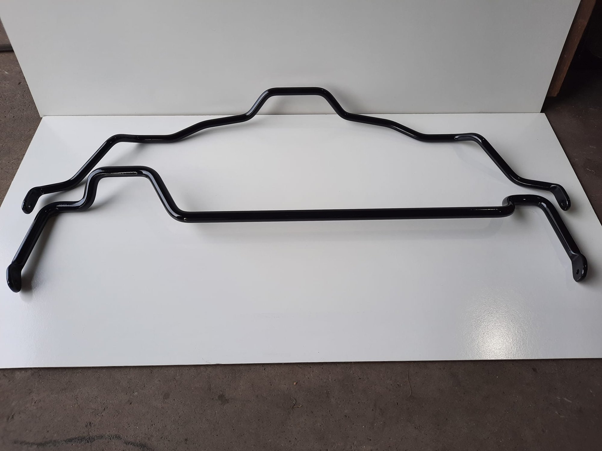

Does anyone know anyone who went for signature Sway bars?
Feedback issues etc?

22 rear & 26mm front solid spring steel
Re: Selby/Signature swaybars
d_dan wrote: Fri Jul 23, 2021 9:03 am 22 rear & 26mm front solid spring steel
Do you mean 22 front and 26 rear?

Ohh lord I hope so. The RPW site actually says 26 front and 22 rear but it doesn't make sense.
Also the pic shows the rear one looking thicker than the front.

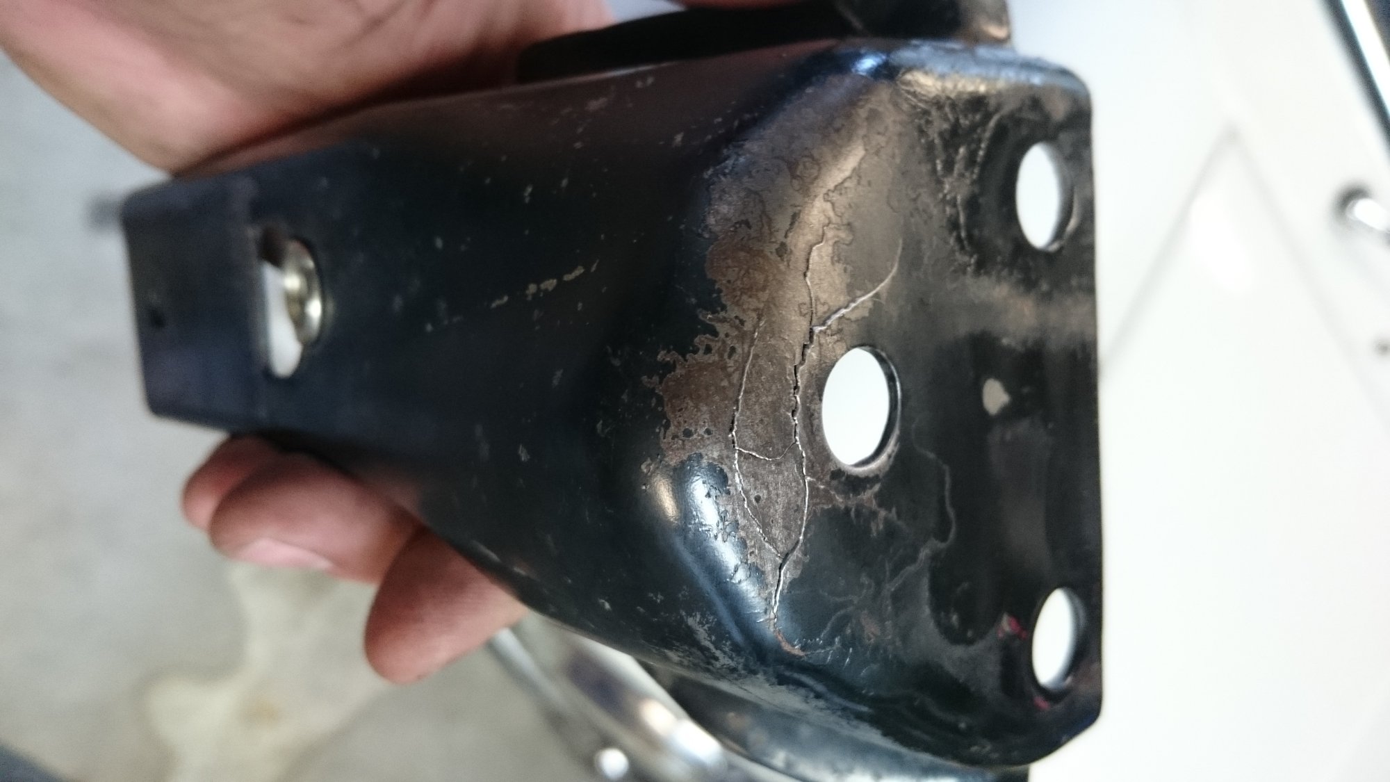

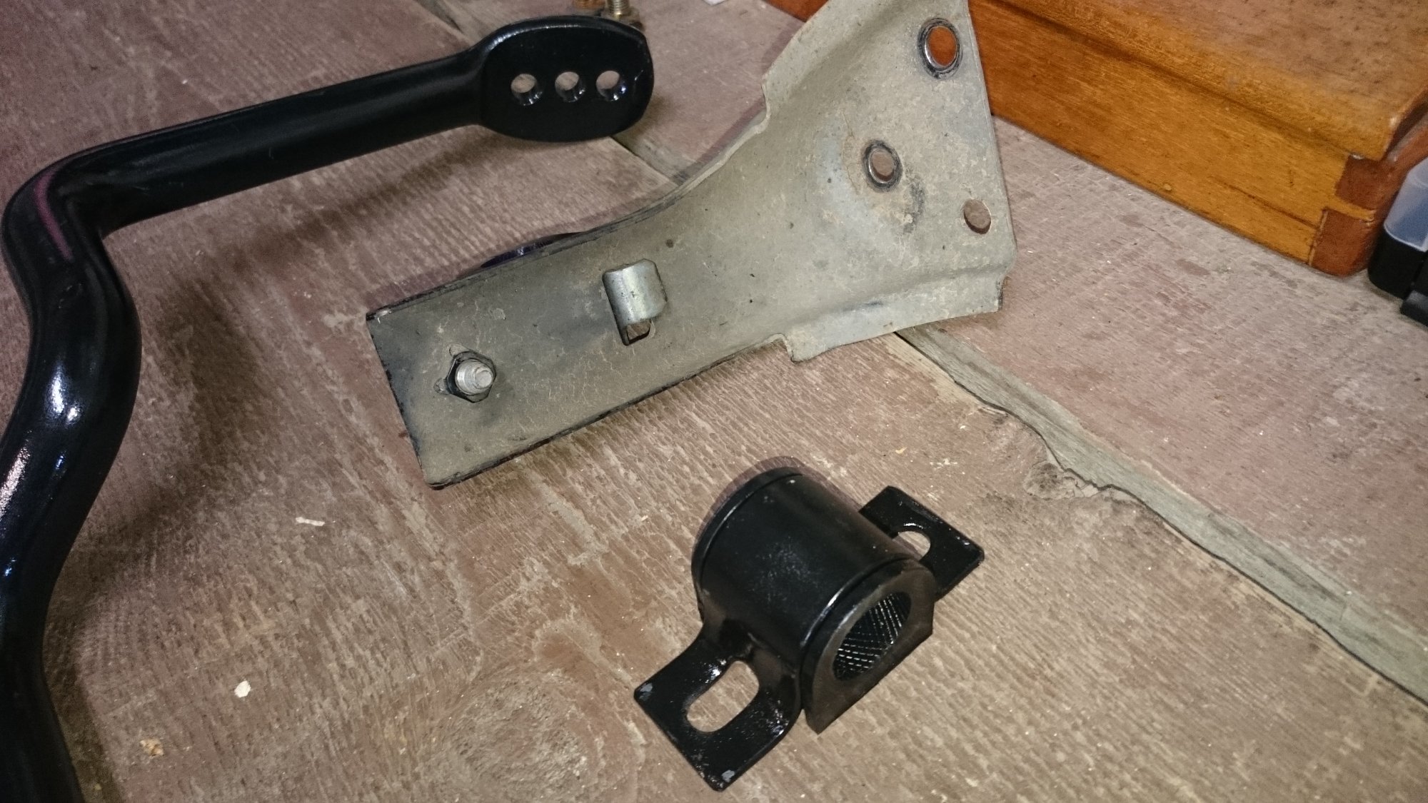

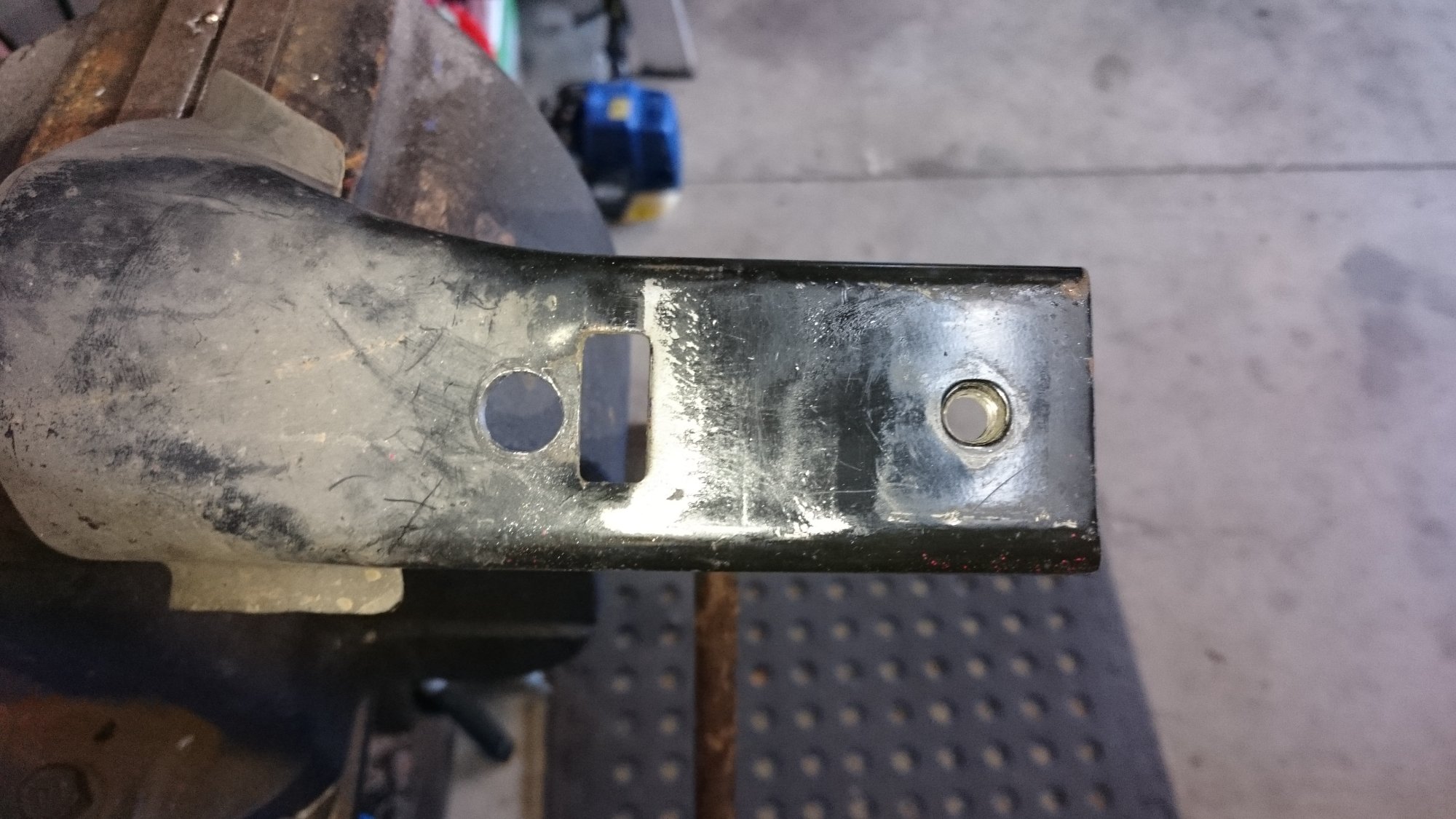

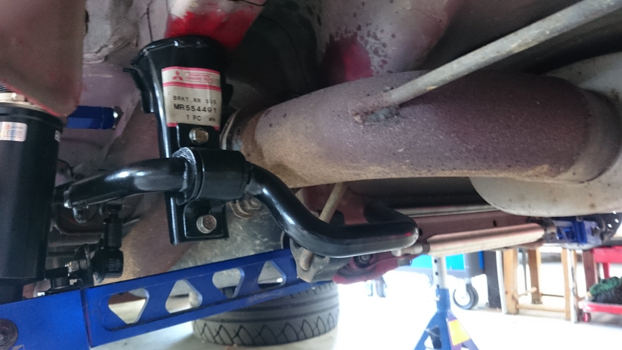

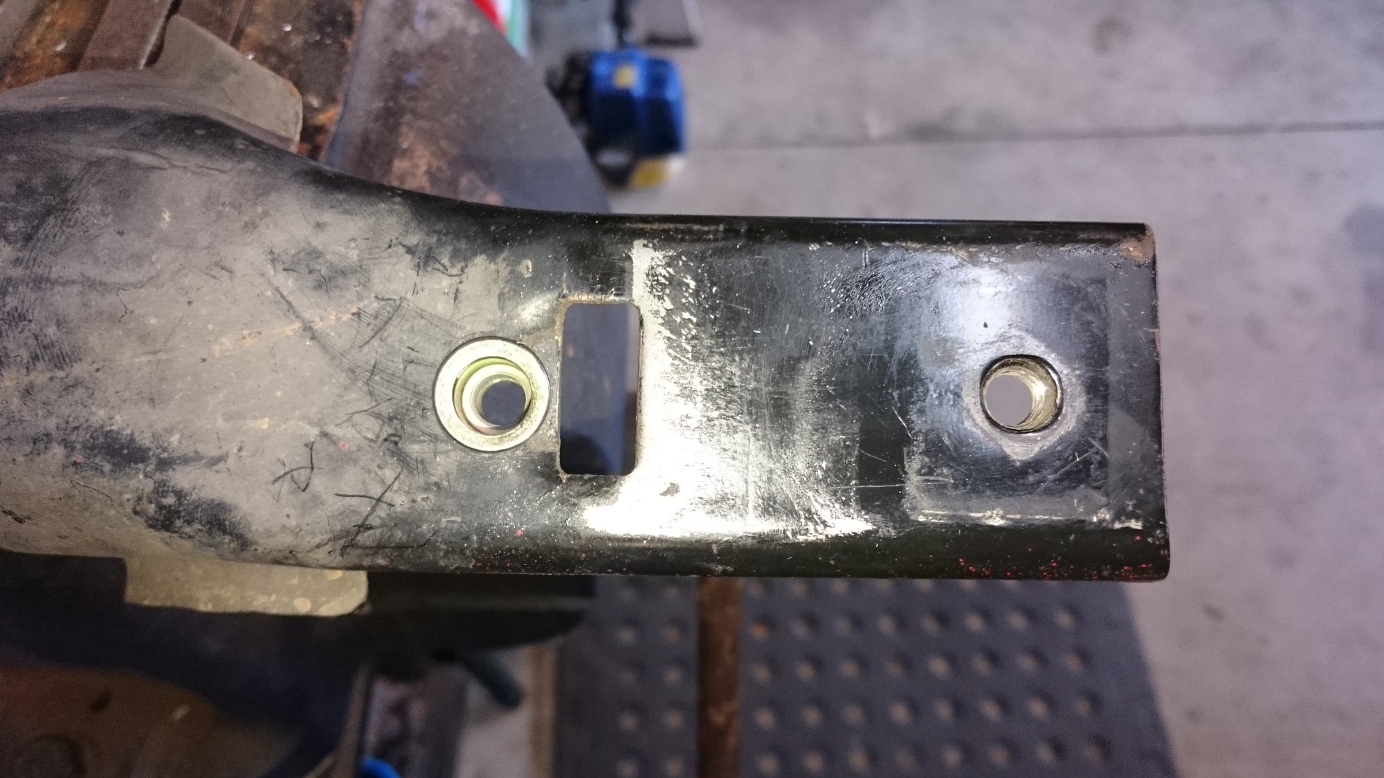

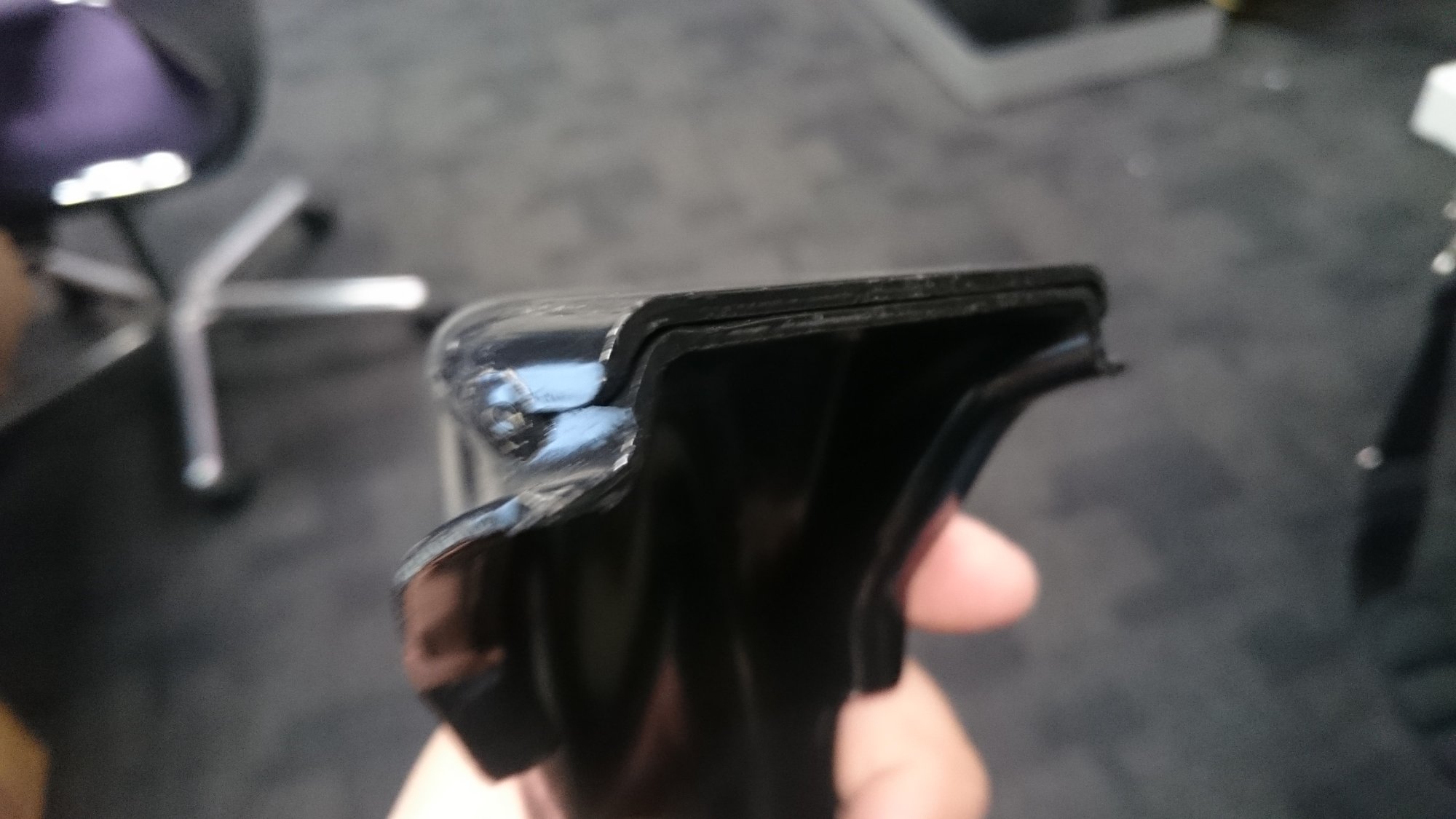

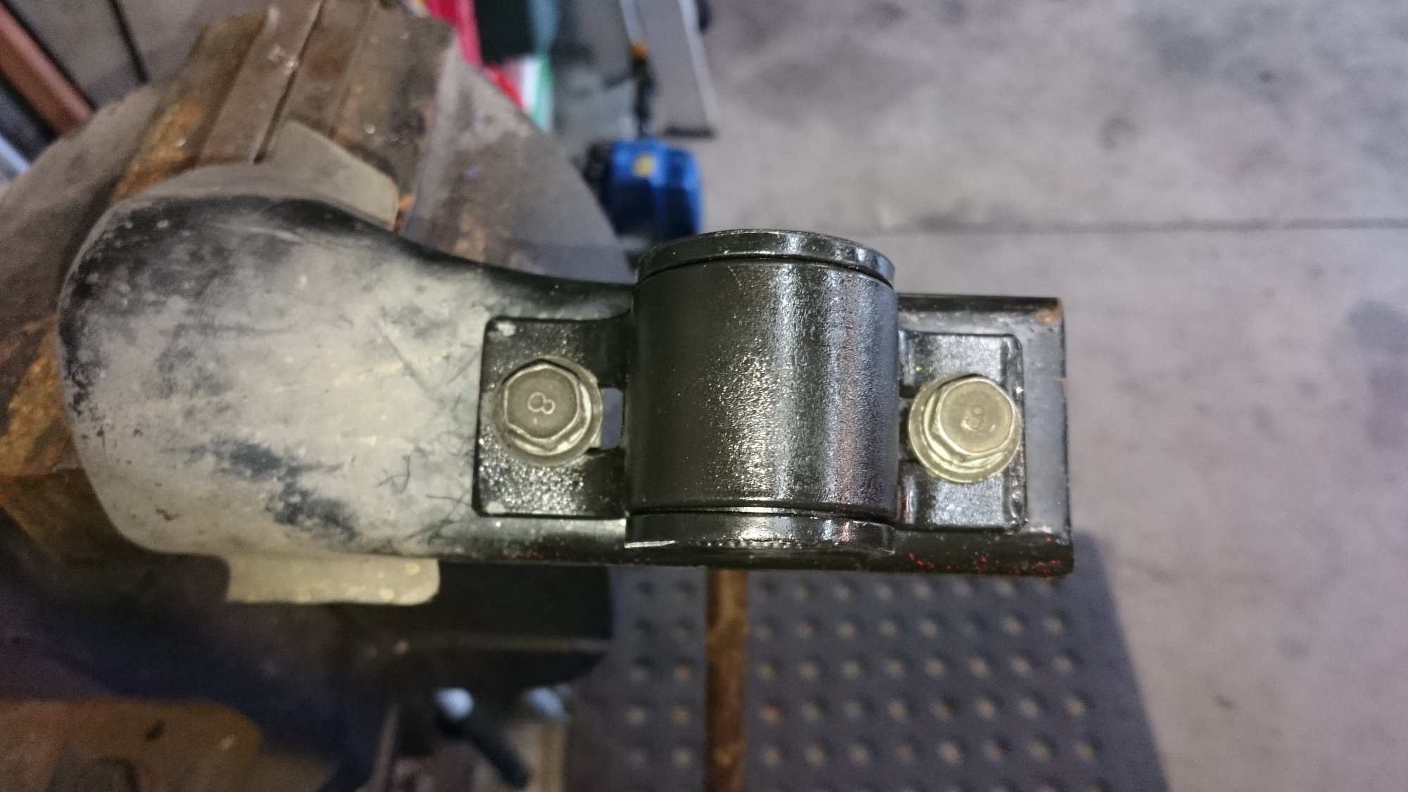

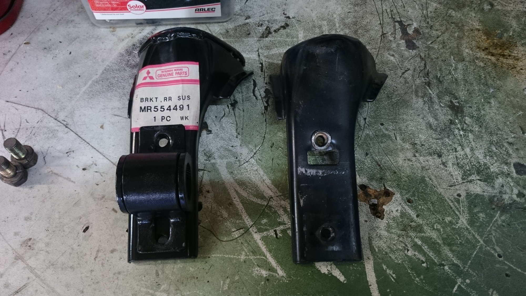

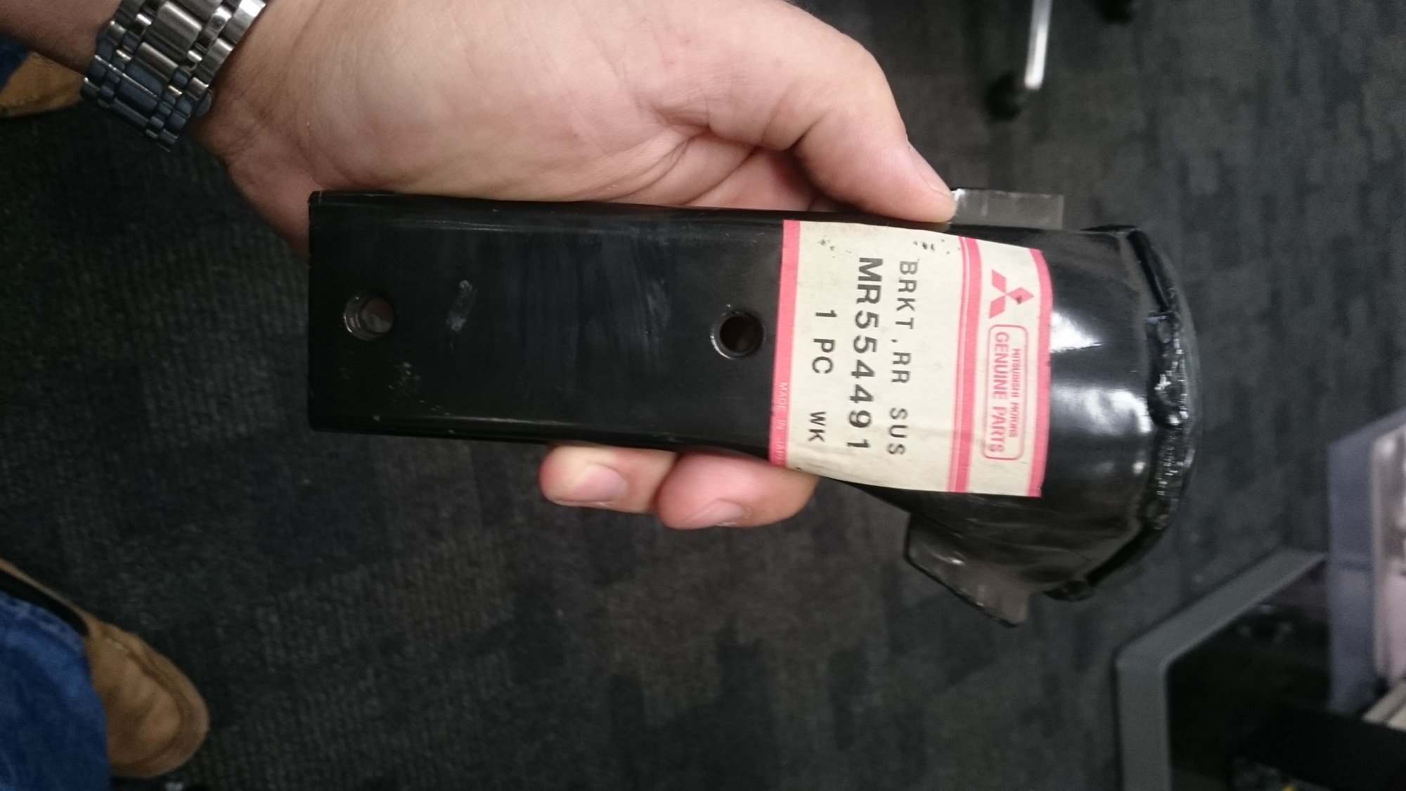

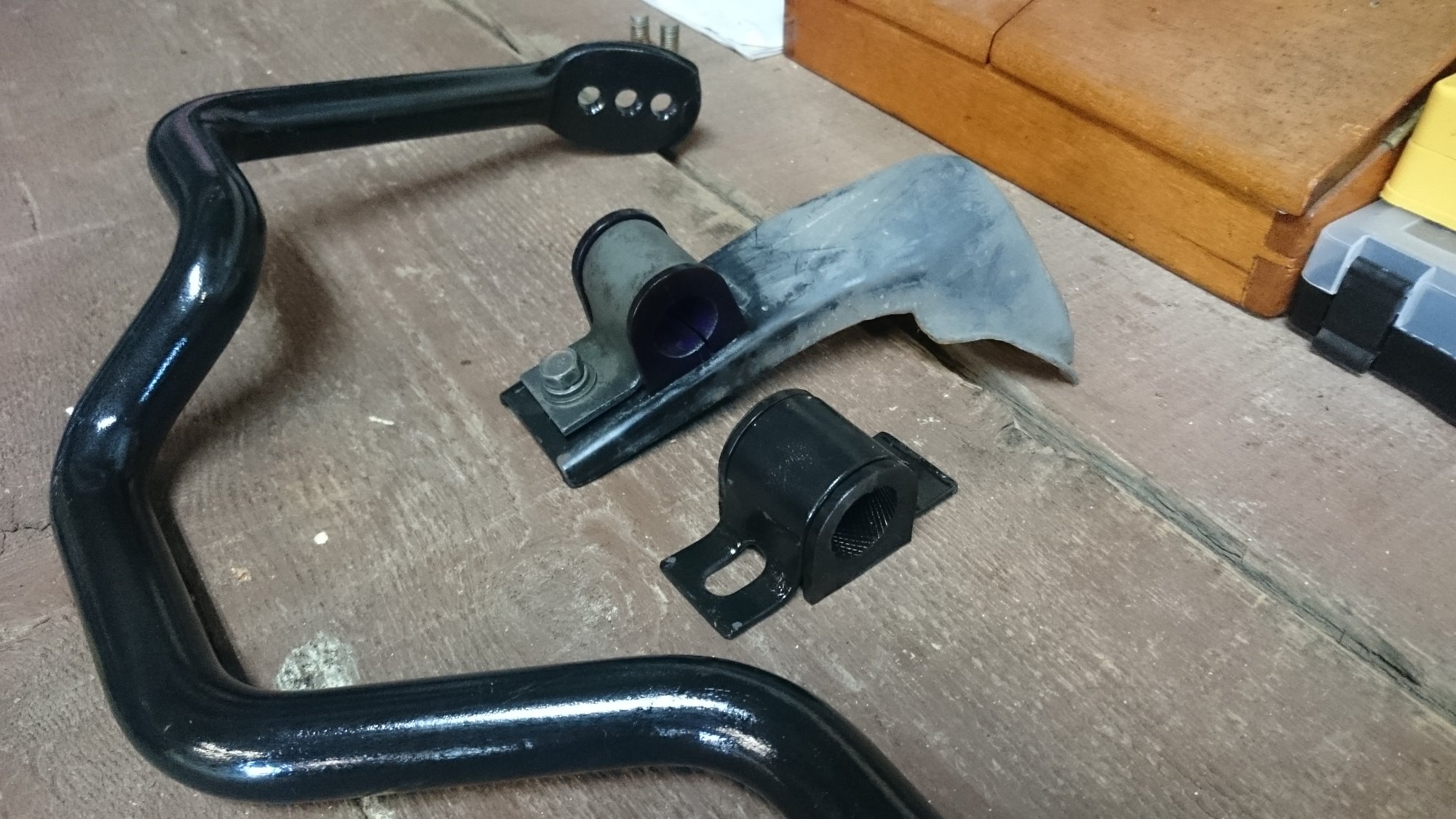

They come with bushes & a mount bracket, but the bracket that it mounts to on the car needs modifying. If it's an early model, you'll need to drill a hole in it, as their bush mounts are dual hole, not hole & slot like the FTO.
I then found the bracket on the car to be cracked, so after all that effort, I just ordered some late model CH lancer brackets from Amayama. Came with 2 holes & a reinforcing plate welded to the top.
