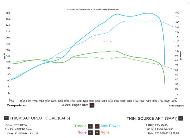

Update the car is up and running (Finally) and has had a break in tune done on the dyno.
The dyno graph shows a comparison to a fully tuned FTO vehicle with our headers / exhaust and a haltech PS2000 ECU.
The tune is on the low rpm camshafts only and rpm limited to 8300 for the time being, but you can already see that it is making more horsepower as well as the power / torque is either the same or higher at the lower rpm levels, meaning we haven't lost any low rpm drive ability.
Ignition timing is very low which is expected on teh 98 fuel with the 14+ compression ratio in the engine. So far max is around 12 - 14 degrees timing.
Needless to say pretty excited, once we engage he high rpm cams with some E85 fuel, this vehicle is going to be a monster.
The 305cc injectors look like they are going to be too small for the E85 though so next time back going to need some 350 - 400cc injectors I believe.
Should be on the road by the end of the week with some updated photos with a writeup on our website. 1000km later, we will get it back and finish off the tuning.
Will keep everyone up to date.

That is pretty impressive considering only the low cams were engaged.
When will the proper tune come?
