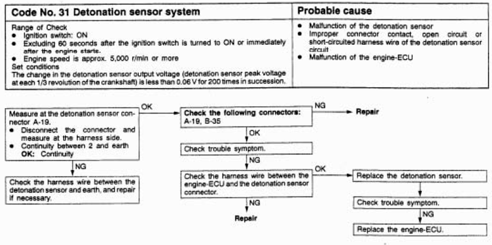

Just got error codes out of it and showing only one, 31 - Det sensor.

The engine won't go above 6500 or enter Mivec without the Detonation sensor in specs.
This might help...
This might help...

Thanks Phil, didn't think to check the manual.
The last drive - when it still won't go over 6500 and getting det sensor error the temp was ok and there's no crap on the oil cap.

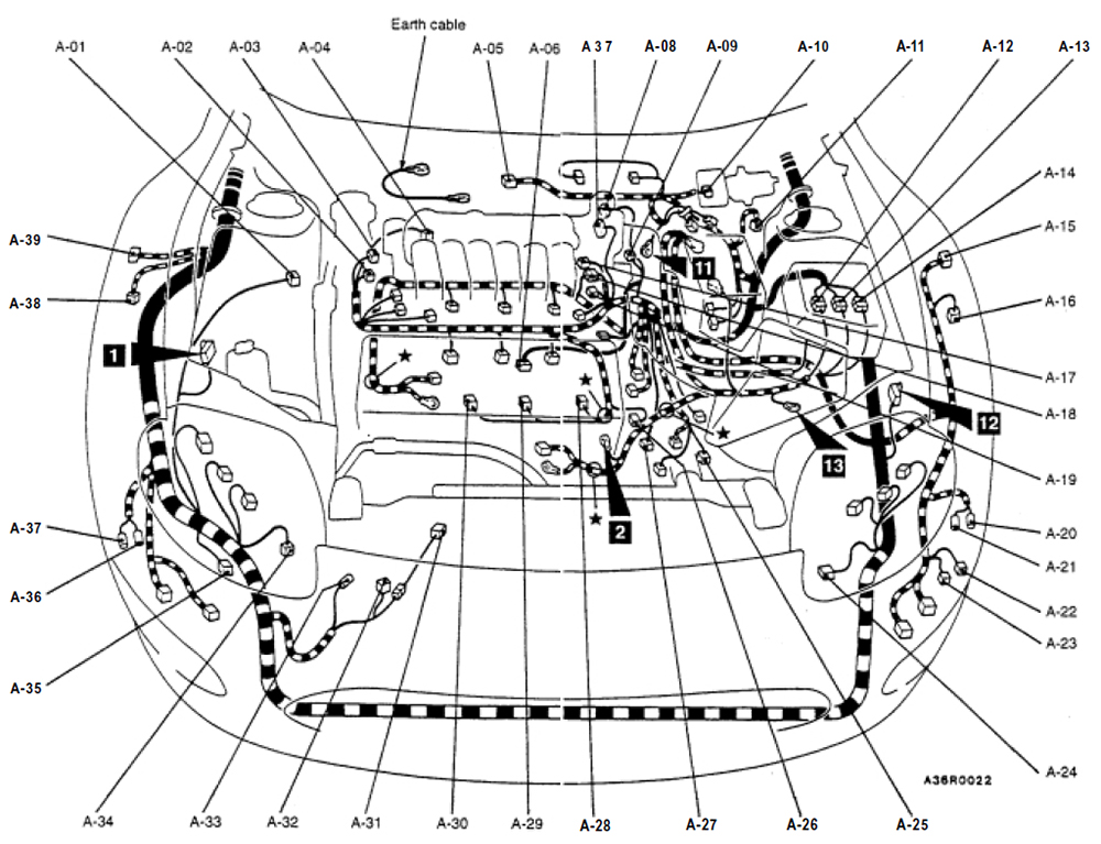

Messed with the connector for the det sensor (the cable was tight/pinched a little against a bolt but shouldn't be that), i've reset the ecu and will take it for another spin later with crossed fingers but yeah not convinced the head is ok.
