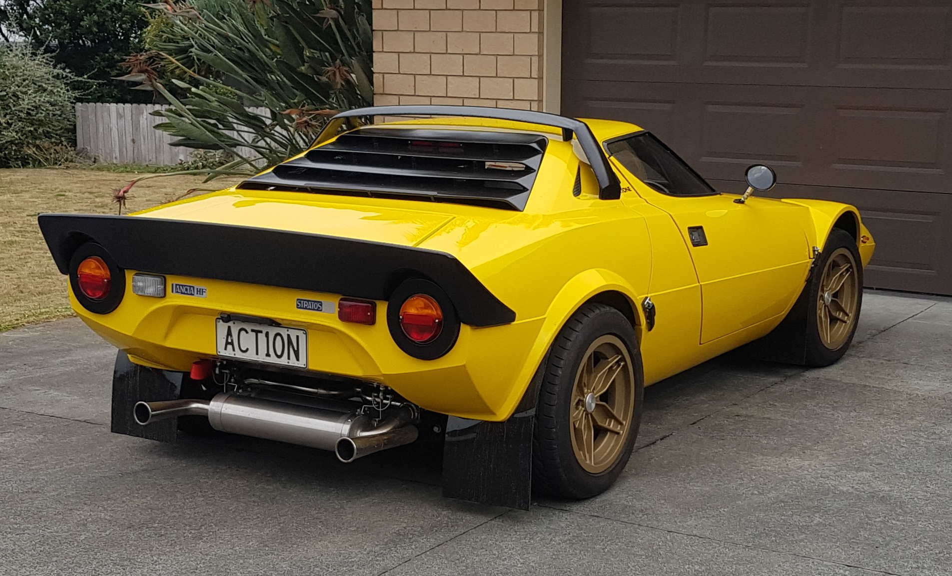

For everybody wanting a mid engine 6A12, here's my Stratos replica with a 6A12 Mivec

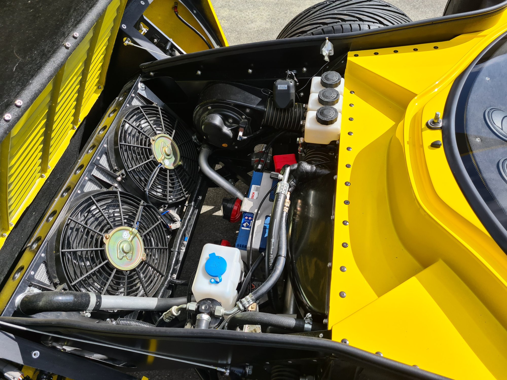

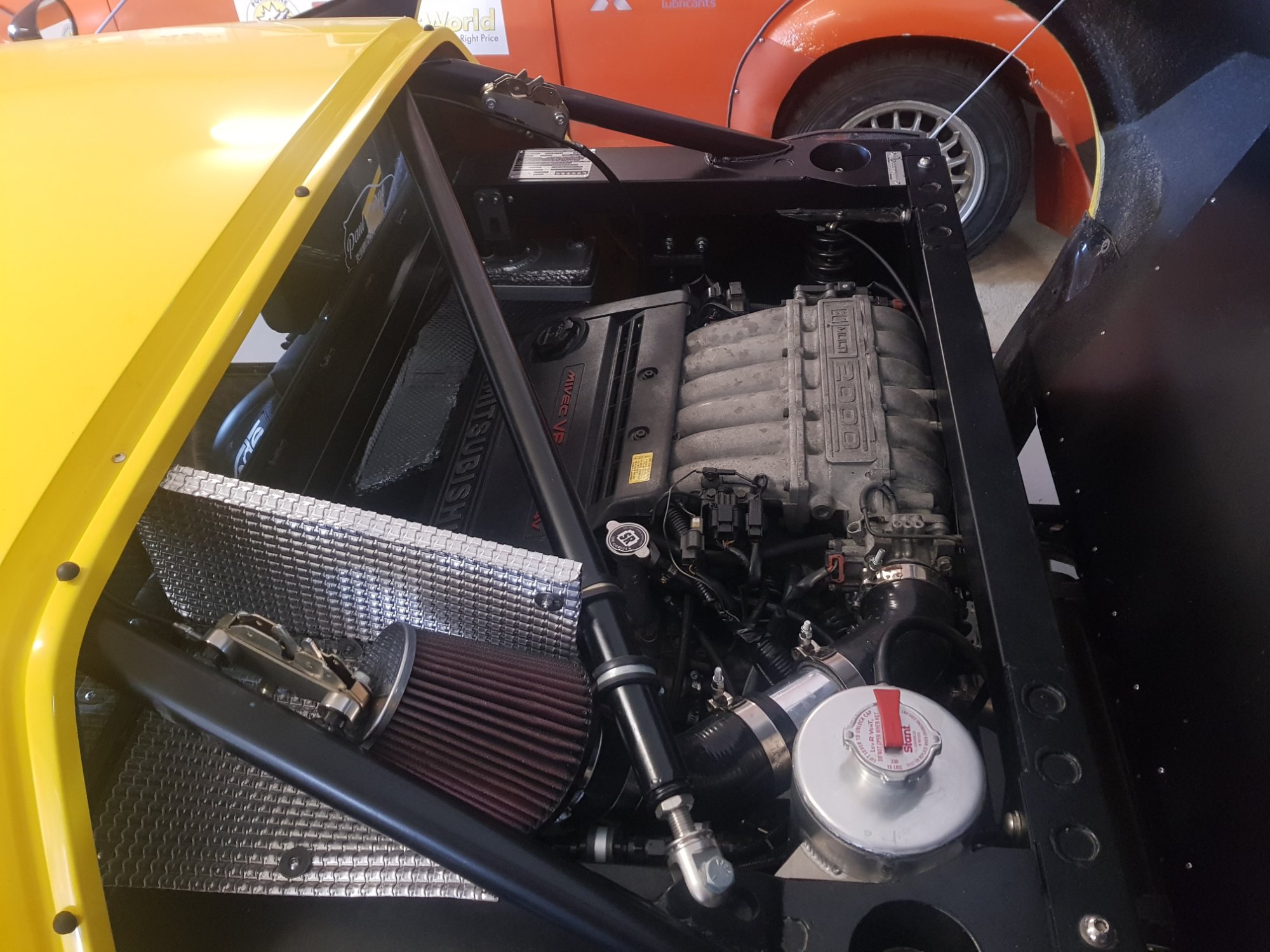

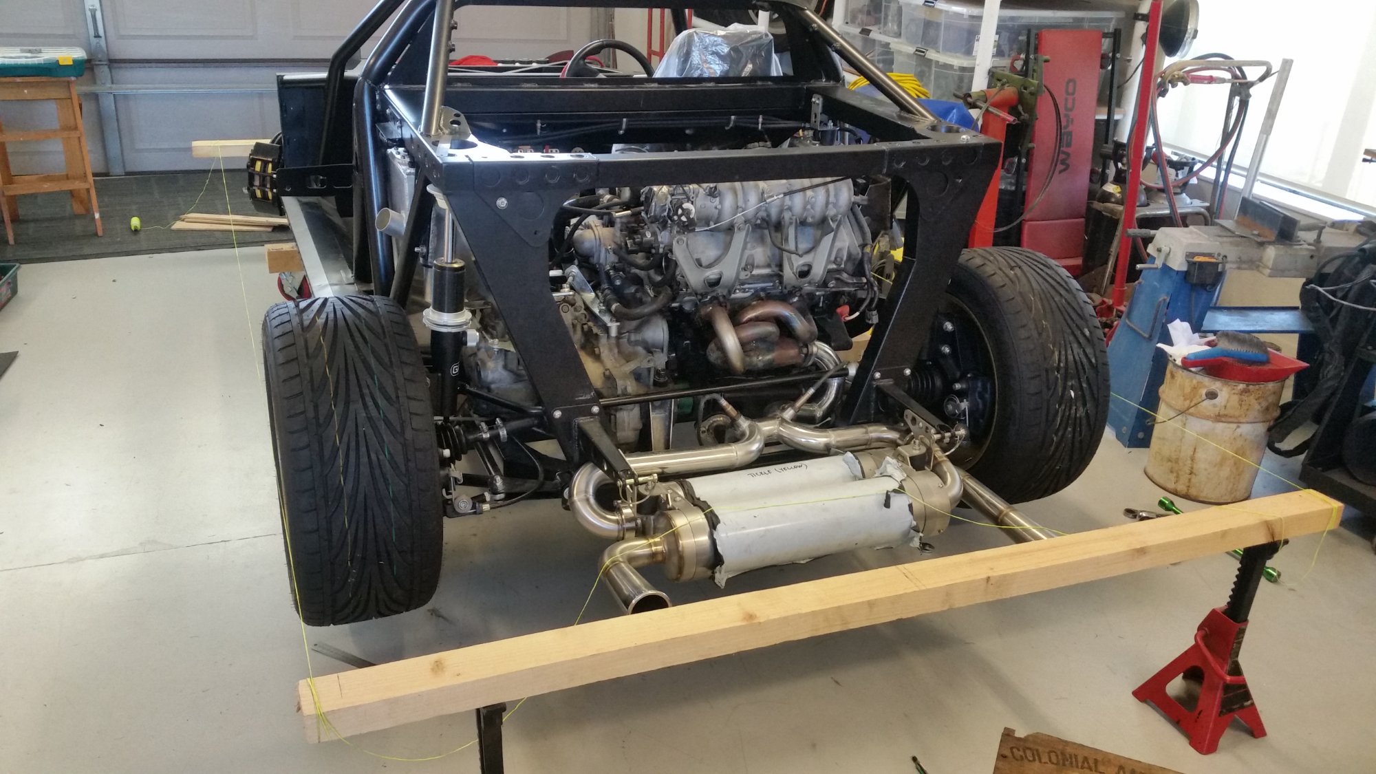

Here's a cross section of photos
- 1st Drive.jpg (271.21 KiB) Viewed 27216 times
- 2019-09-21 11.39.27.jpg (363.67 KiB) Viewed 27216 times
- Front Nose Compartment.jpg (645.09 KiB) Viewed 27216 times
- spetz
- Posts: 2915
Re: MIVEC V6 into..... 1997 S1 Lotus Elise
Sounds a bit different than an FTO, presumably since it has a very short exhaust.
How does it go?
How much power did it make?
And what were the biggest challenges of doing this swap?
How does it go?
It goes really well, I'm still tweaking things but it's certainly fun to drive.
Currently making 158 Hp at the wheels, but we've got the rev limiter set at 7000 rpm so I'm hoping for a bit more once the final tune is done.
I tried really hard to make the headers all equal length which may be some of the sound difference, also it's a 6 in 2 with a H pipe system rather than the FTO's 6-2-1 system
It was fairly straight forward to fit, the only issues I had was,
Fitting the alternator, there's not quite enough room for the stock one, so I've got a small 40 amp one on a custom bracket. If my wife hadn't wanted A/C it would have been easier.
The stock water pump is not quite good enough to pump the length of the car at idle so it was over heating on the dyno at the end of a power run. I've fitted an electric boost pump which seems to have fixed that. Certainly the temperature was still rock steady after 4 laps of Manfield
