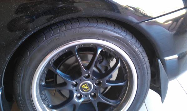

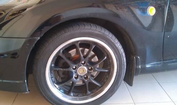

hey guys im plannig on buying king springs and lowering my car. will king springs make the car a little bit stiff? im not planning on getting coils coz too much moolah. just thought king springs will make the ride stiff. but the thing is i dno if im able to lower it coz of the gap. by the looks of the back i cant since its already low unless i keep the back same height but change the front? i don't know how it works haha.
can someone help me out.
here are the pics:
here are the pics:

GPX000, king springs are generally regarded as the softest out there, however the problem is if you go much lower you won't have much travel and you'll be hitting bumpstops which is really uncomfortable

i just wanted to get rid of of gap at the front. its like 4 finger spaces.. just thought king springs are the cheaper option.
but i don't know if AJ changed the actual springs. so confused with what hes changed.

just to clarify that he hasnt changed the springs right?
will i lose out if i get king springs? like it wont benefit the ride?
sorry im just not good with cars

Yep, I didn't change the springs on GPX000. It already had Pedders springs and was low enough for me so I kept them on.

hey AJ will it be worth it change them into king springs? coz the front looks off since the gap is bigger than the rear.
ill give it a go, if not ill just put back the originals and just resell the kings lol.

I dunno. I liked it how it was. Piratical without being on stilts. I still had some scraping issues but not as many as others on here do.gpx000 wrote:hey AJ will it be worth it change them into king springs?

I had scraping issues on mine as well when i had kings on the front, it tore holes in my wheel archers so i had to take them off. And since wheel archers cost so much it really wasn't worth it. But i did keep the rear lowerd on Kings, it still looks goodAJ wrote:I dunno. I liked it how it was. Piratical without being on stilts. I still had some scraping issues but not as many as others on here do.gpx000 wrote:hey AJ will it be worth it change them into king springs?
I just replaced my strut mounts and struts with KYB's and kept the standard springs but i seem to be feeling a lot more bumps in the road then i use to
