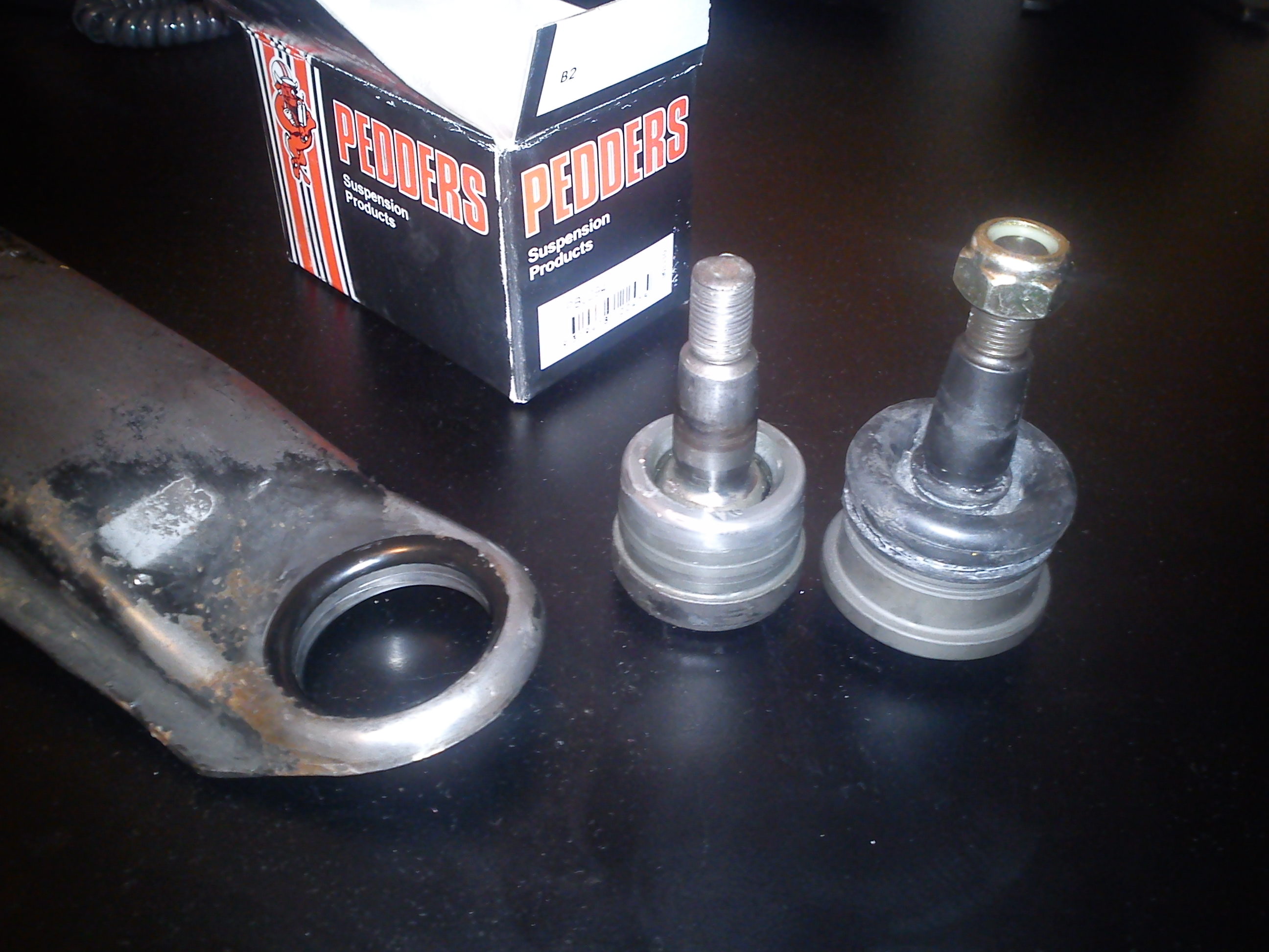

Difference between Evo II, III, ball joint versus Evo IV, V ball joint.

Bennoz wrote:- FTO arms. Yes! You can use them, however you need to press out the ball joints & use 'modified' Evo IV/V ball joints. They will sit too high if you just press them in normally.
When you say modified, in the pic with the 2 ball joints side by side they look like the base part is the same height?
How would they need to be modified for use with FTO arms?
Also were the Evo III arms alloy?
Where the ball joint presses into the Evo control arm is very thick, its a cast arm. The FTO arms are pressed sheet arms & when you press the joint in, its sits much higher. It's a different 'seat hight' if you will. I was shown the difference by Chris Meek (of Meek) when I was out there this arvo. I gave him an FTO arm & the Evo arm as we were discussing what ball joint to use. He helped me pick all the different bits to make it work.

I've edited that big post too. Those Evo II/III ball joints are nothing like an FTO / Magna ball joint (FTO / Manga joints pictures here)

Bennoz wrote:I've edited that big post too. Those Evo II/III ball joints are nothing like an FTO / Magna ball joint (FTO / Manga joints pictures here)
Ah cool, so definitely better to get the Evo arms as well.
