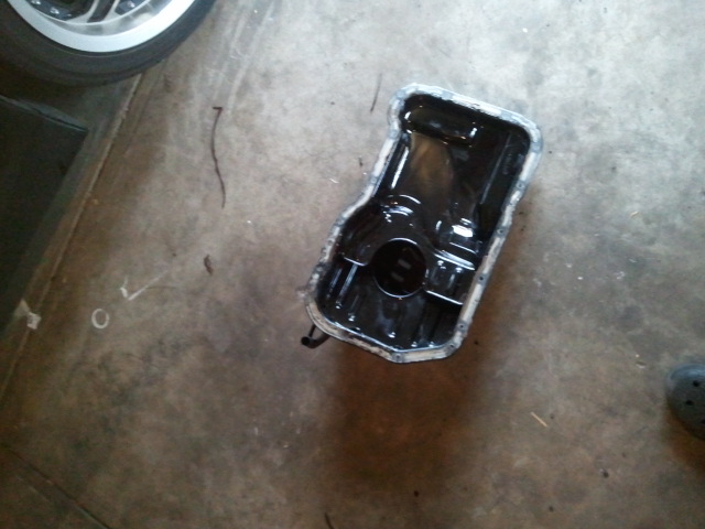

Have disassembled all the new fab work and finished off water feed and return lines and oil feed line. Removed sump for drain line (going to tap it using 8an line to suit with weld around fitting just rule out any risk of leaks or removal) this is rather critical part has to be larger than feed line and has to flow smoothly downhill only or turbo wont last long. Also had to reclock tub once again as didnt mount it way I thought would have gone :roll:

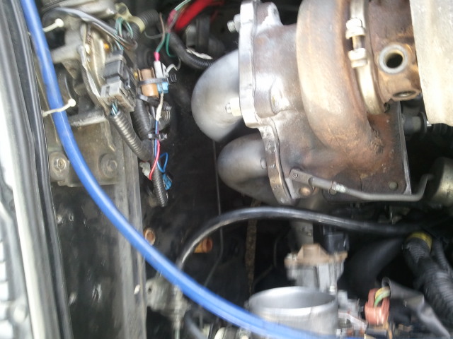

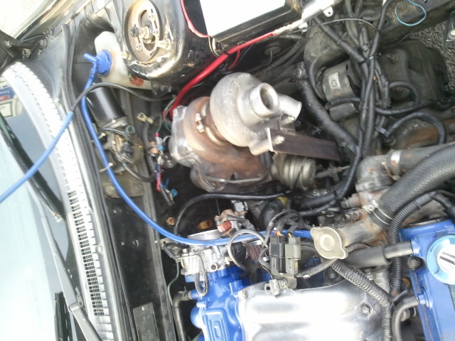

turbo mounted
turbo mounted
2012-10-23 17.38.14.jpg (101.68 KiB) Viewed 2031 times

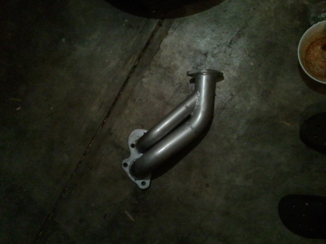

down pipe two seperate for wastgate and exhaust
2012-10-23 17.38.26.jpg (97.05 KiB) Viewed 2031 times
down pipe out of car
2012-10-23 22.27.21.jpg (100.59 KiB) Viewed 2031 times

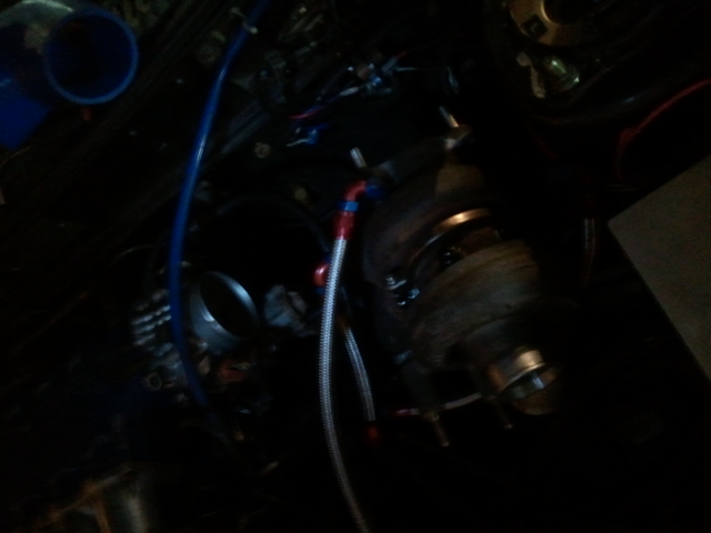

all water/oil lines will take better pic when outside
2012-10-24 16.08.44.jpg (99.64 KiB) Viewed 2031 times
sump removed
sump removed
2012-10-24 16.49.51.jpg (98.61 KiB) Viewed 2031 times

yeah actually much smoother than I thought (so far) only issue is my drill isnt big enough to make size hole i need to sump.

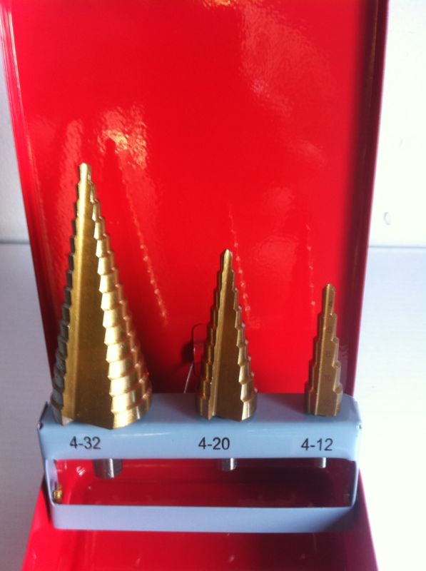

vipfto wrote:only issue is my drill isnt big enough to make size hole i need to sump.
Get yourself a "step drill" bit. ;)
http://gettoolsdirect.com.au/irwin-3-pi ... 15502.html
http://www.ebay.com.au/itm/IRWIN-UNIBIT ... 35c0d90b47
http://www.ebay.com.au/itm/3pc-HSS-STEP ... 2ec1b915eb
Step Drill.jpg (41.2 KiB) Viewed 2011 times
Step Drill 01.jpg (7.48 KiB) Viewed 2011 times

ONE STEP AHEAD MATE ALREADY SORTED LOL

vipfto wrote:ONE STEP AHEAD MATE ALREADY SORTED LOL

They are the best drill bits! Got a set from Bunnings years ago and that's all I use now unless for wood or very thick metal.

Alrighty have made new clutch line and return line for oil. Was actually simple solution seeing as back of sump where oil has to drain to is flat I used the same fitting taht the turbo uses its a simple -8an fitting with gasket that bolts up so no tapping or welding required and much less chance of leaks. will put up pics later.
Not entirely happy with gasket between hot side of turbo and down pipe so will make new one out of copper this weekend. Have also installed gauges
