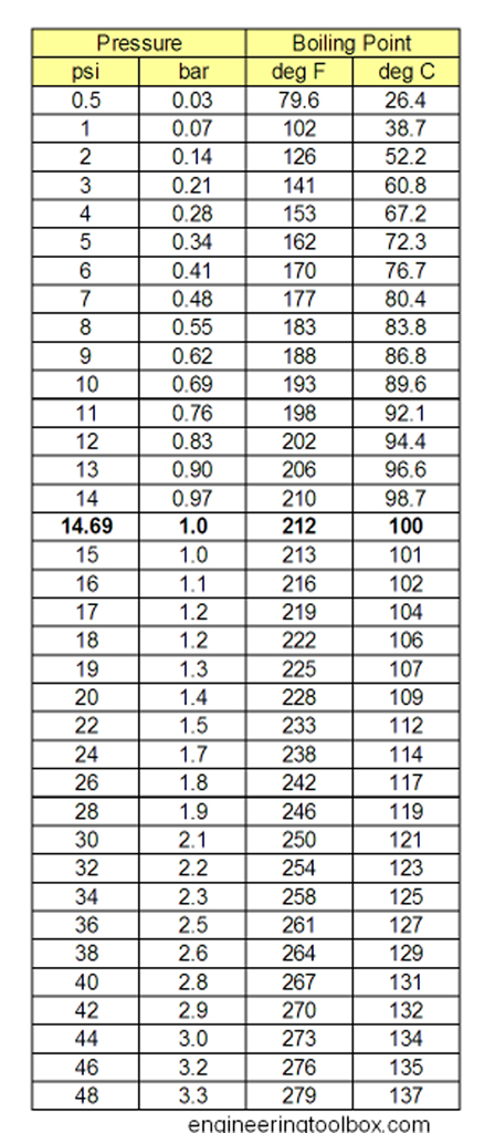

If there's only water in the radiator then at about 95degC it'll be turning to steam. Temp switches can't detect the temp of steam, hence fans not turning on.
Re: The Mighty Barina
Water won't turn to steam at 95 while under pressure...
I would say it's your fan switch or thermostat or radiator or all of them.
Yes, coolant will lower the boiling point further, but your car should still be able to run on water for the short term.I would say it's your fan switch or thermostat or radiator or all of them.
