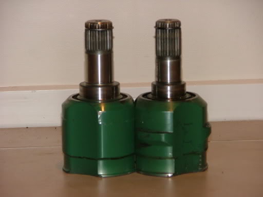

I found this on the mivec forum:
http://www.mivec.co.nz/forums/viewtopic.php?f=34&t=3024
it looks like the one on the right on the picture is the one i need. the longer 25 splines on the cv cup have been made for LSD boxes.

In that case, I guess I should check them all again. I was only measuring the complete length, not the length of the spline.

I'm still having trouble with getting mine sorted. The issue of cutting the shaft down to size is that your cutting the splines off therefor weakening the drive.

If its done professionally you get it shortened and the splines recut, complete with circlip groove. If its done with a hacksaw....MOR31 wrote:I'm still having trouble with getting mine sorted. The issue of cutting the shaft down to size is that your cutting the splines off therefor weakening the drive.
