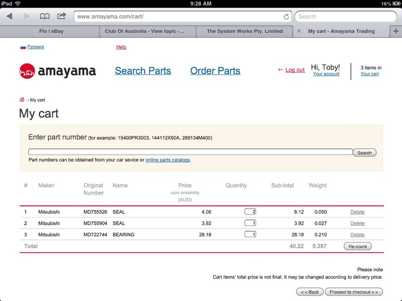

Just ordered these drive shaft seals and bearing. (Because it was recommended in the guide)
I don't know what I'm looking at when it comes to the seals, are they an easy replace?

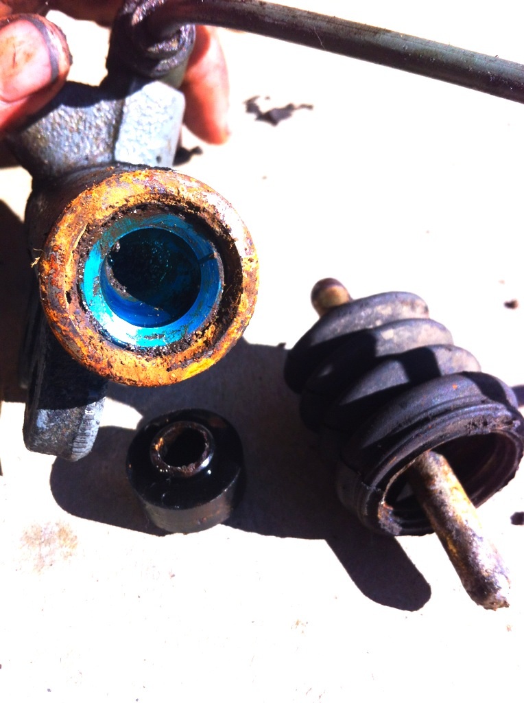

When I drop gearbox out and stuff, this got knocked around abit, is it broken or fine, how does it go back together though lol?
Replace that holy f**k
Sahin wrote:Replace that holy f**k
Dude tell me what it is and how's it fucked lol?
Looks like the clutch slave mate and it looks like sh*t! it should be one piece not three lol
Yeah,I would have said clutch slave as well. And yes,is buggered.
    dstocks wrote:Yeah,I would have said clutch slave as well. And yes,is buggered.
    sure is.
    Got one for sale by any chance?
    Might have a 2nd hand one in reasonable knick actually. Wont get a chance to look until Saturday though.

      Faaarrrrrkkkkkkk, never seen a clutch slave do that before, if thats the quality of the slave i wonder what quality the box is in.....
