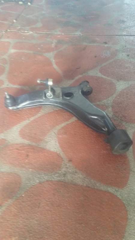

I've got the suspension arms out and discovered that the passengers side arm was a prefacelift with a bracket welded on for the GPvR drop link set up.
The car must have been in an accident that's fucked the passengers side arm and the previous owner has engineered this piece
SOLUTION?: Ordered a new arm from Amayama

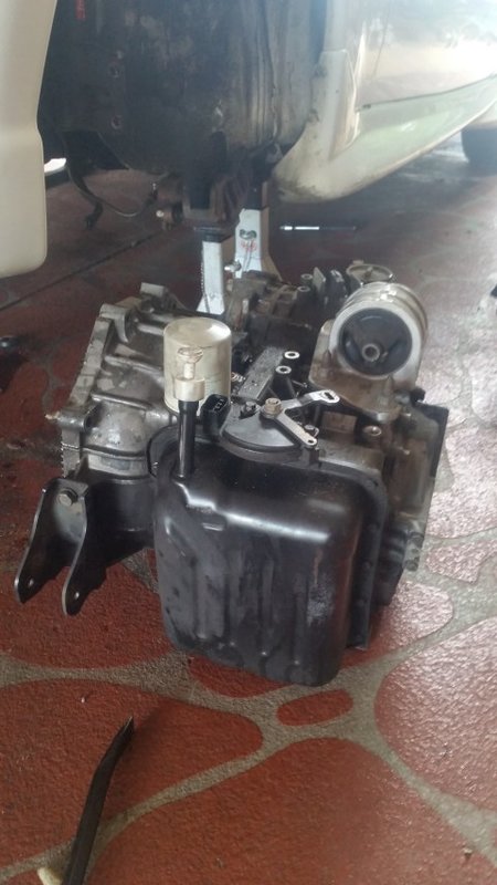

I got the gearbox out with relative ease, I missed 2 bolts on the gearbox housing so after much confusion it lowered down on the jack easily.

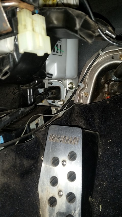

I then set about pulling the interior auto parts out. The gear lever was a piece of piss but the auto selector cables were a bit tricky as the bracket sits behind the auto ECU bracket.

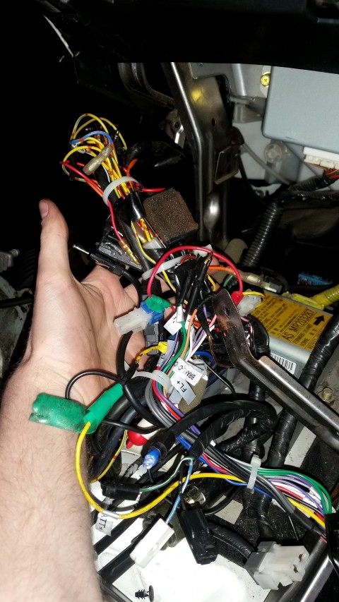

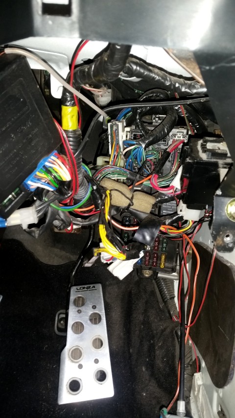

This was my interior wiring, I almost cry whenever I look at it.
