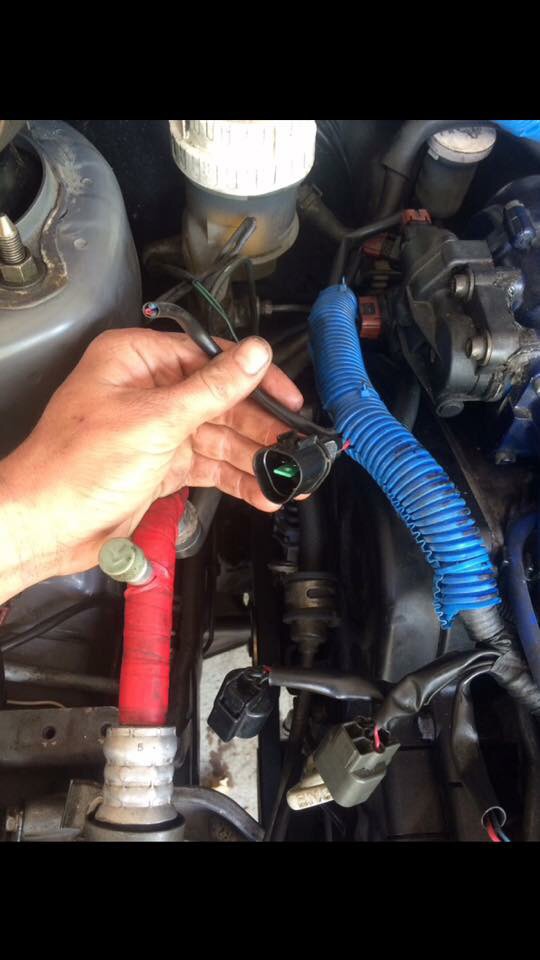

There's 12volts going to the starter from the battery, but there's no 12v coming from the small signal wire to the starter when the ignition is turned (all the way).
I've traced the wire back to the ECU which is mounted on the passenger footwell just above the flare .. Is it an ECU? I thought the ecu is the thing that looks identical to this, but it's under the stereo surround & dash. So we have two ECU's ???
I've been told it could easily be a faulty ignition switch, but if I can't trace the wire back to the switch (because it goes to this ecu) than I cant test it :(
SO, I know it's something that is attached to this wire.
Is more likely to be the ignition switch or the ecu? What else could it be.

It won't crank if the cam sensor isn't plugged in... your wiring doesn't make sense,
Is your crank angle sensor plugged in? And is your cam sensor plugged in?

Yes It will, It just won't fire. I've had both crank and cam angle sensors disconnected and it cranked.

I'm not sure about that sensors, I think they are plugged in and phil could be right about me being a complete stupid c**t :lol: I've probably got both ends under that blue sh*t. I shall check in the morning.
Is the engine control system the ecu? The wire From the starter in black and red, but like I said, I lose it after it goes to the computer thingy

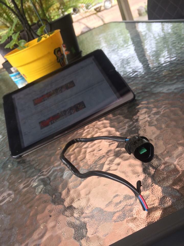

PHIL069 wrote:?
Maybe you need to get rid of that silly blue conduit so you can follow the wire.
I bet one end has the extra plug and the other end has the cut wires, in which case...pull it out and throw it to hell and smack yourself on the back of your head!!!
