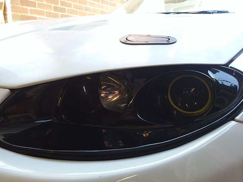

can you show the necessary damage to the headlights please?

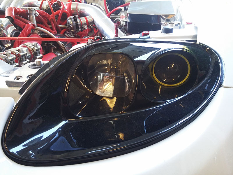

Sorry for the delay in replying. I now have some close up pics ...
Re: Agressigve looking bonnet?
Is the perspex still on those lights or has it been removed?.

    Post by dazjb »
    Nope, its been removed and the two pieces blended together

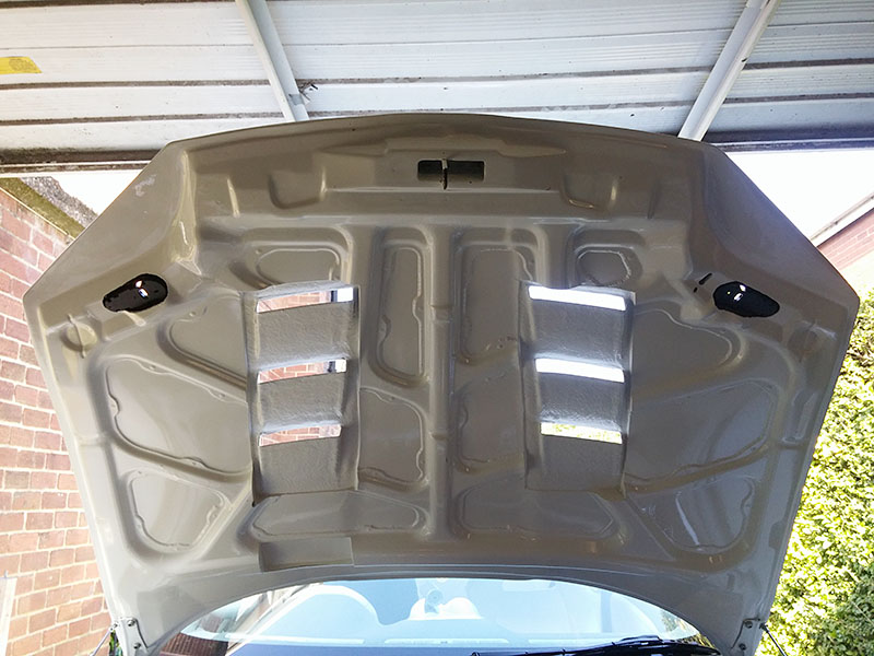

    dazjb wrote:I've done similar to mine. Bonnet is fibreglass so was easier to work with than the standard steel one .. I just extended the bonnet using fibreglass matting. Had to grind a bit off the top of the headlights as well so the bonnet could close properly but since they are lense-less lights it wasnt too hard a job.
    ^ Some grinding.

    Making a set of lense-less lights isnt too hard if your handy with body filler ... makes it much easier to do the bonnet. I'm making another pair at the mo, I'll take some pics and post up a guide if it helps.

    Just to confirm as I've never been able to tell from pics, but there's just a piece of plastic/perspex/whatever cut to size and glued in front of the high beam bulb? Anything covering the low beam projector or is it just open?

    Post by dazjb »
    Yep, piece of perspex covering the high beam, nothing over the low beam bulb. I've driven it in hard driving rain like this with no problems, so have others over here with the same headlights ... and we have much more rain than you do ;)
