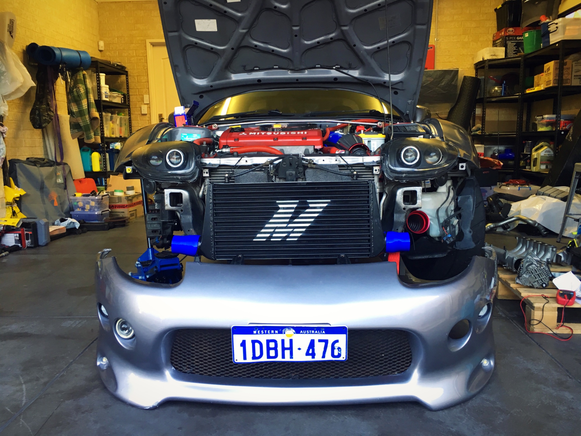

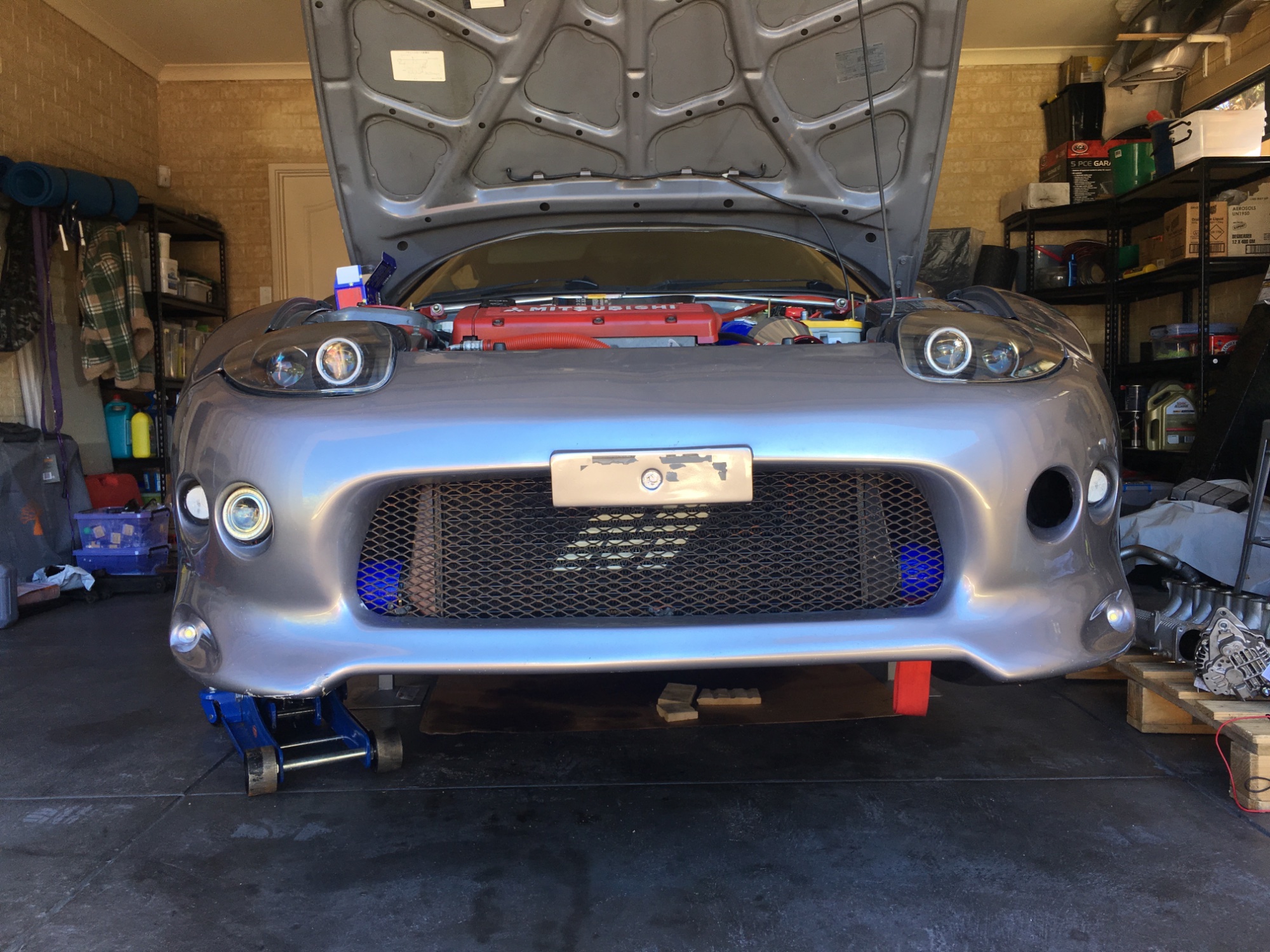

The Mishimoto intercooler arrived, which looks dope! Test fitted it, and its quite a snug fit, literally justt clears everything
I took my plates off, to see what it'd look like with no plates, since I might get slimline platinum plates. The left over residue is from the double sided tape.

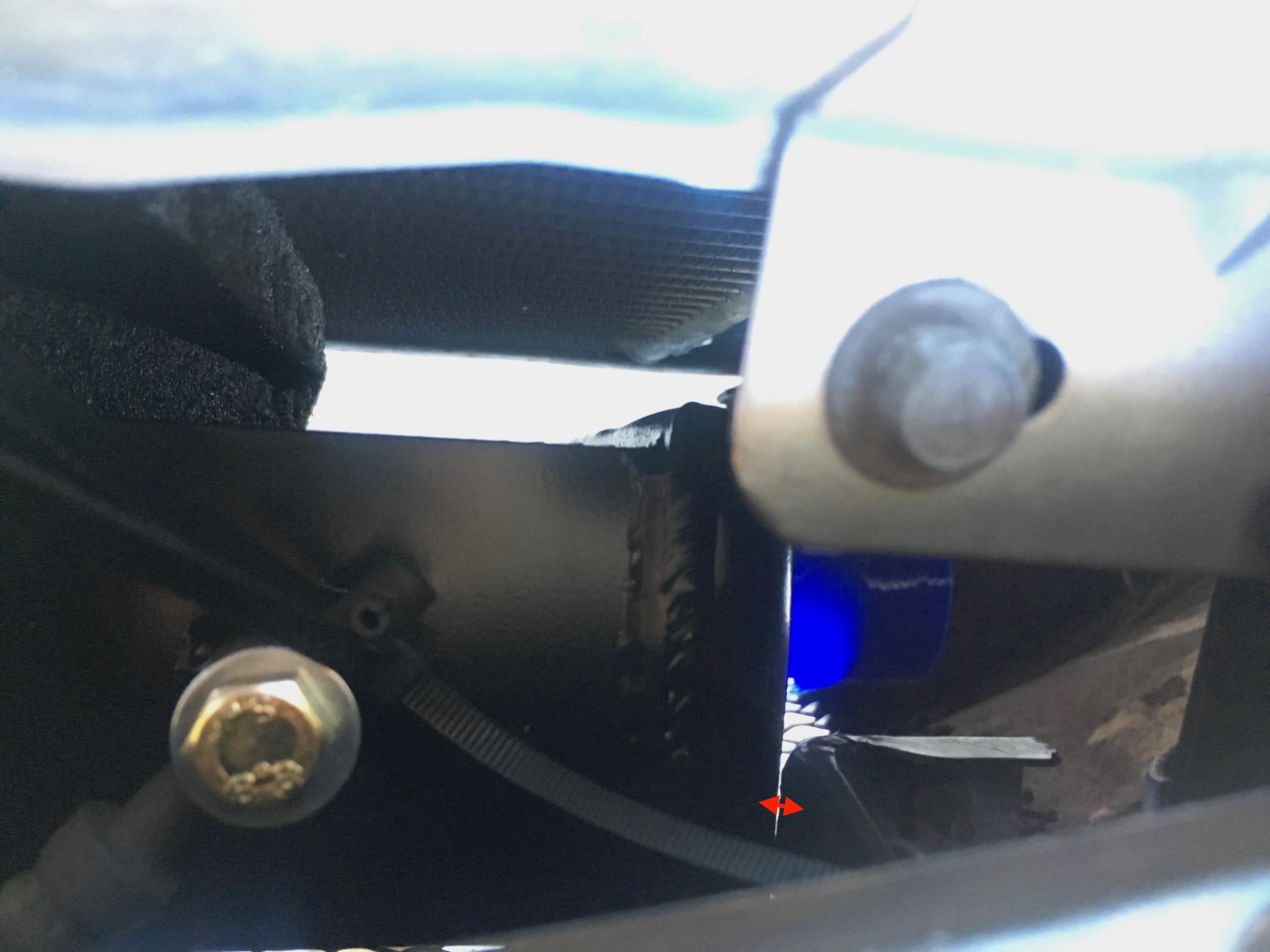

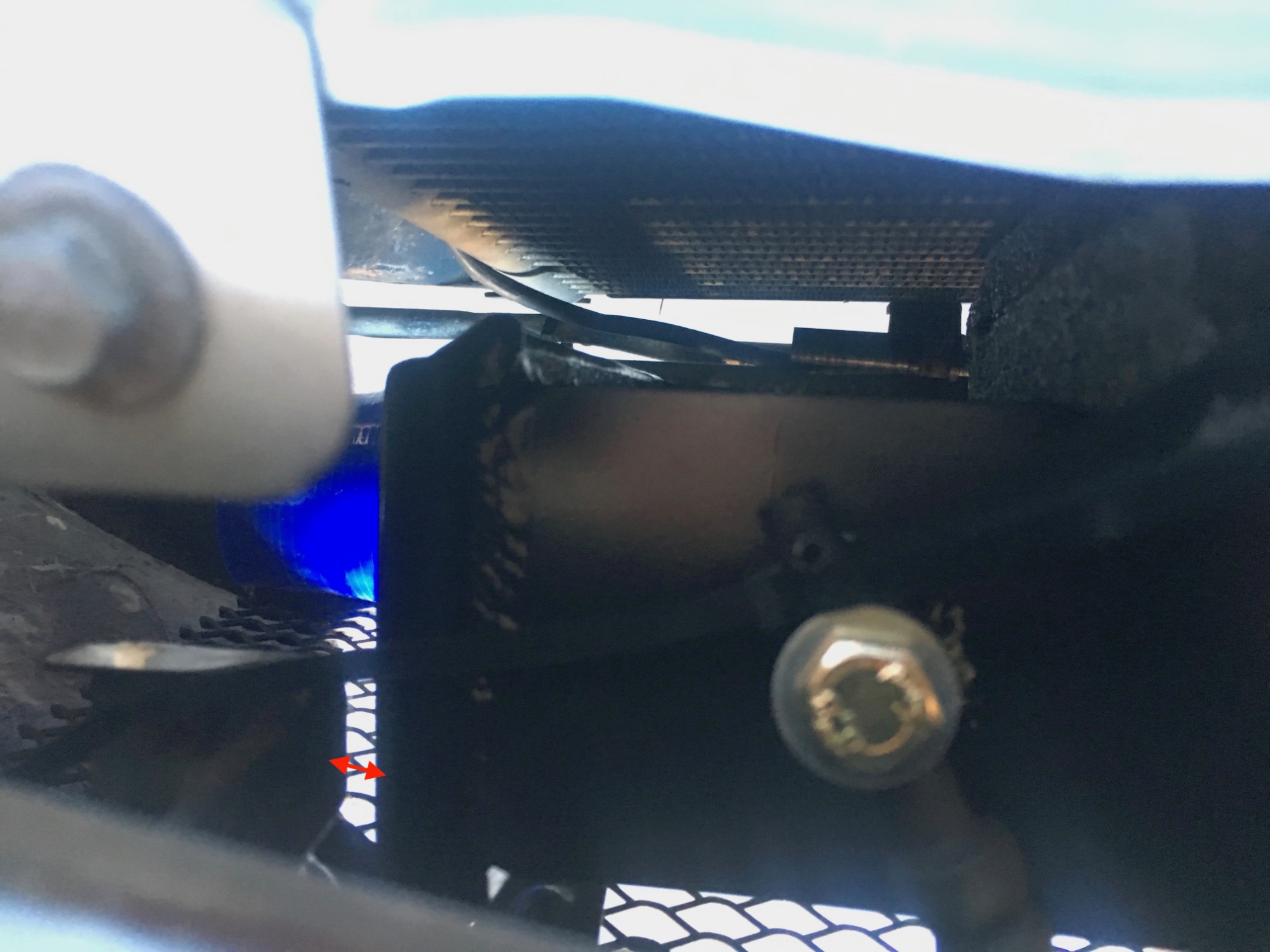

The following two pictures show just how close the intercooler misses the bumper frame/reinforcement. Not a big deal if it did come into contact with the frame, but it luckily just misses.

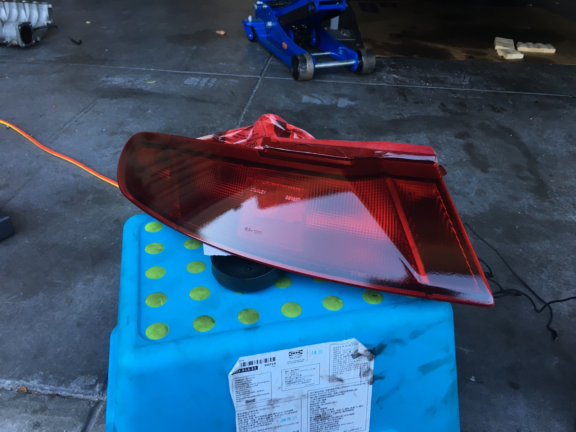

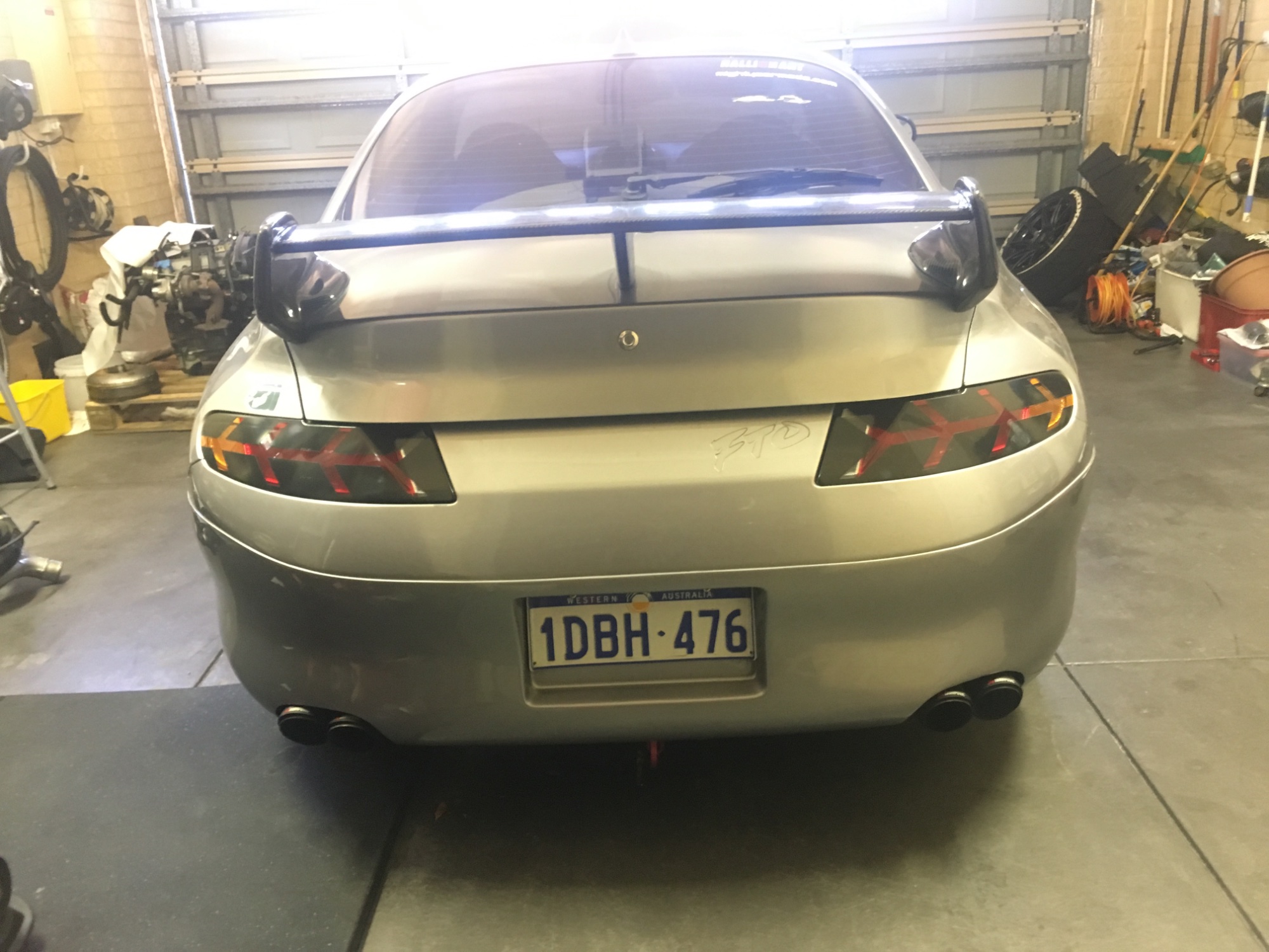

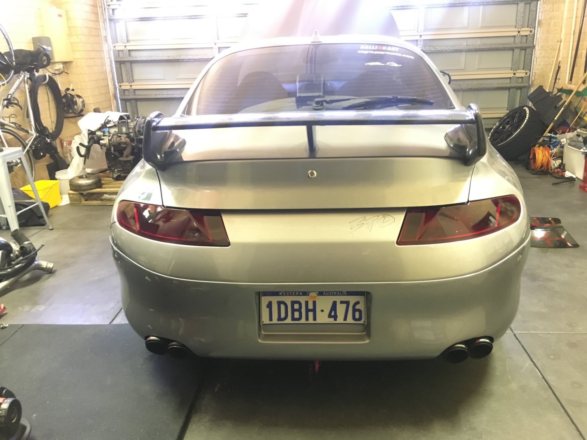

Also say bye bye to my Aventador taillights. Tried some red nite-shade, to try get a more sleek/elegant look.

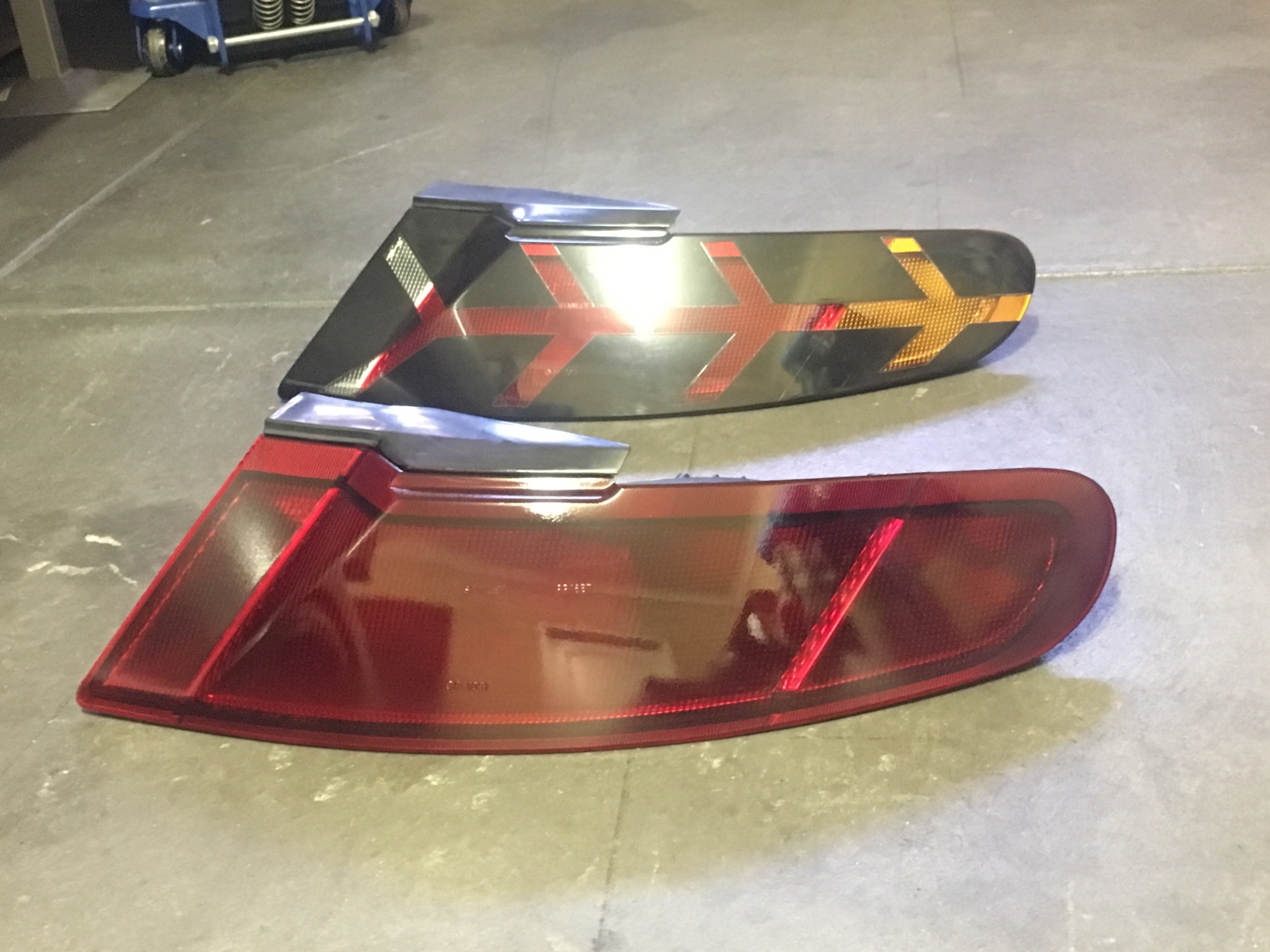

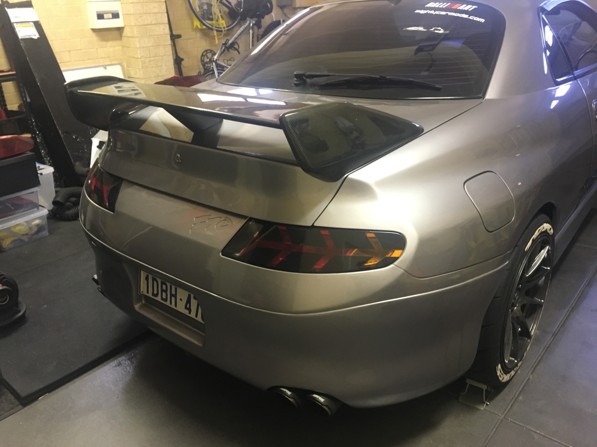

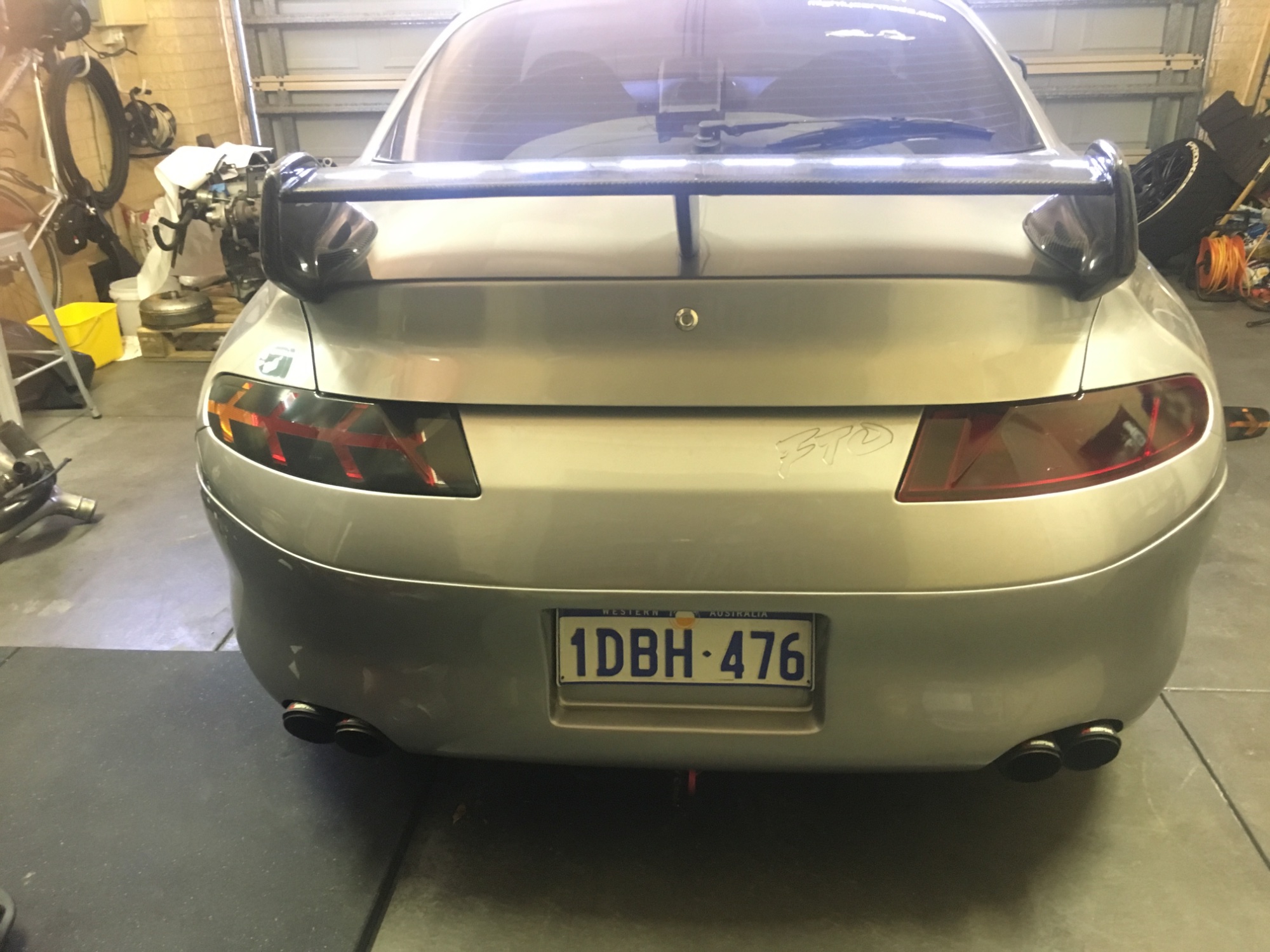

Here are the before and after pics:
Looks a lot more elegant, but I'm going to have to sort out the reverse lights, since they come up red
But otherwise, yeah looks pretty good in person, the finish with the paint is real clean and smooth
