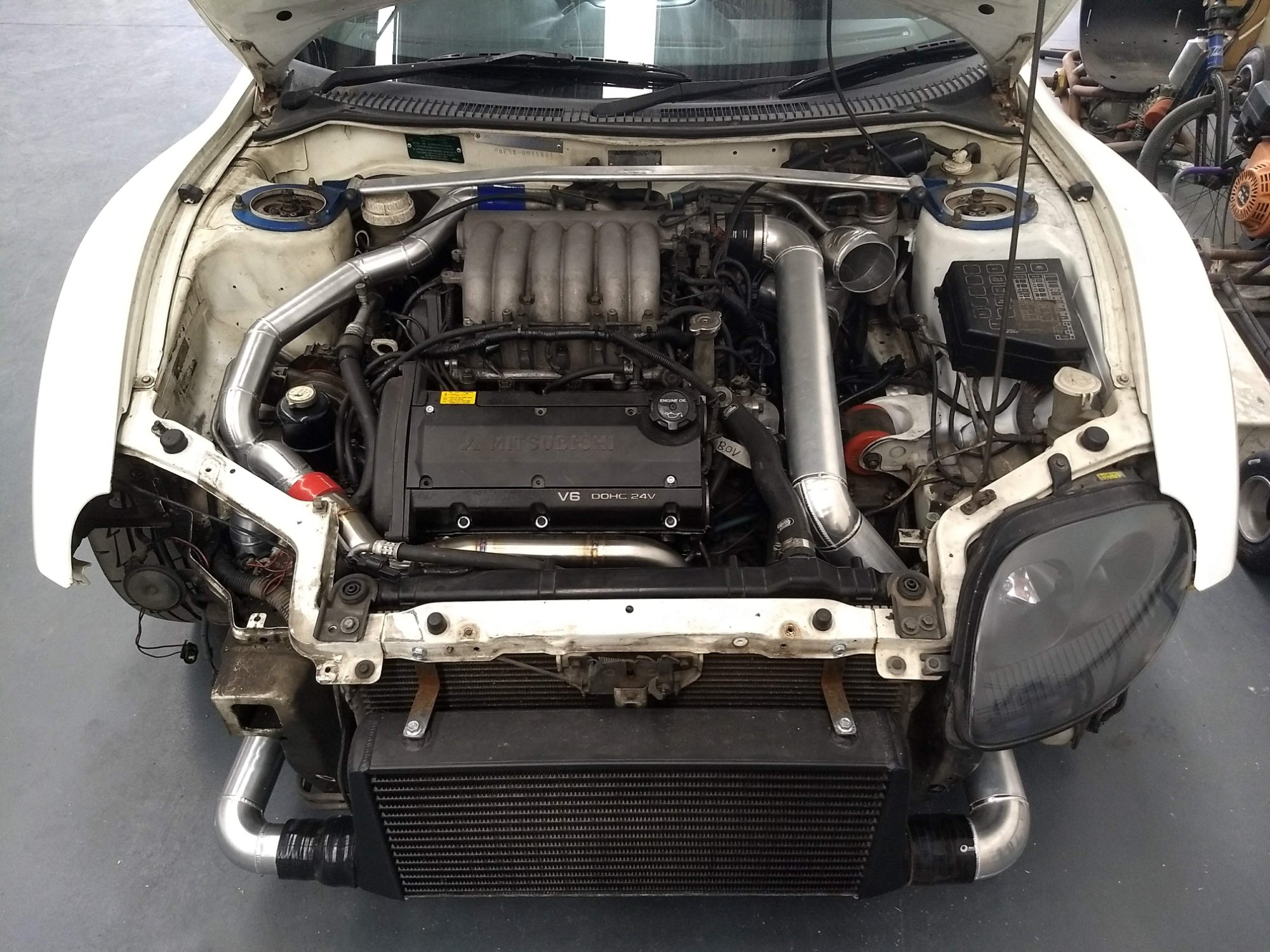

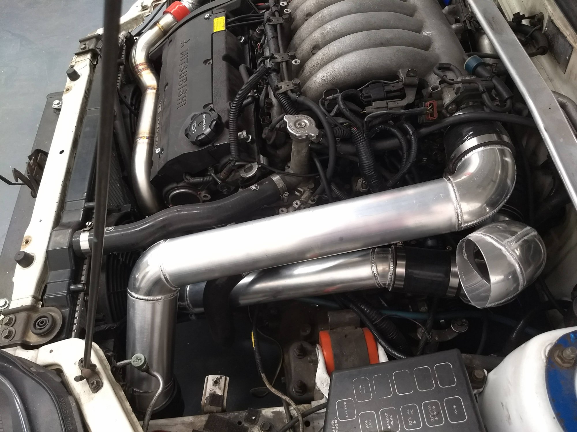

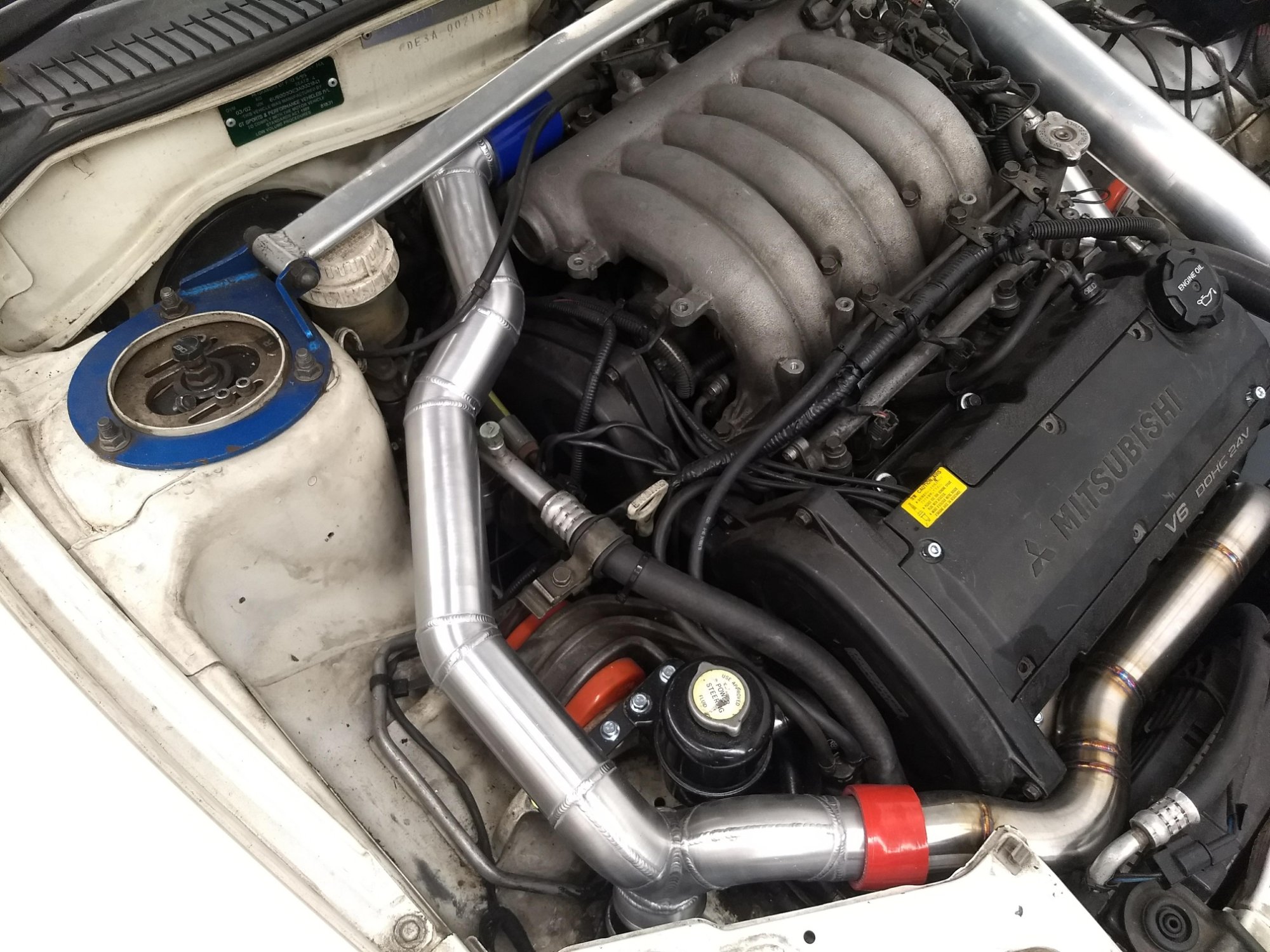

Some gradual updates. Most of the intercooler piping is complete. I think the only factory part on there is the one rubber feed hose to the rear turbo, otherwise it's all custom. The plan of using a factory or new airbox hasn't panned out due to space limitations, so instead we're just going with a shielded pod filter and putting distance between it and the MAF to hopefully avoid the turbulent air issue. Tight squeeze for a lot of stuff as anticipated, but Nathan's managed to work it out pretty well. Some trimming of the bumper required to fit the intercooler, and zero room to fit the mesh to it. Shouldn't be an issue with Dstocks bar in future.
Not much left to do!
