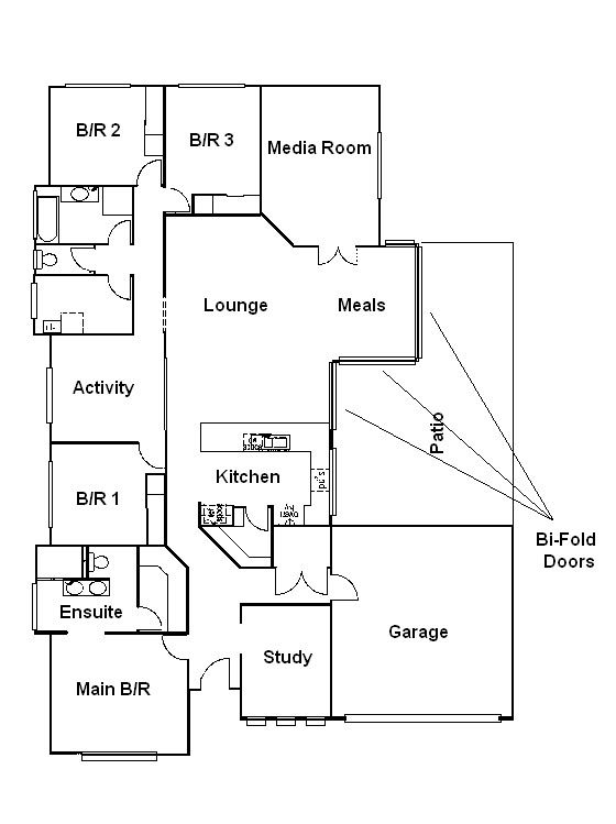

Now here is the original plans
But we have done some extensive modifications (suprise, suprise, I just cant leave anything alone lol)
and it ended up like this
We completely remodelled the ensuite and brought the kitchen back to allow a few different things. Firstly we able to make a hallway so that the entrance to the garage was not through the already small office. We converted the extra space to a linen cupboard but more importantly make a huge walk in butler pantry (well thats what metricon call it lol). We also changed all the doors and kitchen window to Bi-folds to really open the house up.
Ok now for some g33k talk. I want to wire the house up so that in the future I can add things easily. However I have no idea on what. I am going to wire roof speakers throughout the house and some HDMI cables for home thearter.
So I want to know what you guys would run if you could run what ever you wanted and what it would be used for.

f**k bro that place looks very nice. Top job on modifying it!

Run Cat 6 network cable mate. I covered my place in it, all terminating into a patch panel in the office.
Every room has at least one outlet, larger rooms more. That way you can have all your PCs talking + playstation
+ xbox + voip + wifi etc. That way you don't have to rely on dodgy wireless routers.
Then as far as sound goes, I just use little media PCs hooked up to TV's & local speakers.
The PC's can then access all the MP3s and movies stored on the server in the office.
The only place I ran speaker cabling (thick dual copper terminating at the walls) was in the lounge room.
The flatscreen is connected to the media PC and amp, the amp then goes into a switch which selects
either the outdoor or indoor (or both) speakers which are cabled to the walls via RCA connections.
