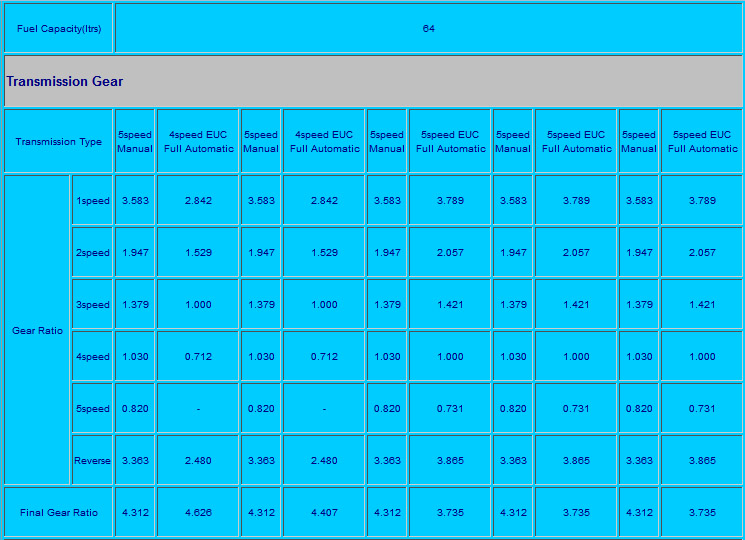

Slightly different question but does anyone know the final drive ration of the different boxes used in Mivec, non Mivec and LSD boxes?
Re: The Gearbox & Diff thread
Storm wrote:Slightly different question but does anyone know the final drive ration of the different boxes used in Mivec, non Mivec and LSD boxes?
That's all i could find, I don't see how the LSD boxes would have different gear ratios?
I don't know about the LSD boxes but it would appear that Mivec and non-Mivec cars have (probably not every one of them but mainly) different differentials, as noted by the different tripod joint sizes. there is also a conception that non-Mivec boxes are better for acceleration.
I don't think Mitsi would have put different gear ratios for every gear but it does seem like the diffs are different so I assume their final drive ratios could be different to take into account the extra few horse power that Mivec kicking in would bring.
Or not, as the case may be!
Storm wrote:there is also a conception that non-Mivec boxes are better for acceleration.
Correct, they are slightly different between Mivec and non mivec.
