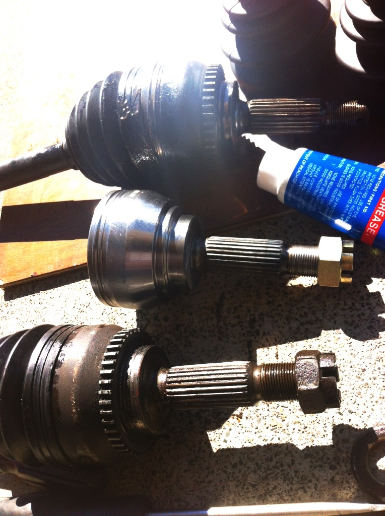

    Help, why are my new cv joints different to the old ones? The ring of teeth around the old ones, isn't on the new ones... Do I have the wrong ones?
    That's the ABS ring. They come off and go on the new one but be careful they can snap.
    Shhtuart wrote:That's the ABS ring. They come off and go on the new one but be careful they can snap.
    Ohhh
    But they are going on my other car which doesn't have abs .... So can I just put the new cv's on with no ring??
    You don't need them if your silver car doesn't have abs

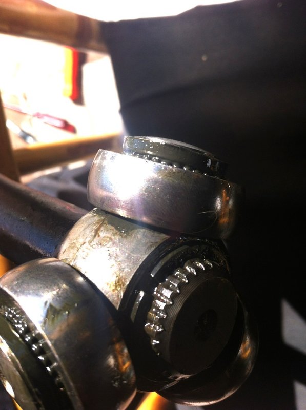

    Is it possible to remove the snap ring without the special tool required??.????
    Ive done it but it was fucked to do, get the tool lol
    Yeah, get some circlip plyers.

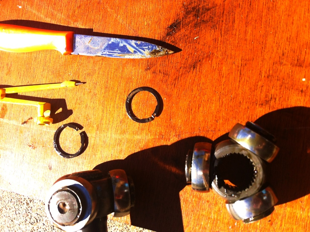

    Didn't really have time to go get them, that's why I asked, ended up using a knife and protractor haha

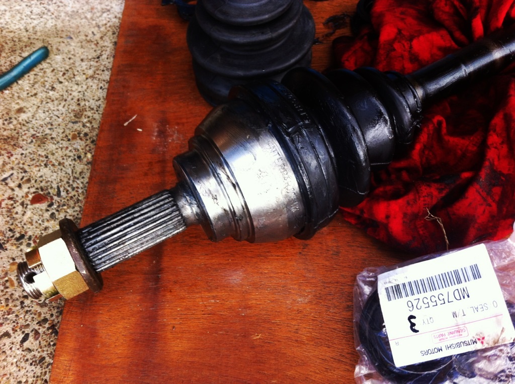

    Replaced the outer CV boots, and the new ones I've put on are shorter and have to be stretched abit to fit. Is this ok..? Noticed the old ones were longer but not as stretchy, so I'm guessing these will be fine, but just want to make sure before I tie them down??
    That's not a protractor. :facepalm2:
    That is the most random thing you could have used lol
