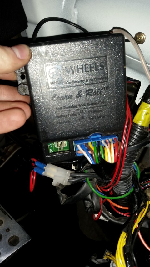

I'm not too phased by the factory headunit wiring, it's just this security system.Daniel2019 wrote:That wiring is almost as fucked up as mine was... good luck with that. I would honestly suggest an auto elec.
It hasn't worked since I bought the car and the previous owner said he never had the fob so I know it's not active but it looks like it's wired into the original loom deeply.
This is the brand.

Could be worse, mine was "HUGE-SUN-ONE" brand.. had fking T interesections of wiring, extra few inches of wires soldered to bridge gaps when original wire was cut too short, solder on solder, loose tape.. etc. etc.
Best thing to do is download the wiring diagram, have a quick study of everything that has been cut/soldered/modified and go one by one with rejoining the factory wiring to itself.
If you are installing a new system, hand that sh*t over to an auto elec.

Looks like a generic immobiliser to me. Can even see the bridge already on the ignition circuit. I call soft, get the scissors out.

It's not active but it seems pretty well wired in there. I should be able to just trace the wires and solder them back together but it's not a priority at the moment.Bennoz wrote:Looks like a generic immobiliser to me. Can even see the bridge already on the ignition circuit. I call soft, get the scissors out.

The only wire that's cut is the ignition circuit from memory. Alarms are easy.
It would be
a negative pulse trigger wire to lock and unlock circuits
Negative pulse to either light/indicator/horn circuits
Positive
Neg
Pin switches
Siren
Boot release neg pulse
Door pin switches neg pulse
Follow every wire going out from the alarm and trace the wire to where is jumped to. Rip it off repair the sheath of factory wiring, join the ignition circuit back up and done.

Just joining the two ignition wires going to the alarm does the same thing and easy!Shhtuart wrote:It's not active but it seems pretty well wired in there. I should be able to just trace the wires and solder them back together but it's not a priority at the moment.Bennoz wrote:Looks like a generic immobiliser to me. Can even see the bridge already on the ignition circuit. I call soft, get the scissors out.
