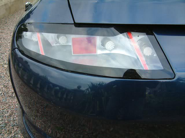

      dstocks wrote:Well the story is that as the perspex lens will be stuck to the case with some form of silicone/sikaflex, you dont want to be able to see it as it would look untidy/ugly. This will mean either putting a sticker on the inside of the outer edge of the lens so that the glue will be hidden by the sticker or using a sticker on the inside of the lens as a mask so the outside of the lens can be painted. In my case ill be wanting to carbon fibre dip just the outside edge of the underside of the lens and a sticker seems to be a logical thing to use as a mask.
      Would be happy to add this component to the cost as an optional part as I can see some people would probably have a shot at it themselves and wouldnt need the sticker.
      Precisely! That's why I had to paint a black strip on the outside of my set because it doesn't matter how clear your glue/silicone is you can see the sealant marks through the clear lens.

            Acrylic (Perspex) and polycarbonate (Lexan) are the two main choices.
            Acrylic is harder but more brittle. It is likely to crack / break if a stone hits it hard enough but because it is hard will resist scratching more than polycarbonate. Acrylic is also cheaper.
            Polycarbonate is softer and will resist cracking (you can hit the stuff with a hammer and it will just bend and snap back into shape). Polycarbonate is what the headlight outer lenses are made of. Polycarbonate by itself will easily scuff and scratch as anyone who has polished up their headlights will attest to. The trick is that the headlights out of the factory have a hard film / lamination over the polycarbonate to stop the scuffs and scratches, this provides the best of both worlds, a plastic that can take a stone chip without cracking and a surface that won't easily scuff and lose its transparency.
            As the rear lights cop much less abuse from stones than the headlights, it probably doesn't matter too much which way you go, but for the ultimate result, I would go polycarbonate and get it coated. The coating can be bought cheap off ebay / supercheap (just look for headlight films) and get a window tinter to fit them properly.
