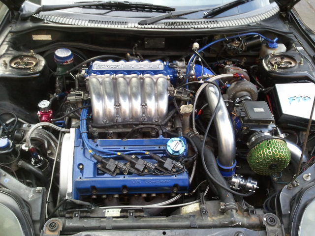

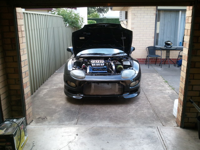

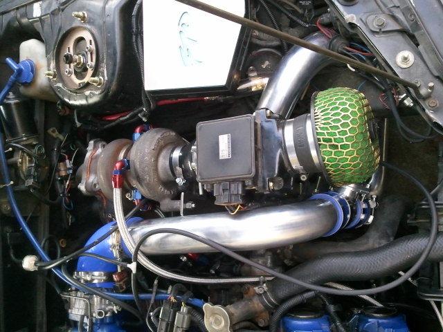

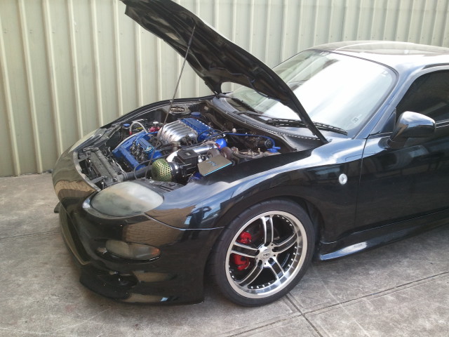

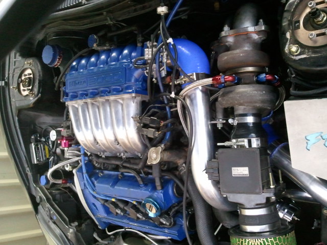

And here are some pics, still ave a bit of tidy up to do but this is pretty much it, fixed clutch line tonight and took round block still boosting bout 4k so just have to trace leak and off to tuner :D

I hate to be the perfectionist but the front mount looks crooked and off centre :S lol otherwise looking awesome!!

yeah it is has to be off centre either way and way piping goes had no choice but to be on angle strange thing is cant actually see it behind the mesh but photo seemed to make it show through

no need, strange photo shows up cooler but when looking at in person is difficult to see through mesh must be some kind of optical illusion when looking at in the flesh.
Fairly happy with result thought not bad considering everything was done at home by myself except the up/down pipes. Still gotta tidy up vac lines put coil cover back on and strut brac etc but no hurry for that more important now is to get tuned so can drive it again, kinda hard to do everything I need to on bike

That is one of the neater turbo installs I've seen on an FTO actually, looks great :thumleft:
except for the wonky intercooler :lol:
