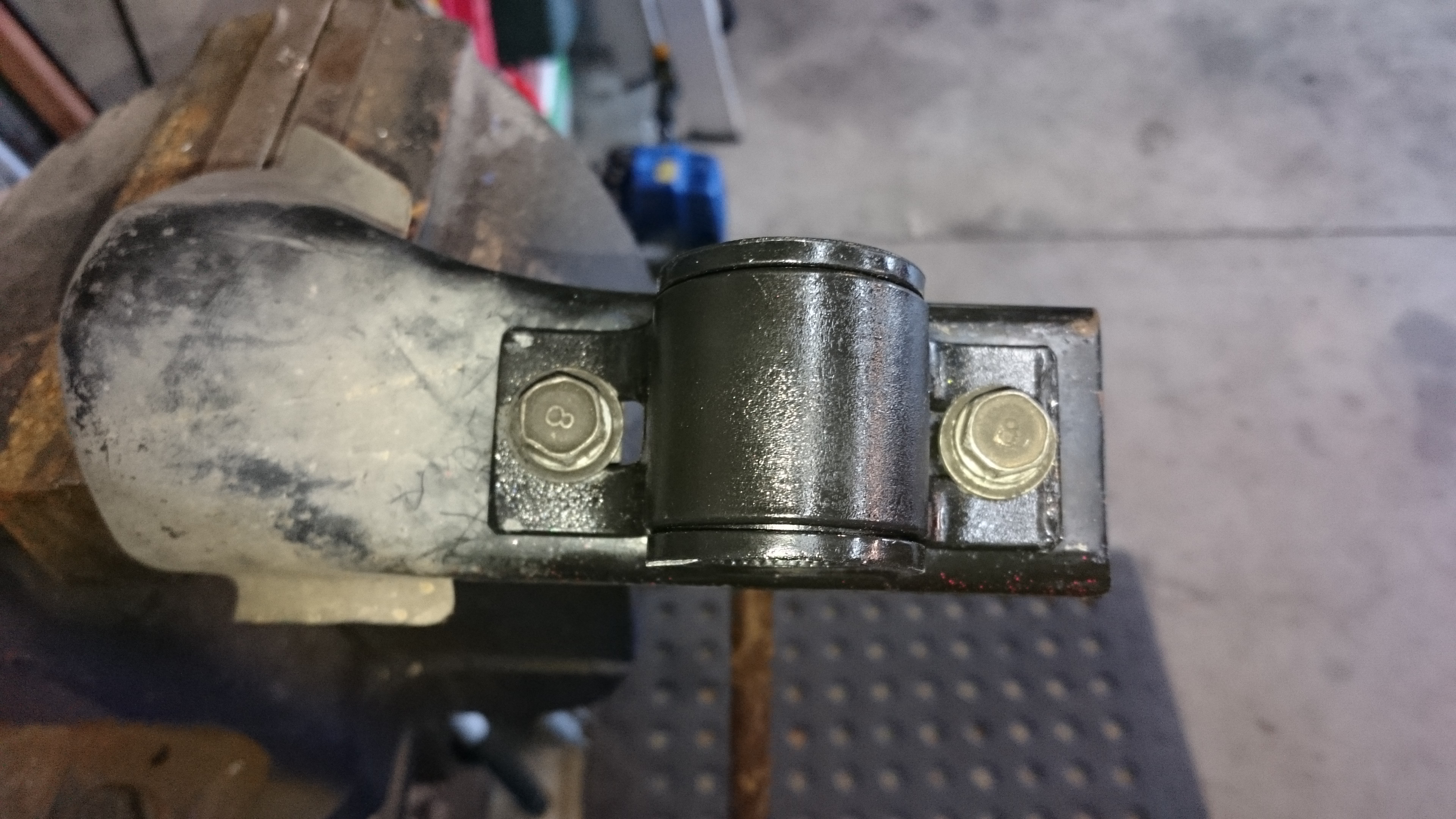

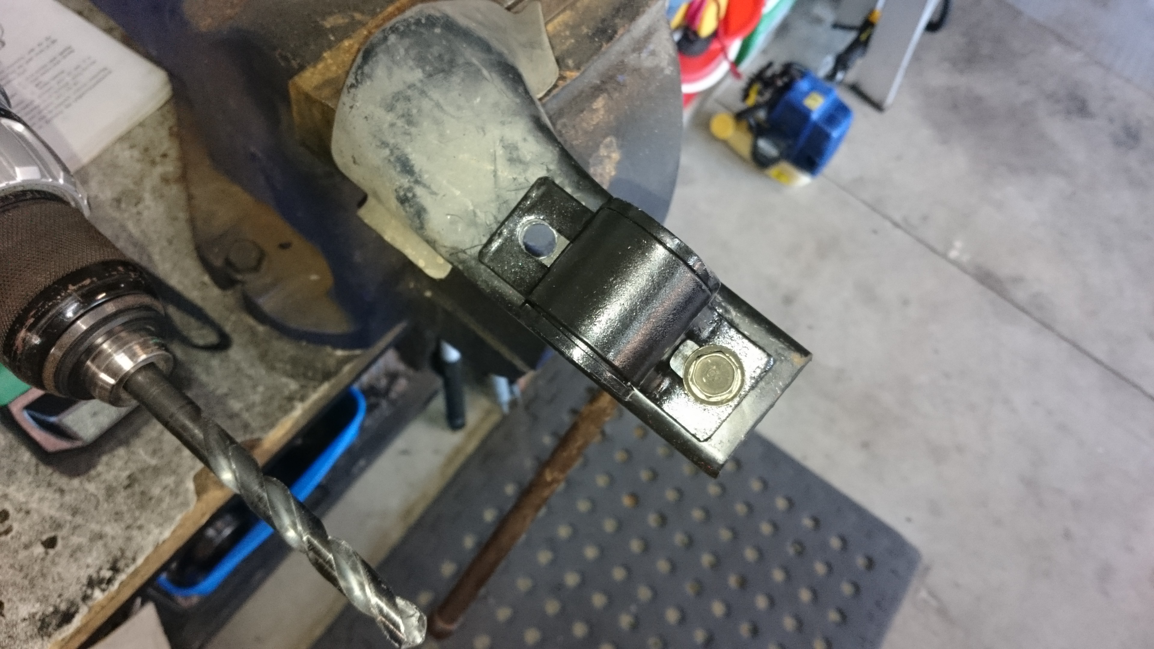

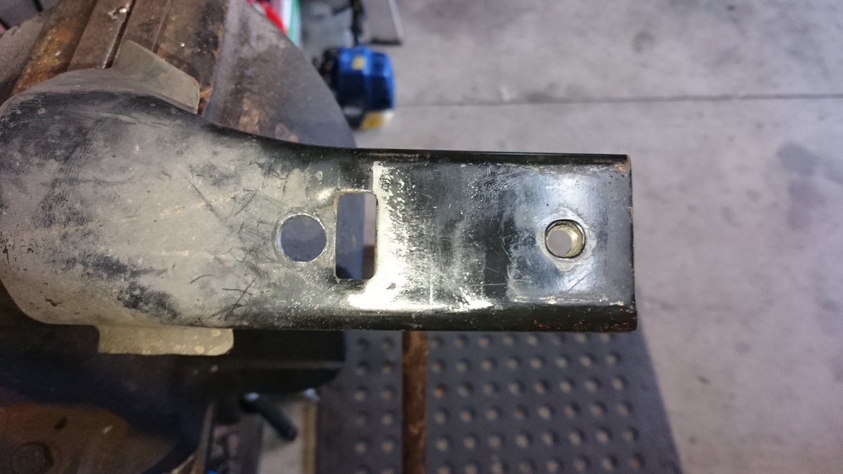

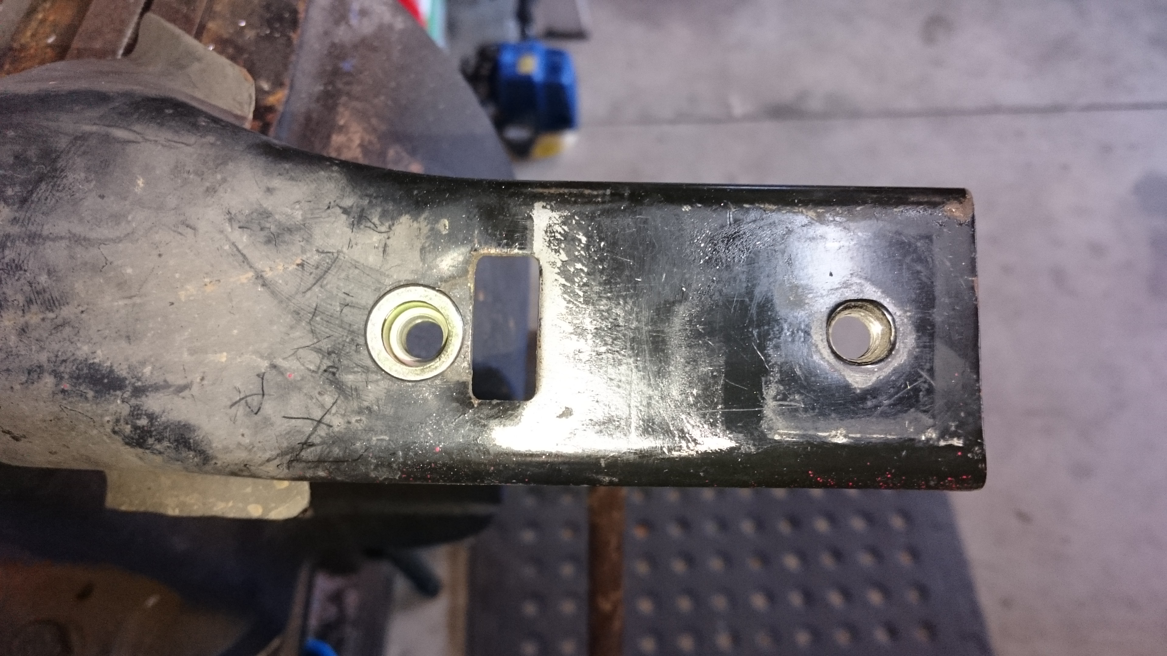

So I had to modify the connecting brackets to make this work. Nothing major, just drilled some holes & put in some nutserts. For a regular nut & bolts, an 8mm hole will suffice, for an M-8 nutsert I had to drill to 10mm.

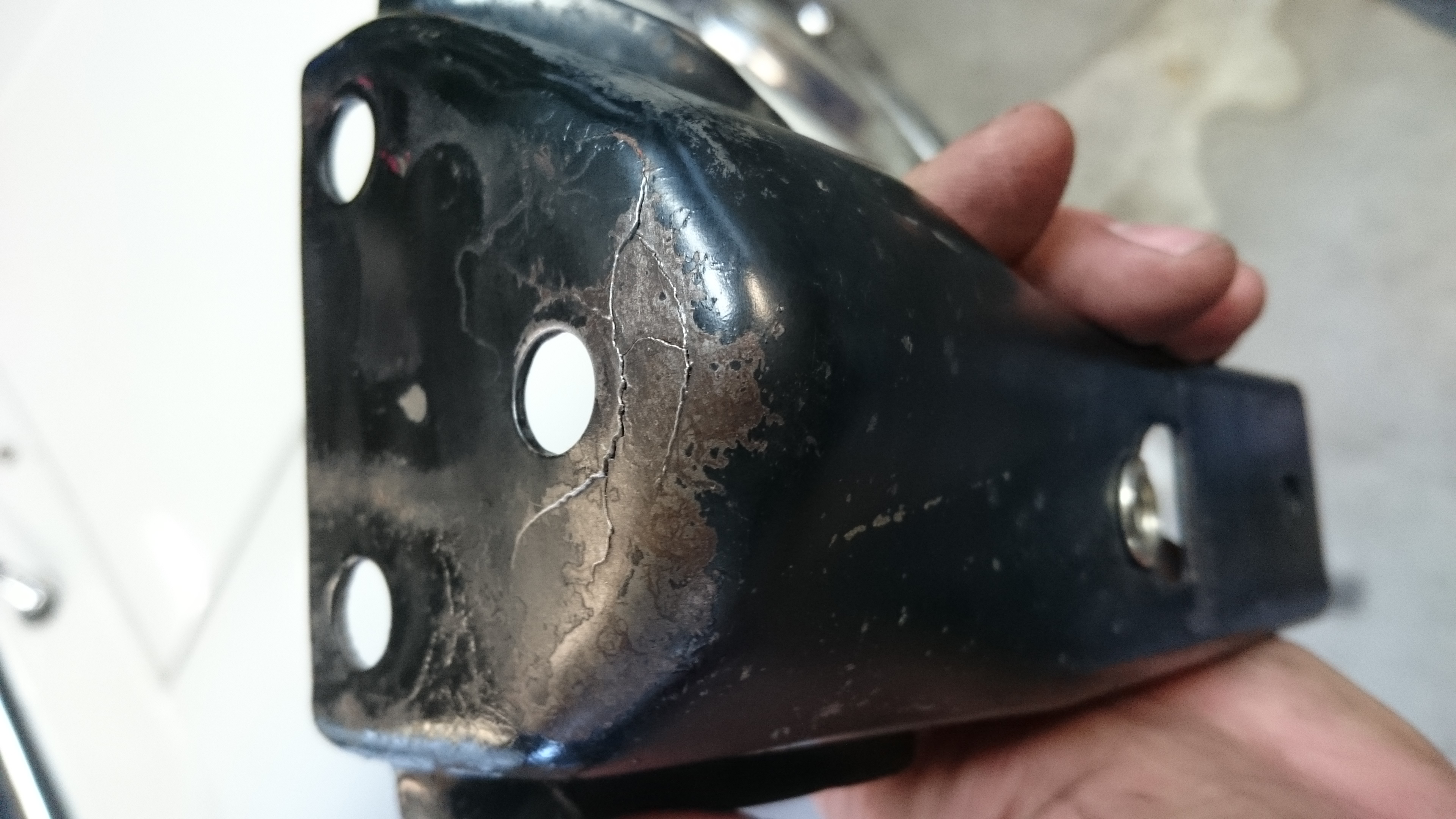

Then I found all the stress fractures in the passenger side bracket. So I checked ASA & one of the part numbers have changed on the later models, potentially being made stronger? So I've ordered 2 from Amayamamaaaaaammmaah. If they're the same, I'll just weld in some support steel to beef them up.

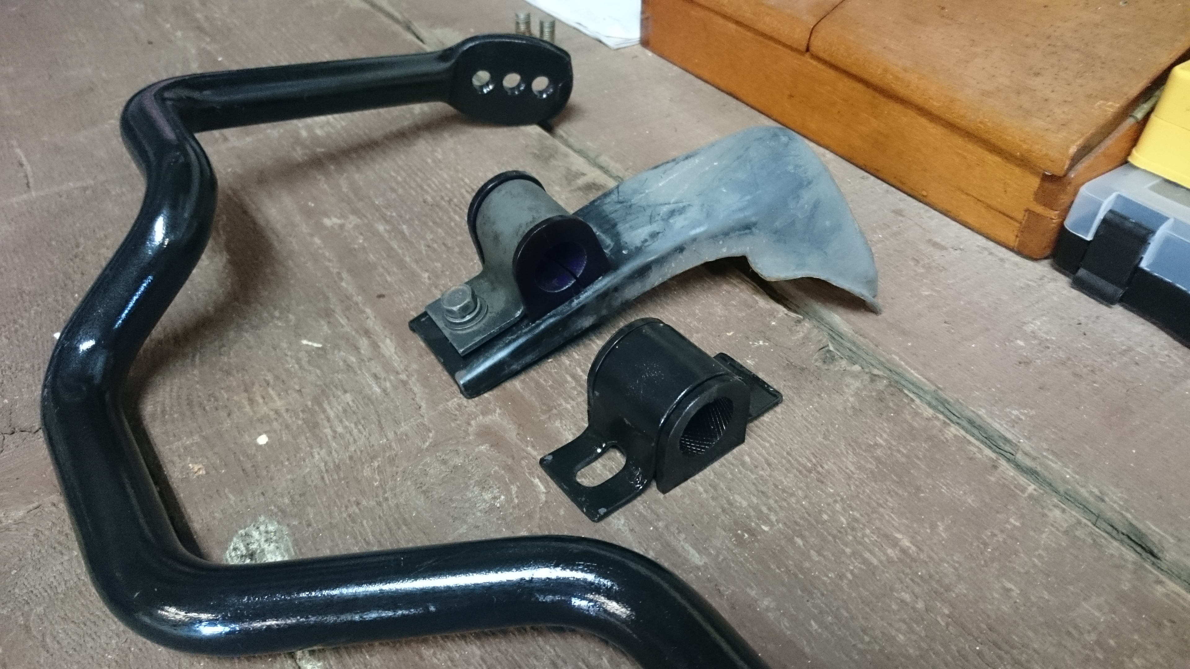

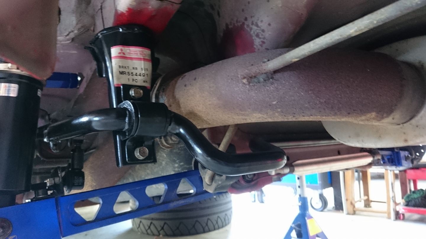

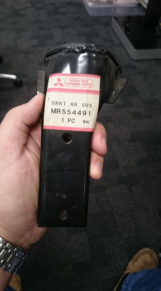

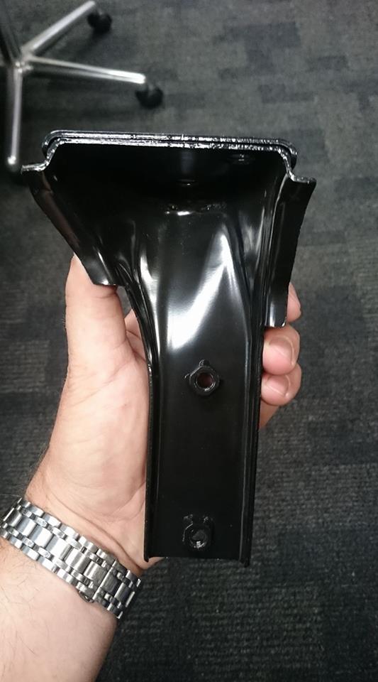

Spose I should update this. Swaybar is finally fitted. Got a new swaybar bracket from Amayama, part number MR554491 from a CH lancer.
Obviously had reported faults from the original bracket design, so it's been beefed up quite a bit, full plate welded on top.
Used hand made swaybar link brackets (aftermarket ones snapped as usual) and KLC139 Whiteline adjustable droplinks
