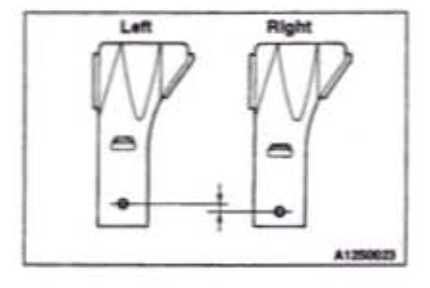

So the lower swaybar bolt hole on your left and right brackets are the same height? The hole on the left bracket is meant to be higher than the hole on the right bracket. The picture will make more sense.
Left and Right Brackets
Screen Shot 2017-02-23 at 1.56.00 am.png (78.71 KiB) Viewed 27823 times

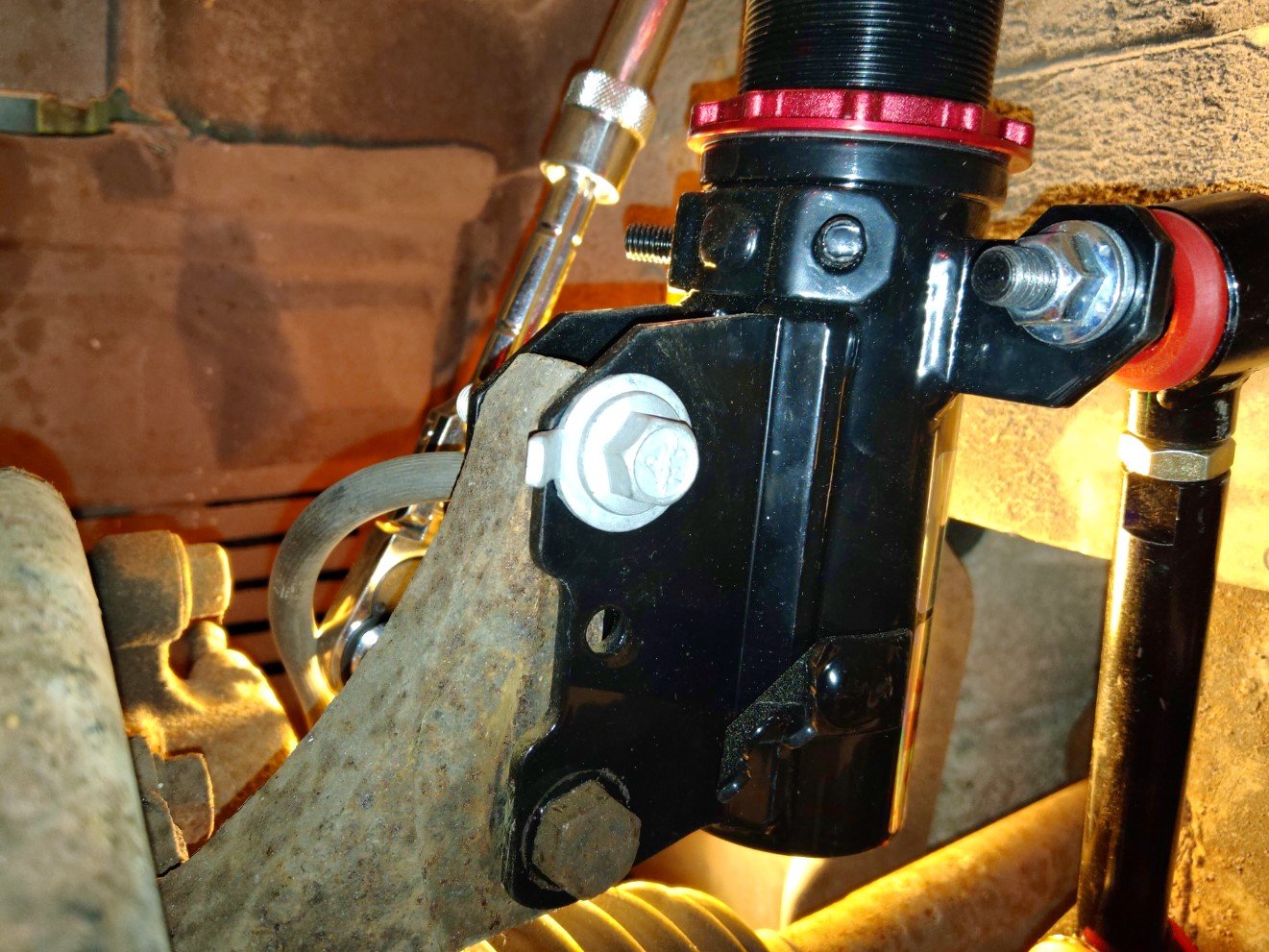

Some snips. Contact on the Passenger side picture is a little hard to discern, but on the front driver side, it's pretty clear.
Front RH clearance:
Suspension_2020-11-15_RH Front tire to suspension clearance on stock fasteners.JPG
Suspension_2020-11-15_RH Front tire to suspension clearance on stock fasteners.JPG (161.74 KiB) Viewed 23520 times
Front LH clearance:
Suspension_2020-11-15_LH Front tire to suspension clearance on stock fasteners.JPG
Suspension_2020-11-15_LH Front tire to suspension clearance on stock fasteners.JPG (158.26 KiB) Viewed 23520 times
I had to buy camber bolts... which I installed ONLY on the LH side and not the right --- just so I could move the damn car. Very strange.
With camber bolts installed on just one side and not the other, both sides now look more even from a camber perspective. Which worries me.

But, I just realized I never reported back on this old thread. No idea what happened and why I had that strange rubbing issue, just on the passenger side and not driver. I ended up putting camber bolts on both sides, just to be even. Strangest thing. Fixed the issue either way.
I've just never had to put camber adjustment before on top and bottom. Kinda ridiculous.
I mean, top mount studs had to be torqued down all the way to the most negative setting so... kinda pointless to call them "camber adjustment plates".
2021-11-16_Front Strut Camber bolts.jpg (273 KiB) Viewed 21540 times

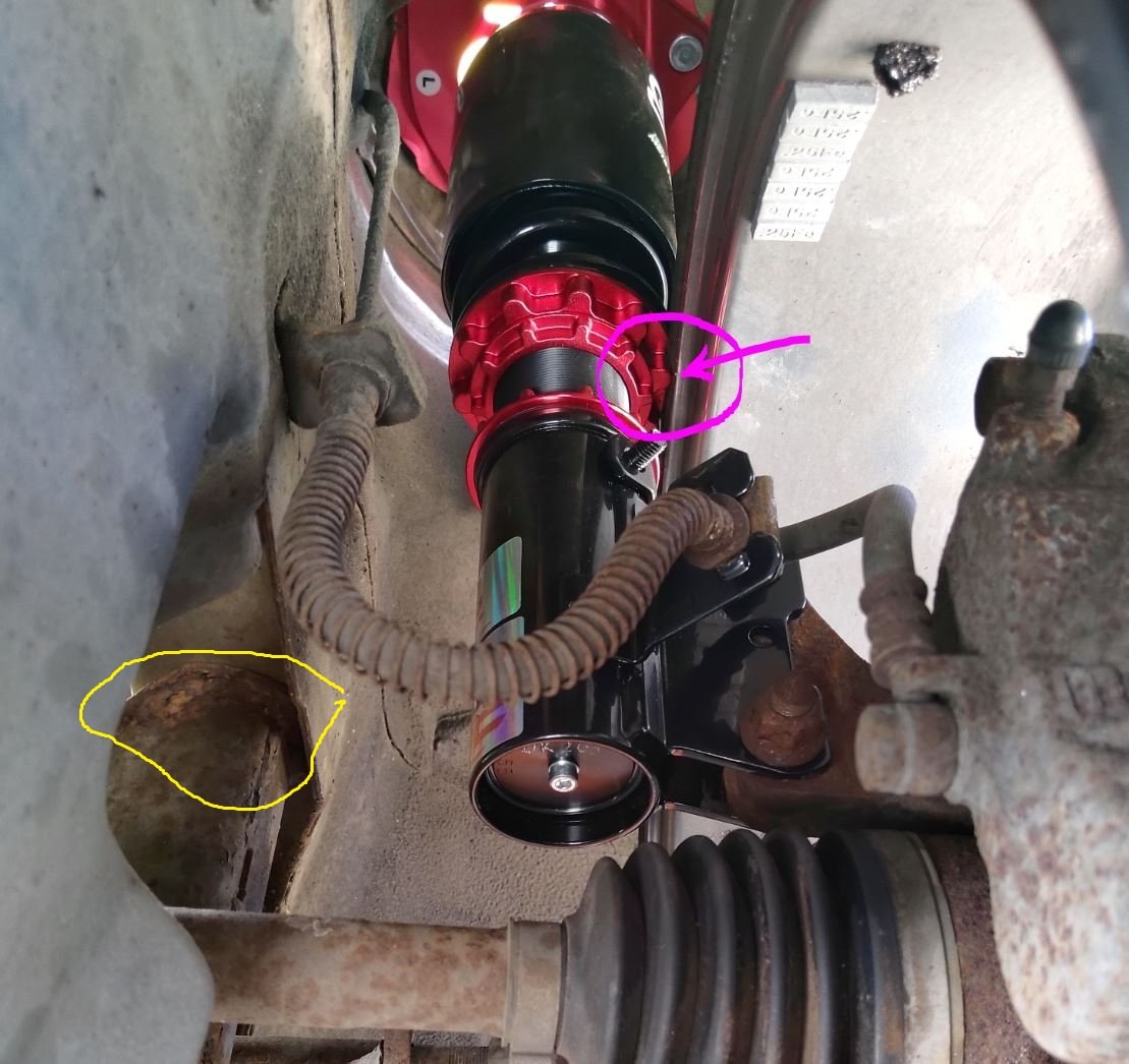

Your biggest mistake was fitting coilovers before addressing all the bushes etc.
May want to look at the rust i circled in your pic too.
I would never buy an FTO from the UK.
Suspension_2020-11-15_LH Front tire to suspension clearance on stock fasteners.JPG (161.37 KiB) Viewed 21523 times
