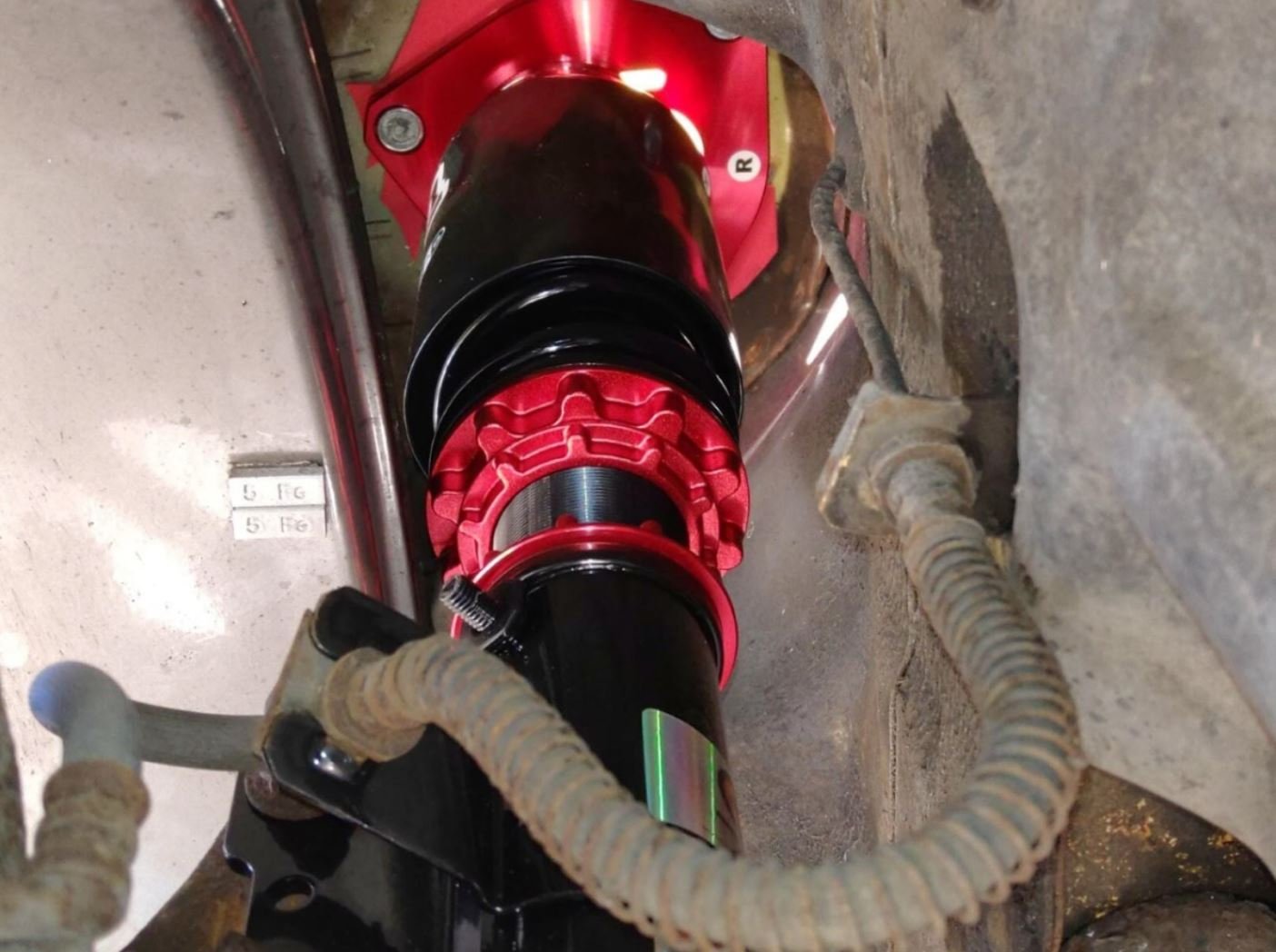

Is there a reason why the passenger front wheel might have unusually more negative camber than the driver side wheel? Could it be a bad joint, bushing perhaps? Anyone have a similar experience?
I noticed this right after installing coilovers --- nothing else. Stock everything else, with both top-mount camber plates at the same "0" setting". Then I noticed that while the driver side tire had about 4-5mm of clearance from the spring/shock body, the passenger side had 100% contact!!!
I didn't hear any clunking noises, and so now I'm wondering if it's the inner LCA bushings that maybe gave out. Always hard seeing if that's a problem without taking the whole arm off. (And, not something I really wanted to do).
Re: The Suspension Thread
Posted: Wed Nov 18, 2020 4:24 am
by slippercream
Some snips. Contact on the Passenger side picture is a little hard to discern, but on the front driver side, it's pretty clear.
Front RH clearance:
Suspension_2020-11-15_RH Front tire to suspension clearance on stock fasteners.JPG
Suspension_2020-11-15_RH Front tire to suspension clearance on stock fasteners.JPG (161.74 KiB) Viewed 23521 times
Front LH clearance:
Suspension_2020-11-15_LH Front tire to suspension clearance on stock fasteners.JPG
Suspension_2020-11-15_LH Front tire to suspension clearance on stock fasteners.JPG (158.26 KiB) Viewed 23521 times
I had to buy camber bolts... which I installed ONLY on the LH side and not the right --- just so I could move the damn car. Very strange.
With camber bolts installed on just one side and not the other, both sides now look more even from a camber perspective. Which worries me.

But, I just realized I never reported back on this old thread. No idea what happened and why I had that strange rubbing issue, just on the passenger side and not driver. I ended up putting camber bolts on both sides, just to be even. Strangest thing. Fixed the issue either way.
I've just never had to put camber adjustment before on top and bottom. Kinda ridiculous.
I mean, top mount studs had to be torqued down all the way to the most negative setting so... kinda pointless to call them "camber adjustment plates".

Your biggest mistake was fitting coilovers before addressing all the bushes etc.
May want to look at the rust i circled in your pic too.
