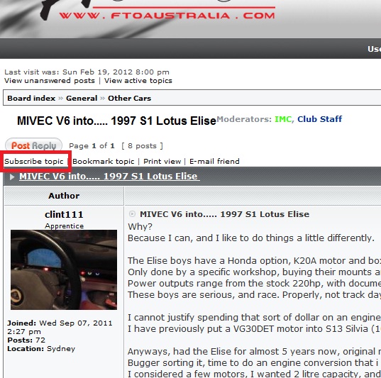

Interesting. Ben, we need a subscribe thread button !
Re: MIVEC V6 into..... 1997 S1 Lotus Elise
Kustom wrote:Ben, we need a subscribe thread button !
Dumbass..
Well la-de-fuckn the I didn't see it :P
