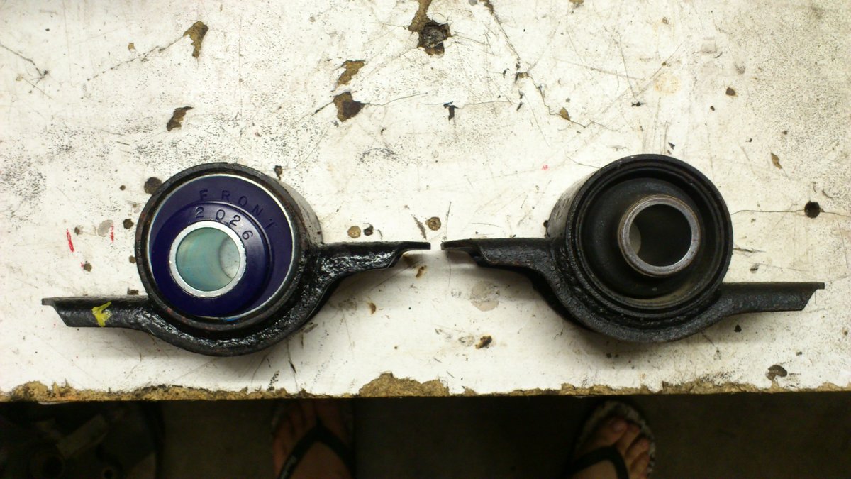

The only difference in the arms apart from the droplink mount being welded on, is the tubular section where the rear bush goes on is threaded, so the bush is locked on with a nut.
It wasn't just the vR that got the different rear bushes, pretty sure all face lifts did.

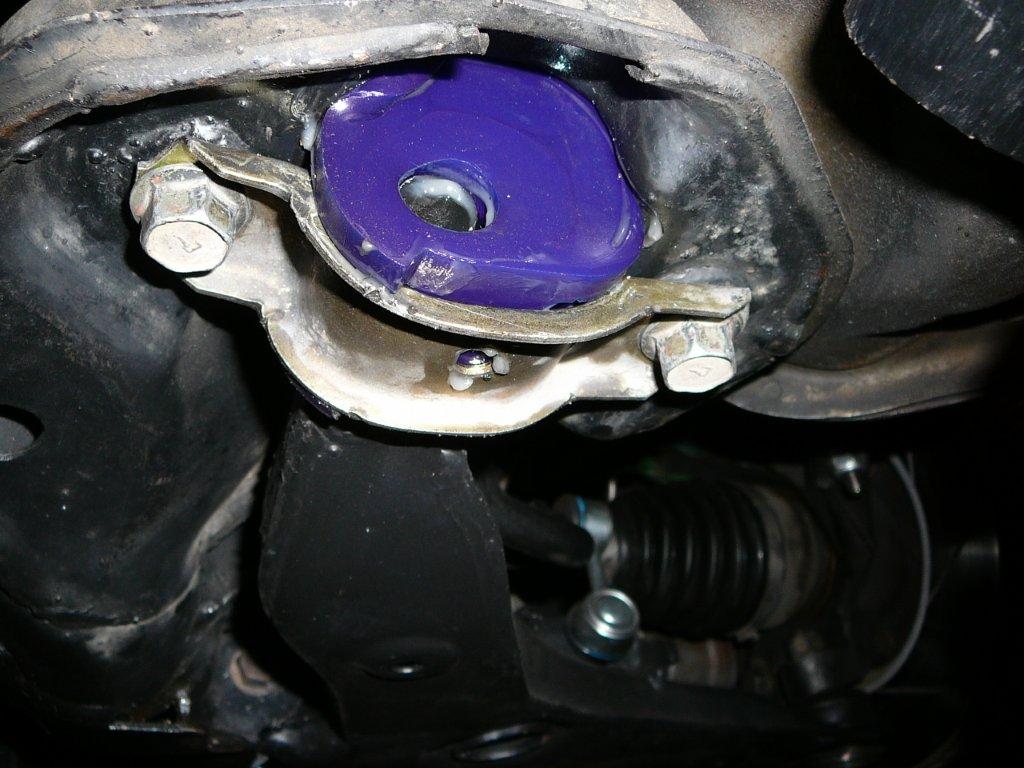

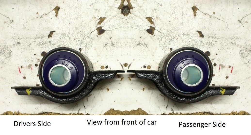

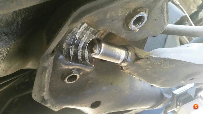

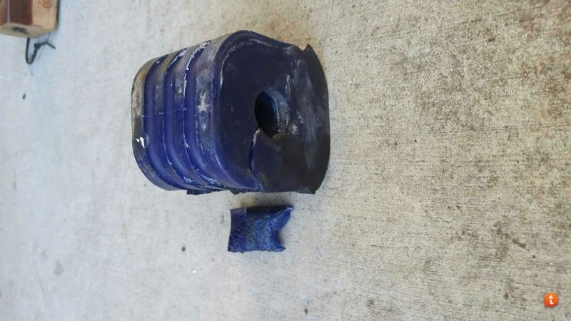

The threaded end helps lock the bush in place so there's less lateral load as well as torsional. I've seen some of those old school block bushes get really fucked up & even twist around in their seat.
This was Shanes race car, fully twisted around 90 degrees - as you can see, that's no good for a bush with an offset hole lol

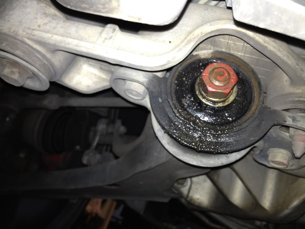

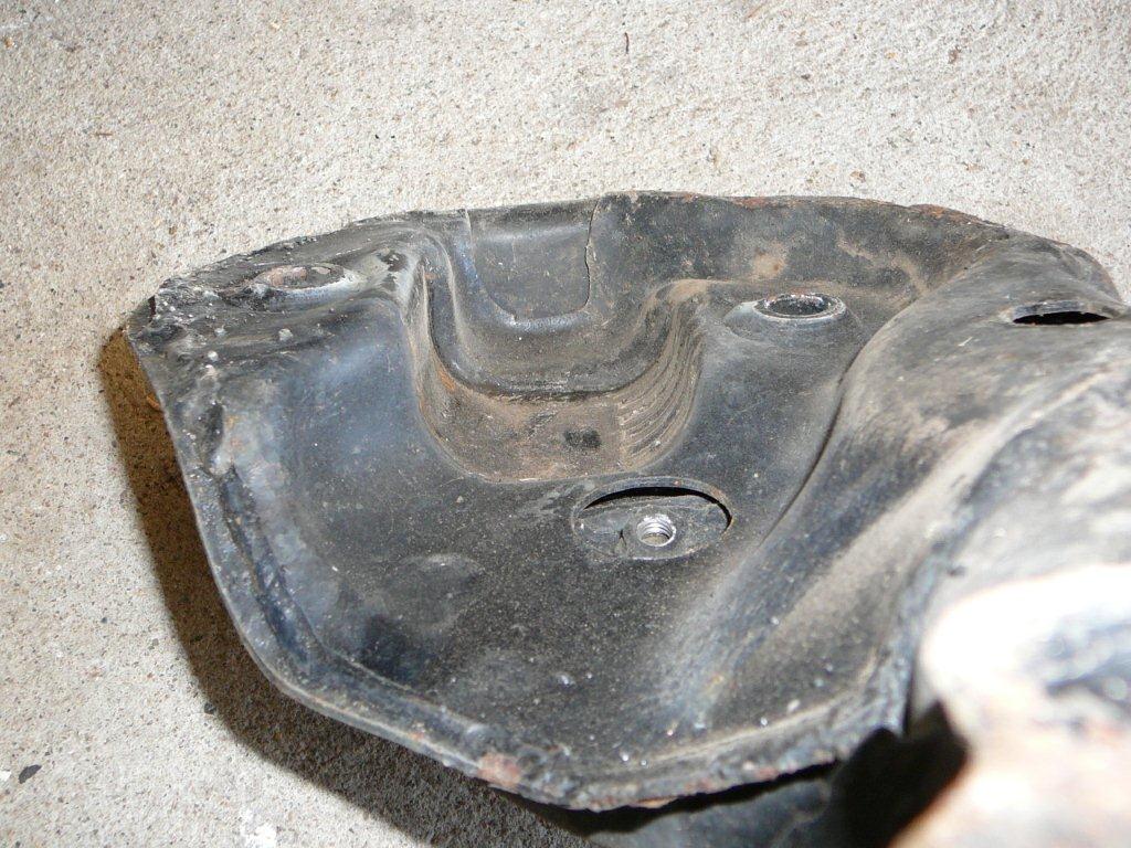

This one came out of ZFL45H1's car..
And here's the facelifted variant. Also used on Evos & Magnas

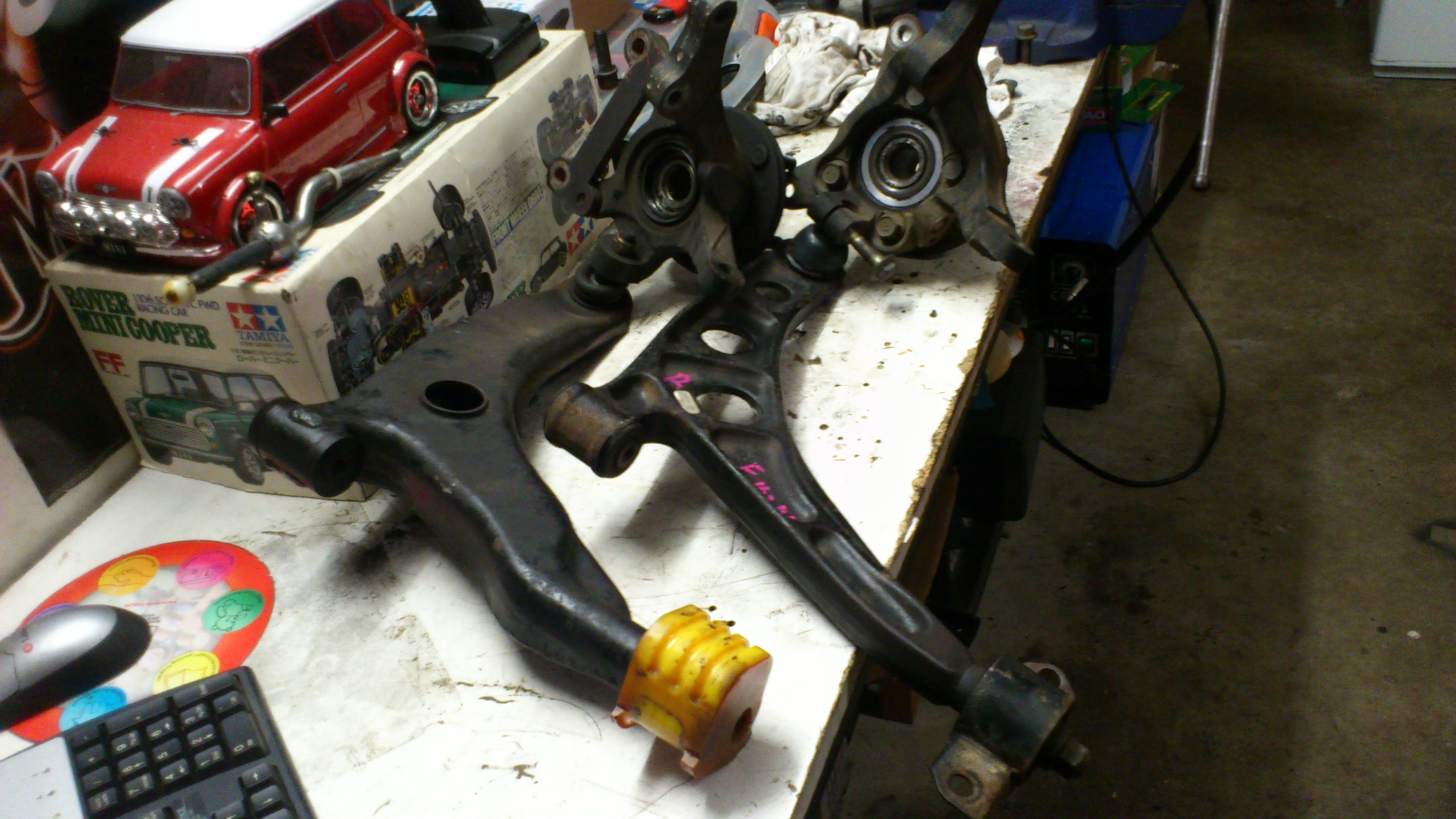

Then there's always the step up to the Evo arms. Some minor differences between the early models (III, IV, V) but essentially the same as facelifted FTO, but made from cast material, rather than pressed steep, adding more torsional rigidity. Earlier ones tended to be cast iron, while the latter tended alloy to reduce weight.
Comparison between pre facelift FTO & Evo III arms

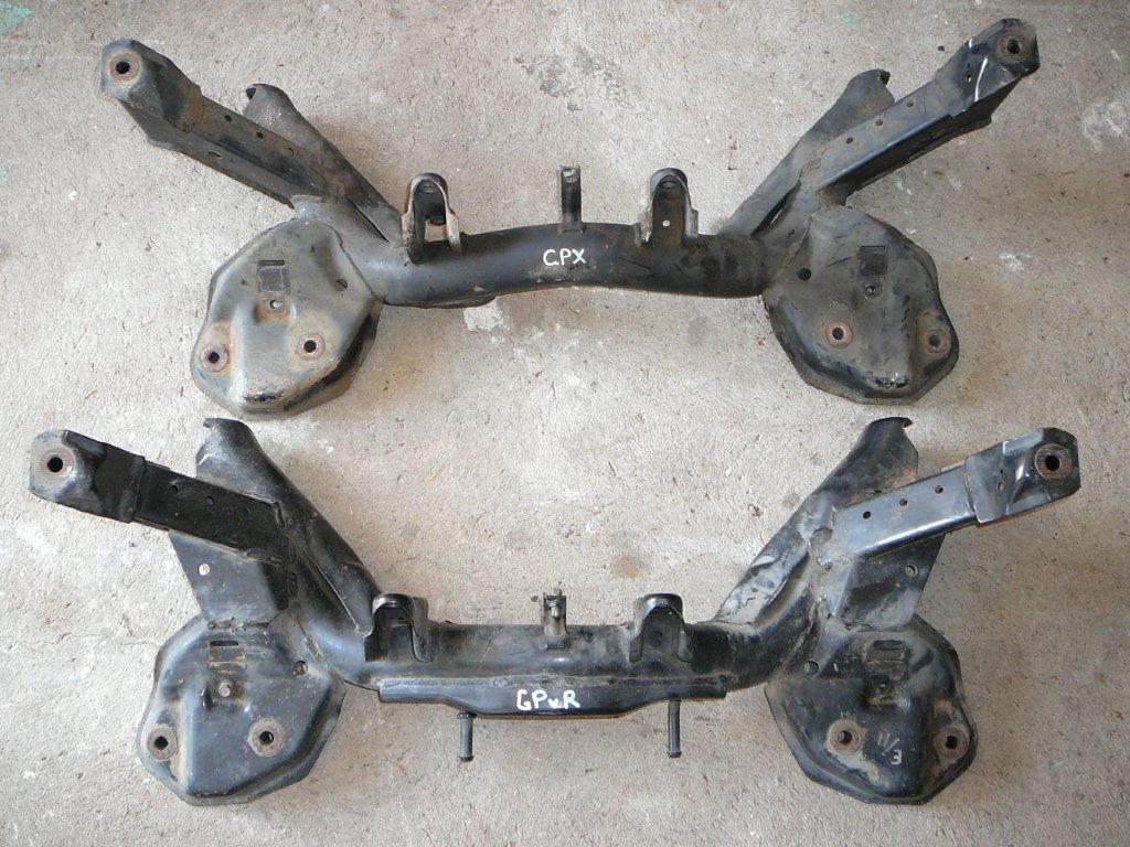

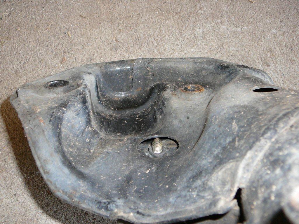

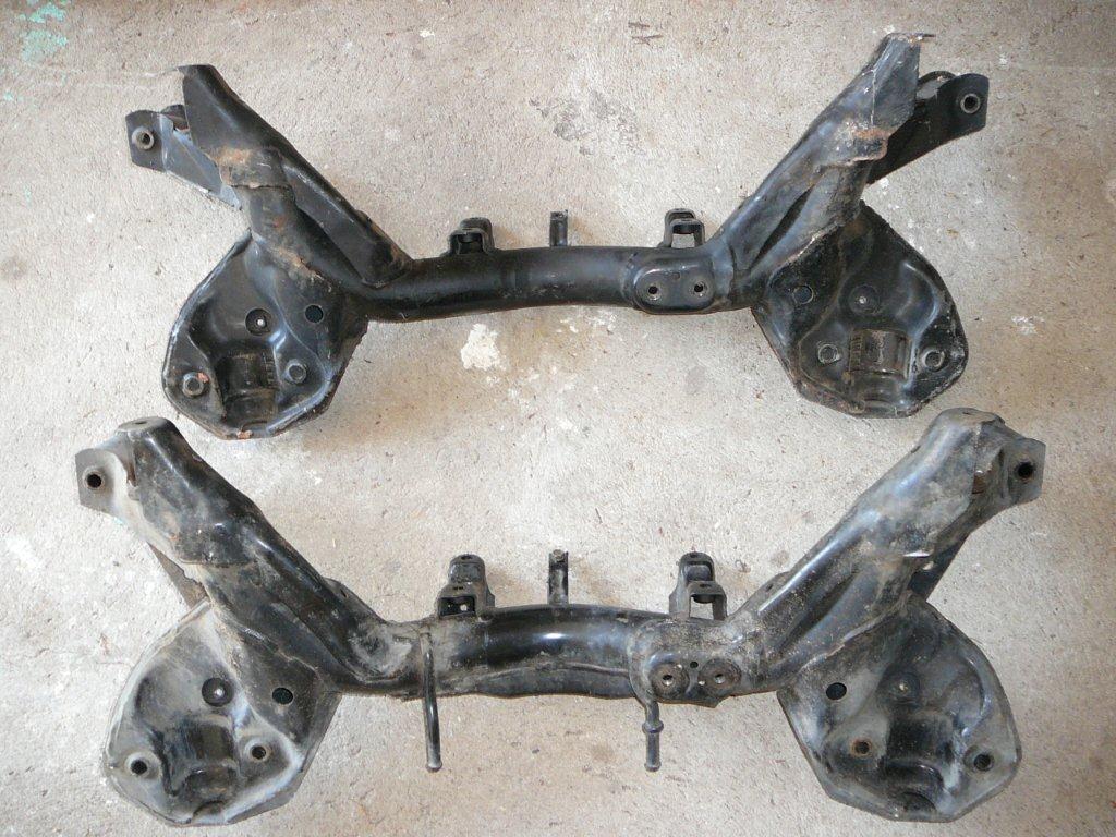

And here's some pics of vR vs GPX subframe to see the extra bracing they have.

Hey Pres, any idea what those two little pegs on the Version R subframe are for?
Re: GPvR LCA Compared to GPX
Exhaust hanger rubbers
Bennoz wrote:Exhaust hanger rubbers
Ahh. Interesting. The more ya know.

That was a sad day when that happened lol but I'm glad it was only that. FYI that was from massive laterial load [SMILING FACE WITH OPEN MOUTH AND COLD SWEAT]

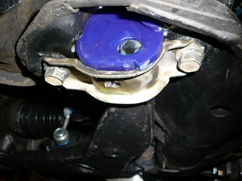

Using offset is purely at your preference. If you have the hole at the bottom of the bush, you'll get max positive castor, put it facing the outside of the car, you get max neg camber, somewhere in the middle you get a bit of both. That's how I set mine up.
Evo bushes.jpg (205.06 KiB) Viewed 6329 times
Facelifted bushes will fit a non facelift subframe, the mounting points are universal.
