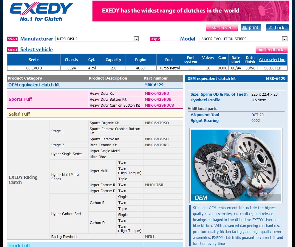

There's a whole bunch of cool clutches to pick from. You can use anything from the Evo III range.clint111 wrote:Cam gear sorted, thanks to Taz.
And I have to check price and availability of the other clutch anyways.. 5 puck unit.
I used the Evo III HD when I did the 6A13 conversion. Its all the same 225mm units.
viewtopic.php?p=173602#p173602
http://clutchfinder.exedy.com.au/
![Image](http://img367.imageshack.us/img367/7554/dsc01172800x600pg2.jpg)

Re: MIVEC V6 into..... 1997 S1 Lotus Elise
That's the one I have now.
My mates at Works Engineering do a clutch, 5 paddle type, Pro400 series for the sprung disc or Pro500 for solid.
The 500 would be good for pure track car, so I gonna price the 400 series.
