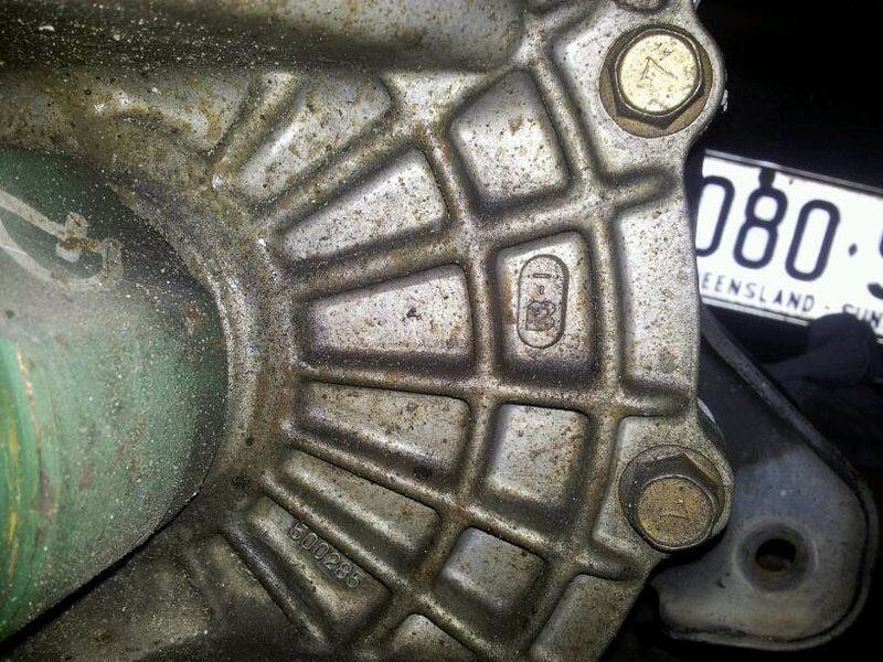

okay so i found another number
500285 it is on the diff part of the gearbox,
and as for an lsd or not when spinning the cv uni end the opposite cv spins in the same direction which indicates a lsd,
i checked with a friend ofmine who is a great mechanic and even he agreed that it would be a lsd.
unless there was a locker which we both highly doubt.
so with that in mind and the fact the i read somewhere the my model comes with a lsd i believe that it is in fact a lsd.
so does anyone need any more information?

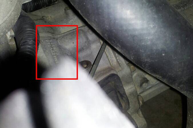

Re: Fto gpx manual gearbox
The number is located right next to the clutch fork. There is usually a bit of dirt on it so might be difficult to see.
- Connor_1994
- Posts: 686
The only one i could see there was the one on the rubber seal :/

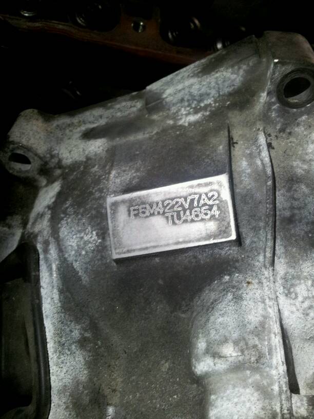

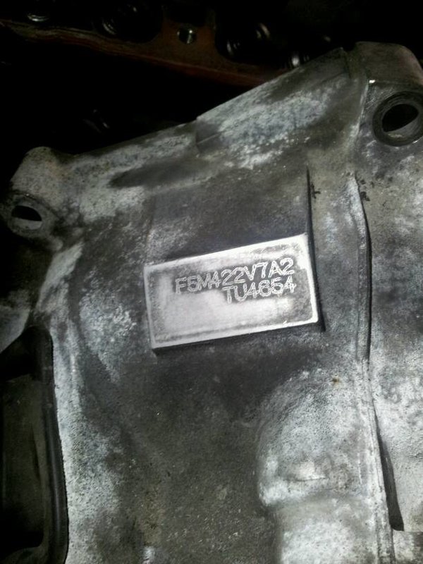

- Posts: 3952
Sorry for the crappy photo, its the best I could get with the hoses in the way. But that's where it is located.
Nice Helical you have there Vectose
As per the picture connor, its hard to miss once you know where it is. its facing up so you can read it from above the geartbox, and is on a small flat surface - cant miss it
Very interested to see if it is or not
You have a Viscous LSD
