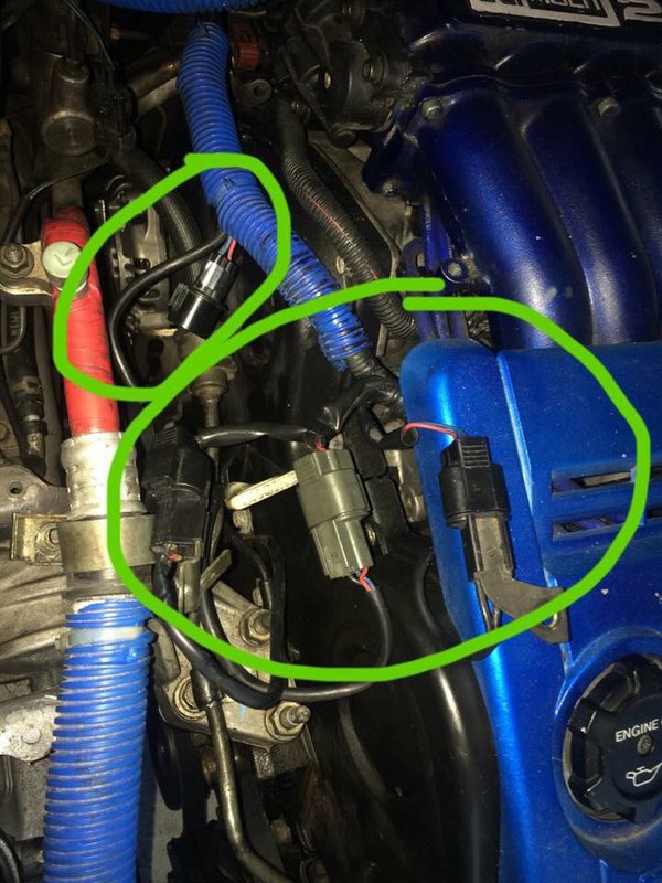

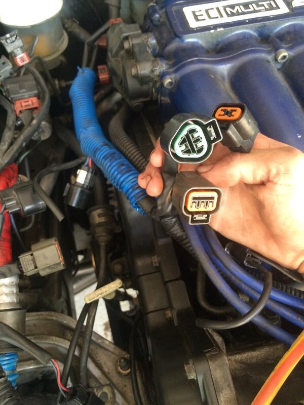

These three are plugged in

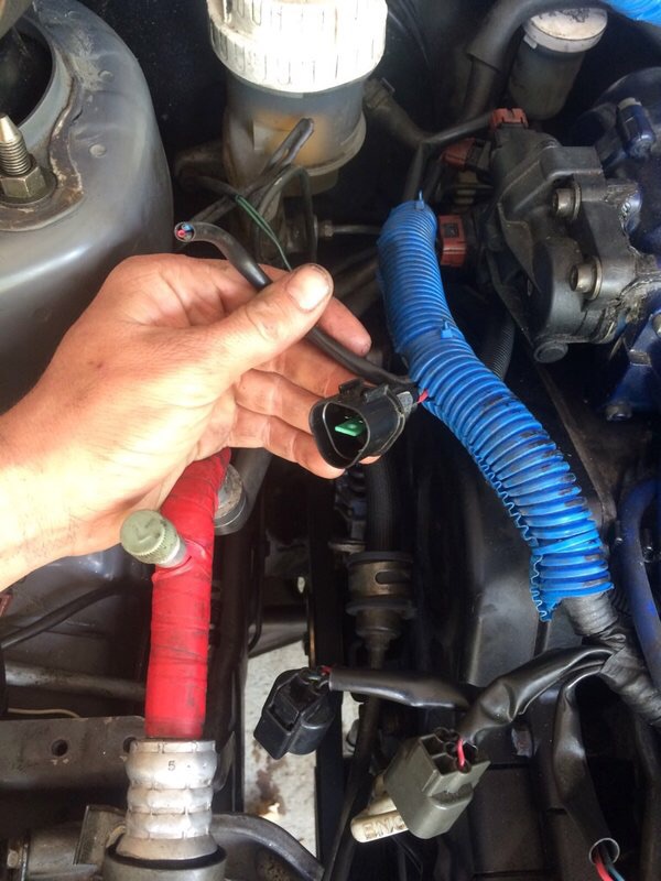

This one isn't , there's no where on the new engine for it to go.
Re: Neeeeed Help !!!!
Does anyone know, what the plug is ??

destinationtoby wrote:Does anyone know, what the plug is ??
That looks like the crank angle senor plug.
^ What he said, those would be the crank and cam angle sensor plugs coming from the sensors themselves and are not wired to the loom, they go straight down to the sensors. And the ones at the bottom of the photo are the ones coming from the loom.

Actually looking at that loom... I'm confused
Yeah that should have a grey plug for the cam angle sensor... Where's your cam angle sensor wire?

Vectose wrote:^ What he said, those would be the crank and cam angle sensor plugs coming from the sensors themselves and are not wired to the loom, they go straight down to the sensors. And the ones at the bottom of the photo are the ones coming from the loom.
They're all wired to the loom
The first three plug into plugs that are coming straight from the engine. But there's nothing for the other one down further.

That other one that isn't connected in the photo is not supposed to be there.
That extra plug you are holding is suppose to come from the crank angle sensor and plugs into the other triangle plug with the green seal coming from your loom.
The extra plug looks like it comes from your loom though?
Maybe you need to get rid of that silly blue conduit so you can follow the wire.
I bet one end has the extra plug and the other end has the cut wires, in which case...pull it out and throw it to hell and smack yourself on the back of your head!!!
