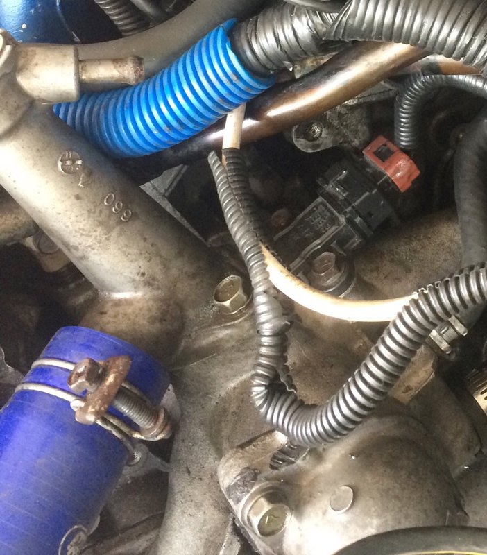

And is this Where the ifs is supposed to be?
Re: Neeeeed Help !!!!
I think that's it.
Is it the same plug as the TPS

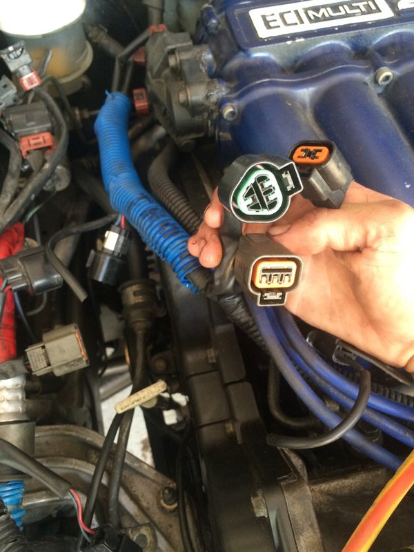

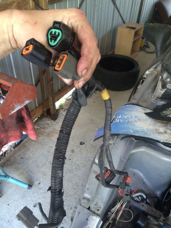

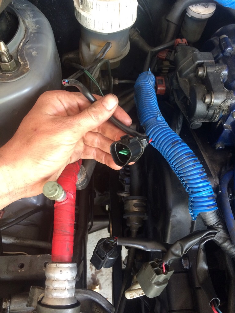

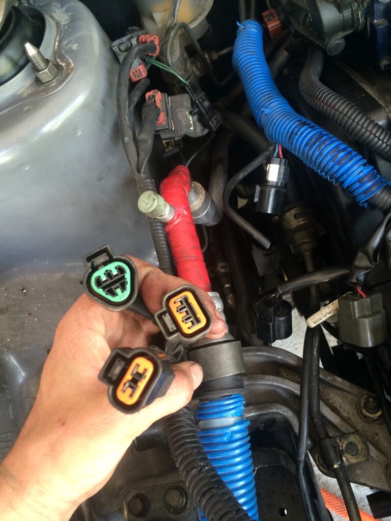

This is a piece of wiring loom that came attached to the new engine.
This is my loom and it has the same 3 plugs plus an extra one and some cut wires that the other loom doesn't have at all. I cant find anything that plugs into it, or any wires that join on.. Does anyone know what it is or why one had it and one didn't...

You have 2 sections of loom the same because on 2nd hand motors, they don't bother stripping that bit out, because it requires the intake manifold to come off.
That bit of loom & those 3 plugs are the crank angle, cam angle & left mivec solenoid plugs, also has air control valve & alternator further along. It's easiest to remove the loom still attached to the car that matches that, then connect the one attached to the engine, where you disconnect your old loom. Otherwise you gotta pull the intake manifold off to strip off out the one attached to the motor.

In the last photo u can see it only has the 3 plugs that I'm holding and the 3 at the other end.
The second photo it has the same 6 plugs plus two more that I'm holding, which are non existent on the old loom,
